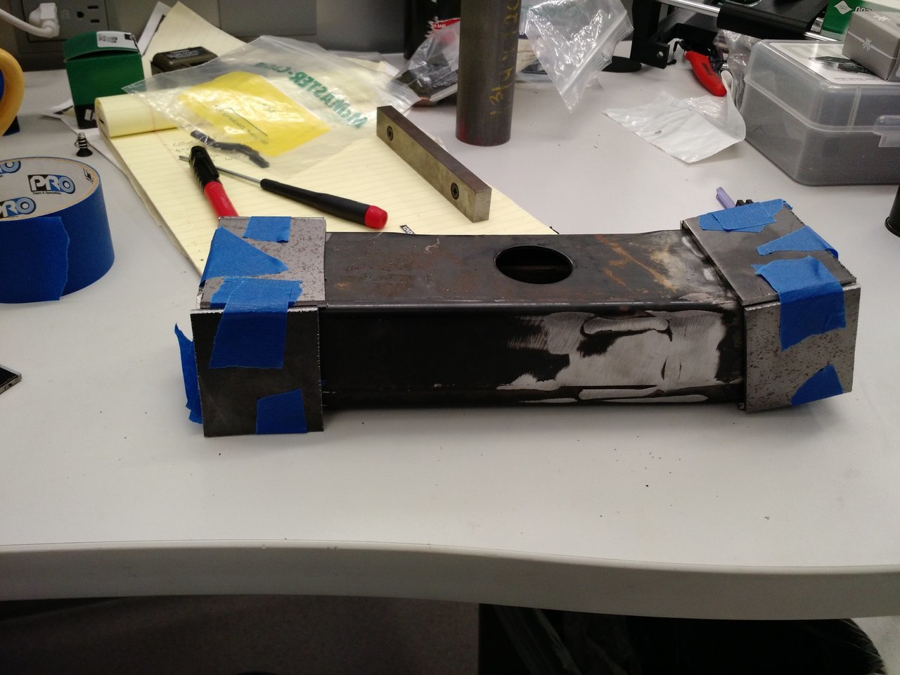

    Cut some 1/8" on the band saw at work. The ends are getting plated for the transmission mount. This section will bolt to the main cross bar again with some 3/16" arms

    I see what you did, but not sure why?

    So I'm boxing it in because the metal is kinda weak. The frame is getting the same so it doesn't collapse in. Just reusing the parts so I don't need to use a lot of metal to make a cross member

    Makes sense now. Thanks.

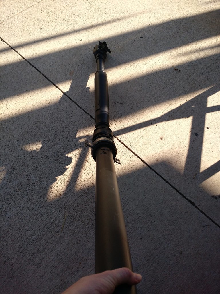

    6ft of reworked shaft.
    Drive shaft place found me a slip yoke that is the same series as my drive shaft. We'll if I work on this beast a lot this weekend should be rolling soon. Transmission mount pics coming Saturday hopefully.

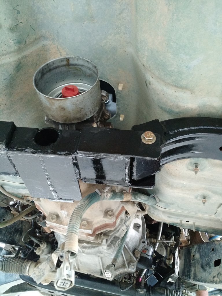

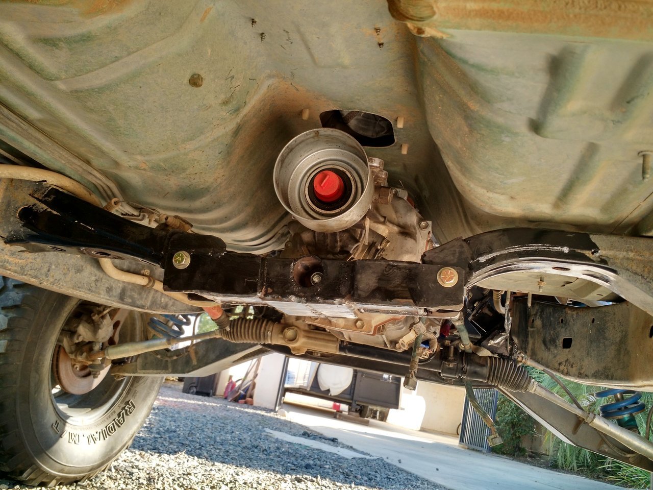

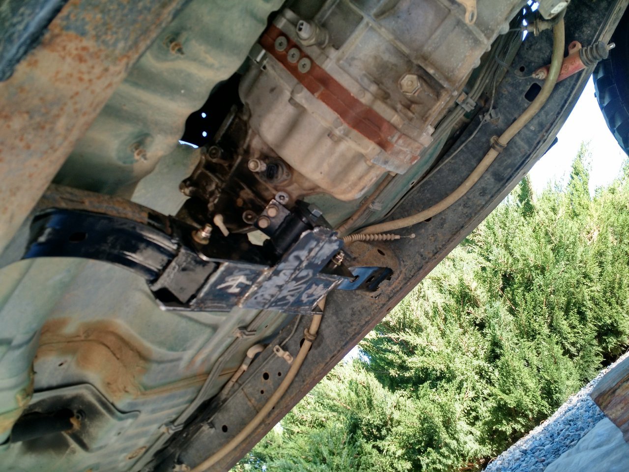

    Went dirt bike riding yesterday because the weather was amazing in the desert. Got the trans mount done. Not that excited about it. Sure gave me a fight. We'll see how it hold up. Bit Frankenstein looking. I'll make a new cross member if it doesn't work out.
    Drive shaft is giving me an issue. The input shaft they found is slightly different that what I told them to use. Dropping the shaft back off tomorrow to lengthen it an inch.
    Starter and clutch slave hooked up.
    Bolt up a few more things and I should be driving.

    That looks pretty damn good.

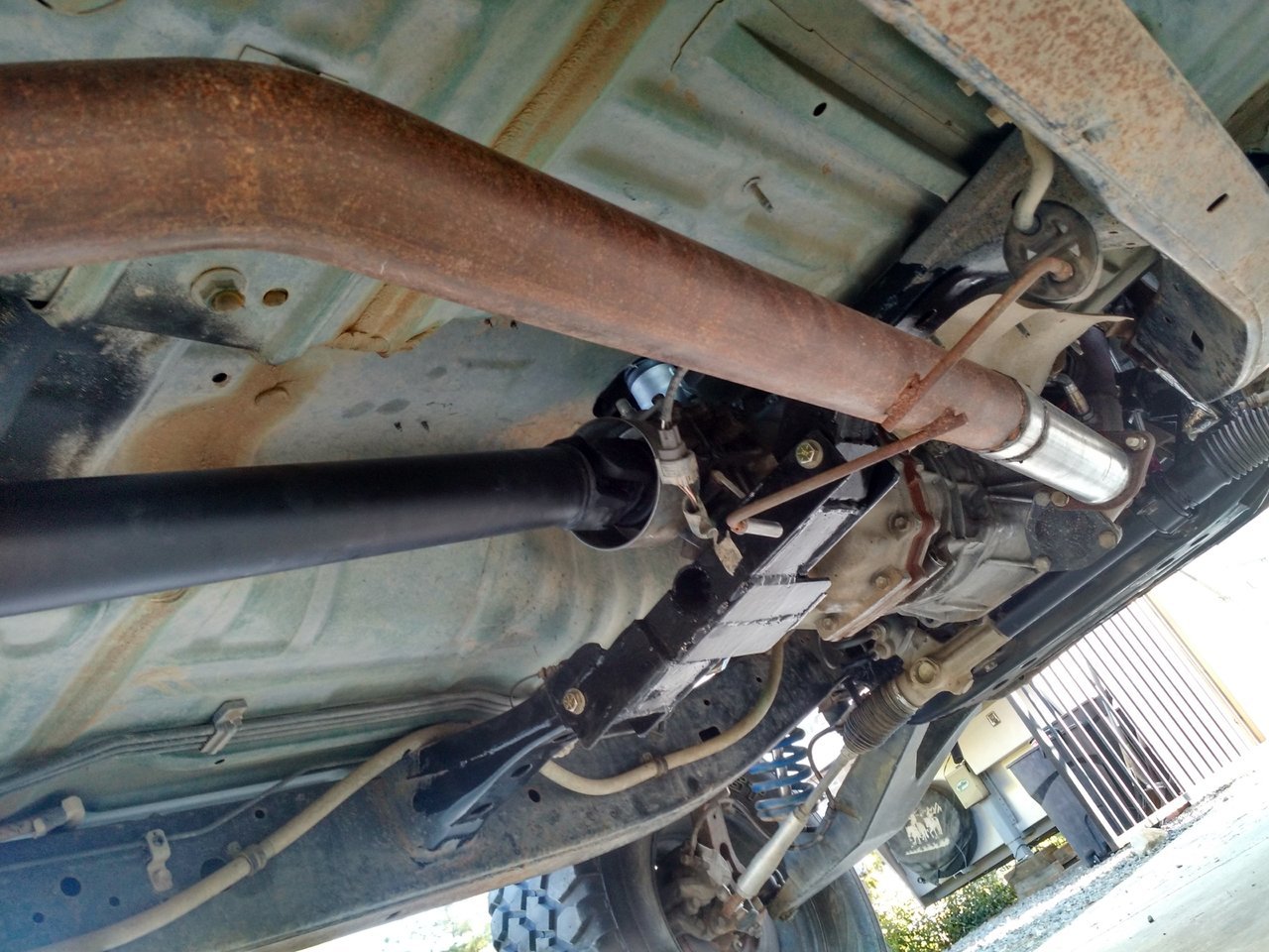

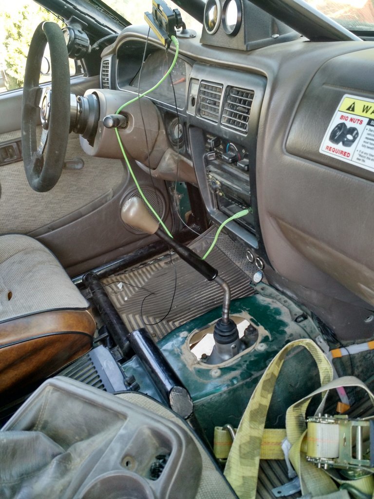

    She runs! Man this was a confusing swap. Drive shaft reworked for the second time.
    Driveline place used a 6" length slip yoke instead of a 7".

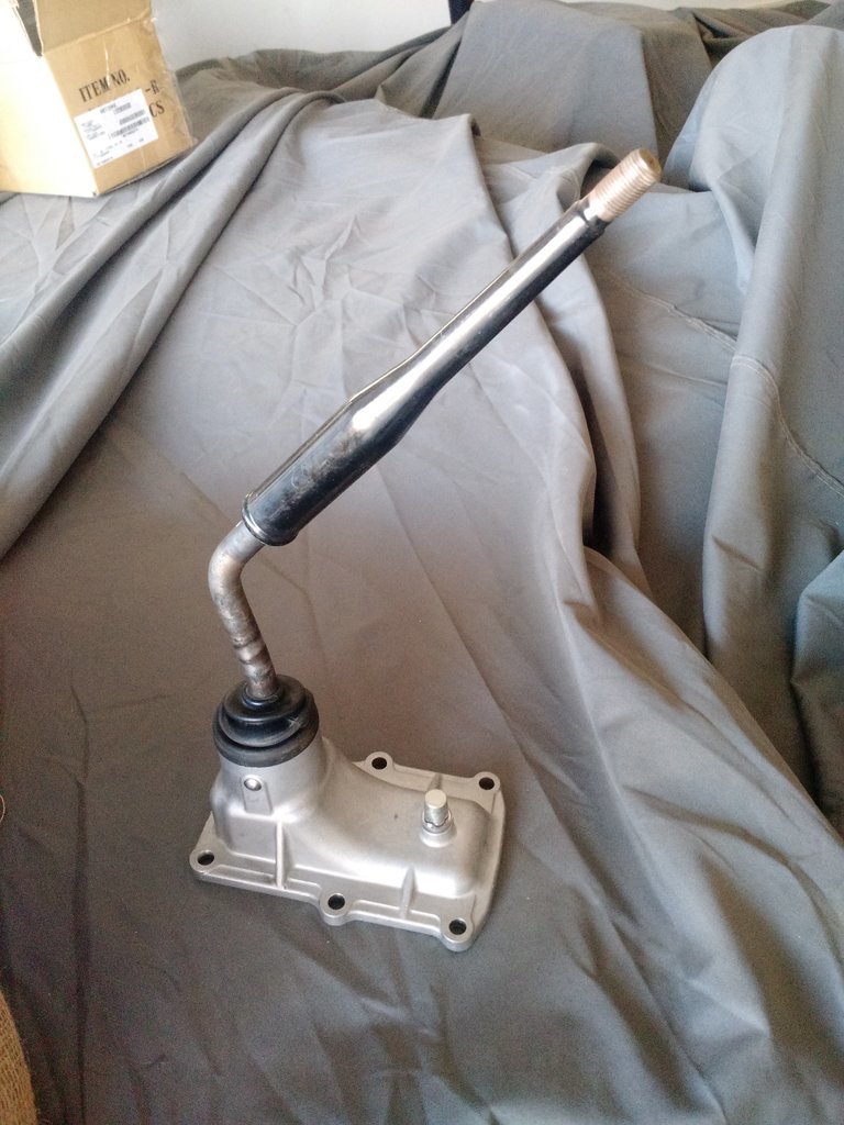

    Shifter sits in the same spot. Even used my w59 stick into the r155 base. Swapping to the r155 shifter because mine is pretty worn out.

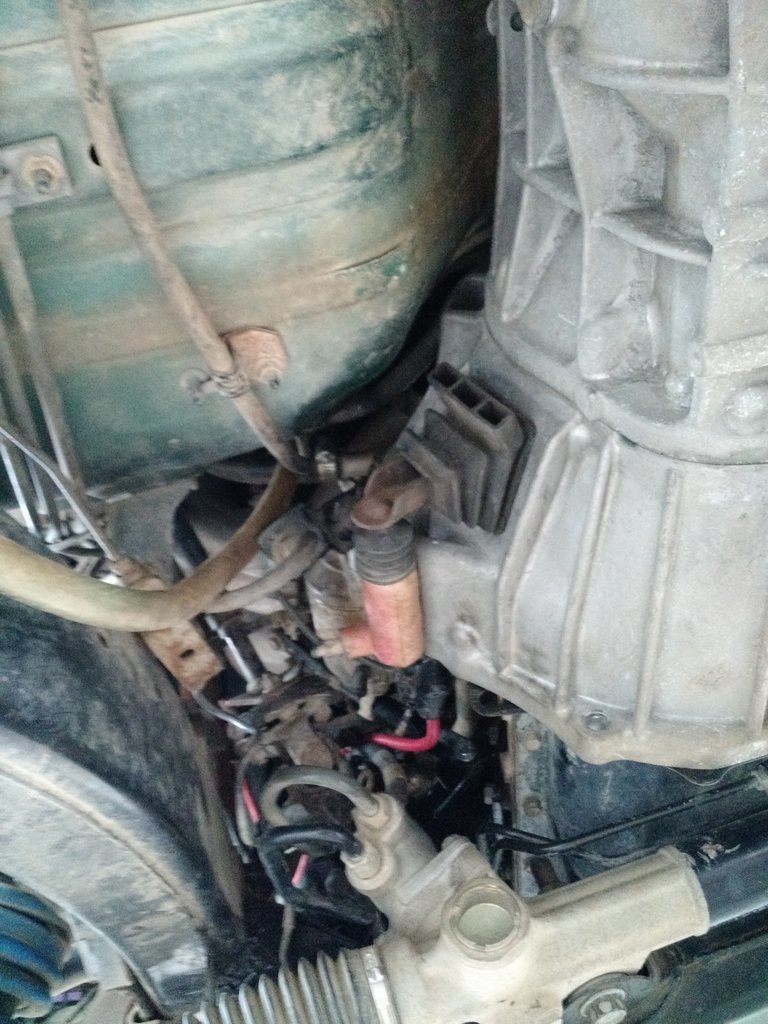

    Speedo works with my computer.
    Reverse light works.
    Starter works with 2rz flywheel.
    2rz clutch works with r155 throw out bearing.
    Just need to find or fab a lower engine bracket driver side.
    I'll make a thread on this that is organized better.
