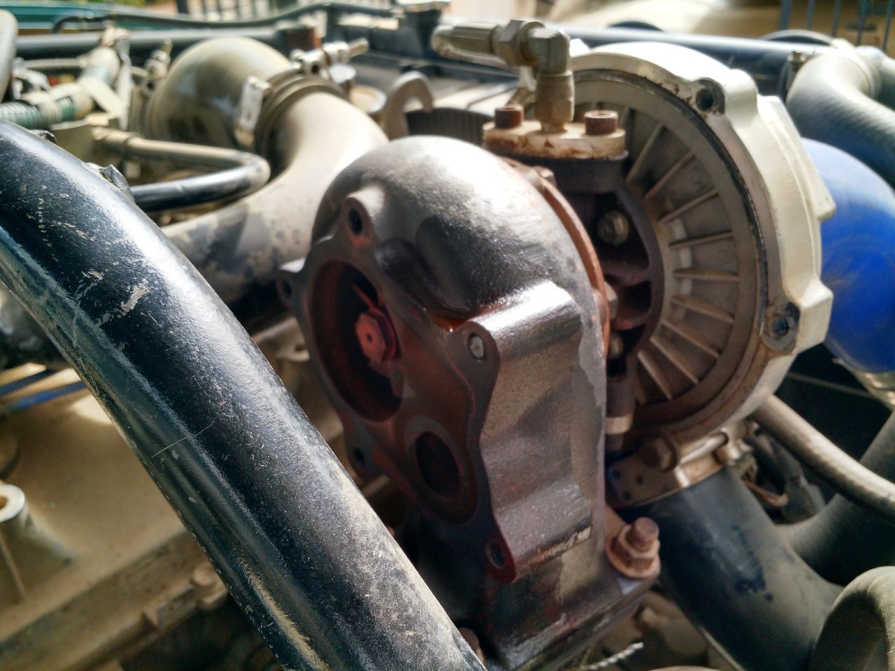

    Got the transmission all bolted up last night, but....

    Do you have a bolt snapped in there?

    Time for a nice Precision or a Garrett. Although it probably make more sense to just weld a nut on and pull it out.

    Bolt broke at the last few turns. Gotta pull the turbo to extract it. Had an exhaust leak at the flange so had to pull the bolts. At least they aren't ss.
    A gtx 3071 external wastegate has been on my mind. Don't think I have enough room for an efr 7064 internal wastegate

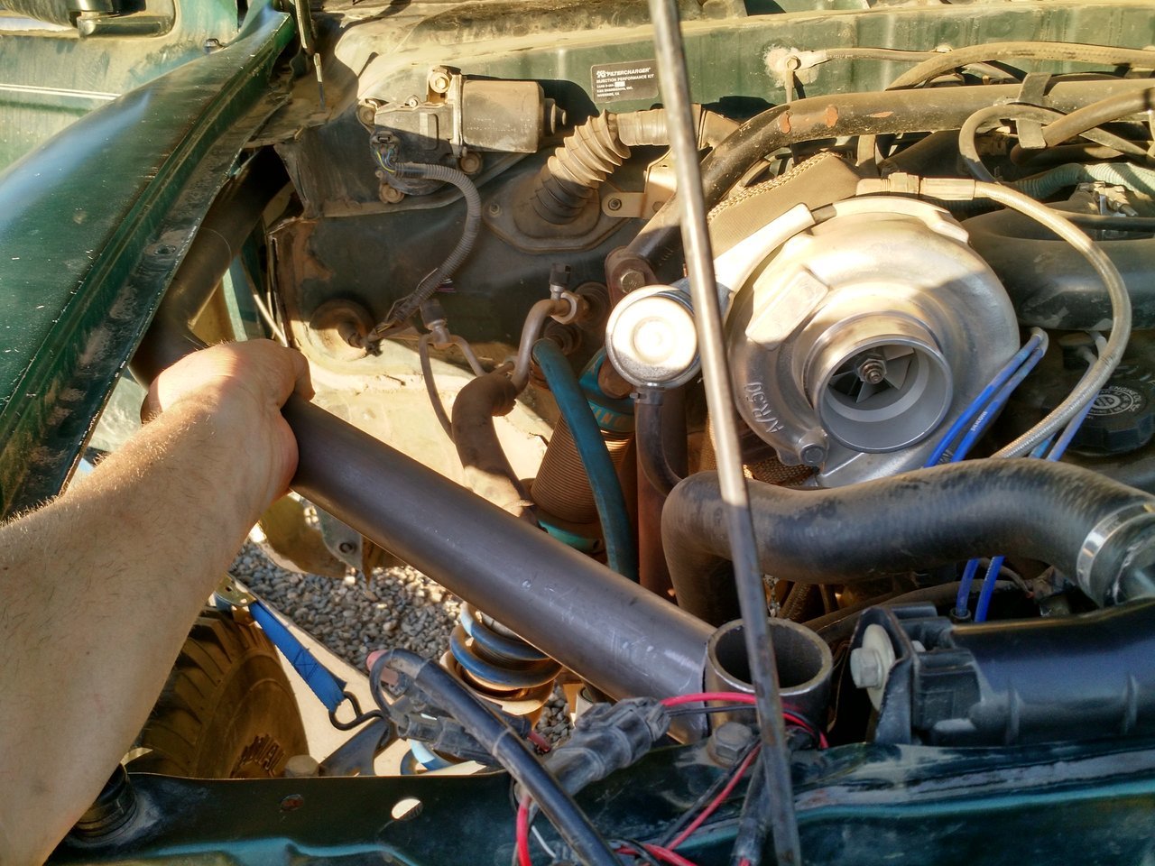

    I have a lack of room in the width of the truck. That wastegate arm is what gets me. Let me dig up a pic.
  20. Nov 6, 2017 at 12:55 PM
    #800
    MadTaco461
    MadTaco461 [OP] BRO runner
    Dec 30, 2009
    #28470
    13,411
    CA
    99 turbo 5 lug long travel
    Kinda stock
    Here a good angle of my constraints. Shock needs to be in that spot, but tubing can move.
