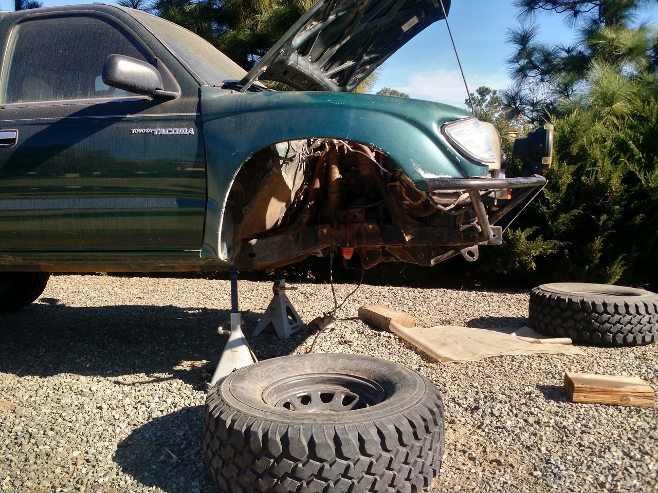

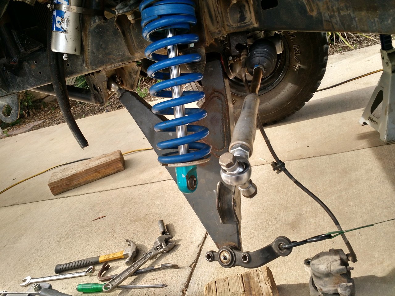

    Actually there is news. I went from hover truck back to all 4s.
    New rack, new hiems, new bushings....but I put the lower arm on the driver side wrong. How I'd do that? Good question. Few spacers got switched up during install. Stupid 5 lug trucks,lol. Pulling mad caster when I tried to align it. So gotta break the driver side back down next weekend. That spacer is pushing my front wheel an inch forward. Drove like crap.

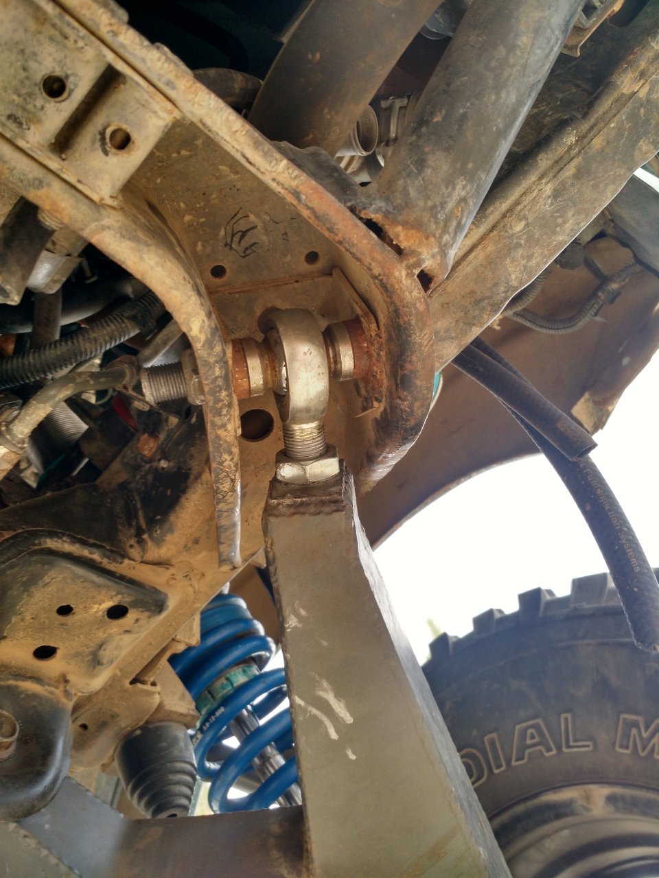

    Ratchet strap to pull the arm to get some spacers on both sides of the hiem. At least the rear joint is poly instead of delrin.

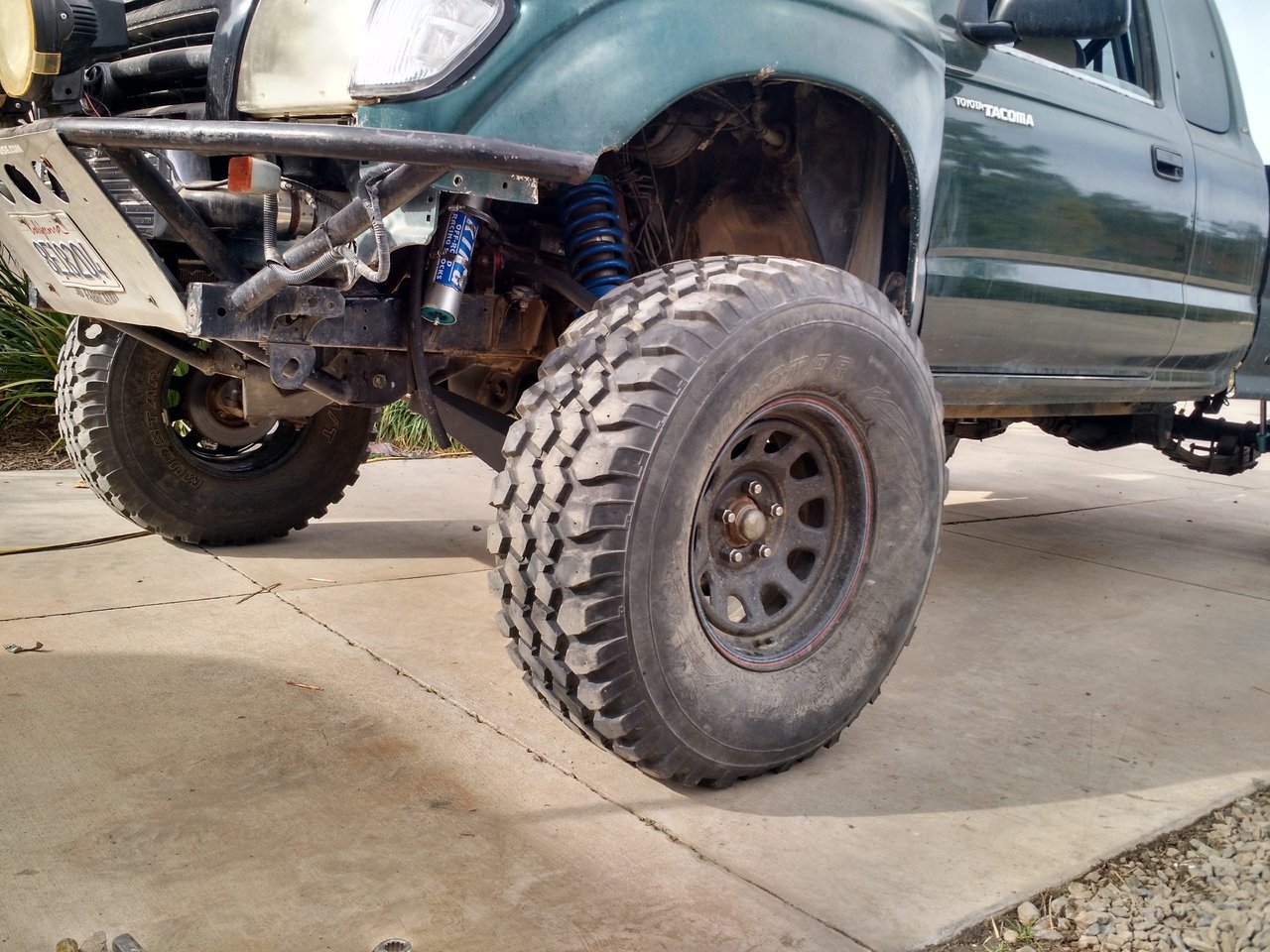

    Spacer in the correct spot and back on all 4s again. Lets go play with alignment for a few hours.

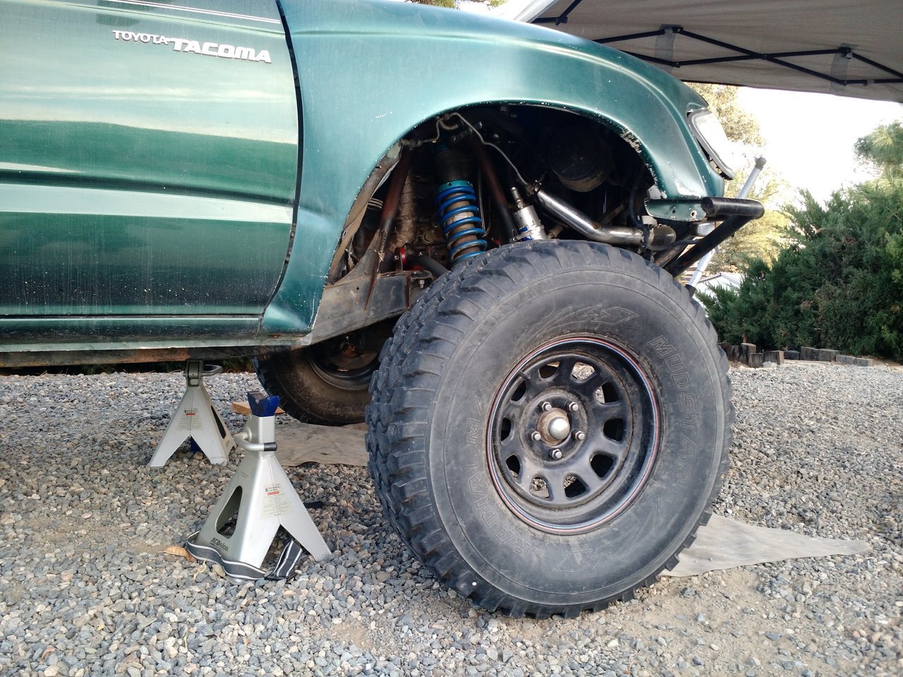

    Drives like a dream again. Took forever to get that new steering rack straight.
