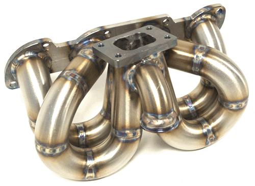

    It’s going to be ugly this first go around. Turbo going to be same area it is. Wastegate will be at the collector with an elbow. Once I get it in place i can make a jig and do a tubular manifold. Not doing this style but my collector will be like this.

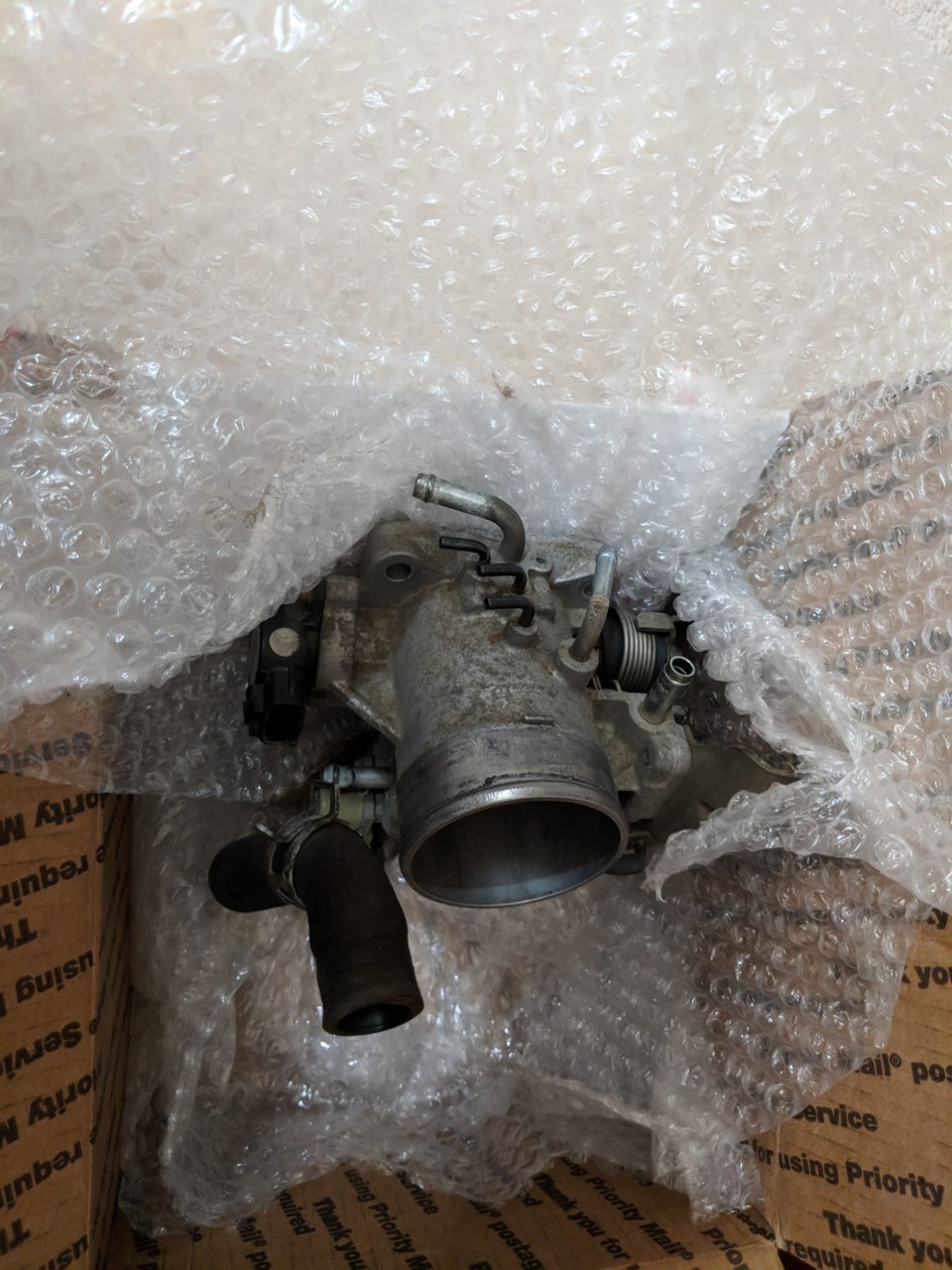

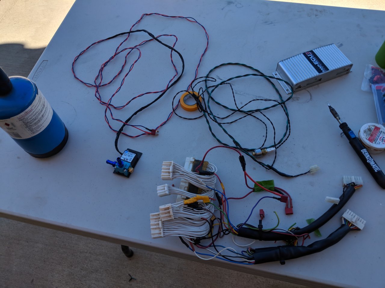

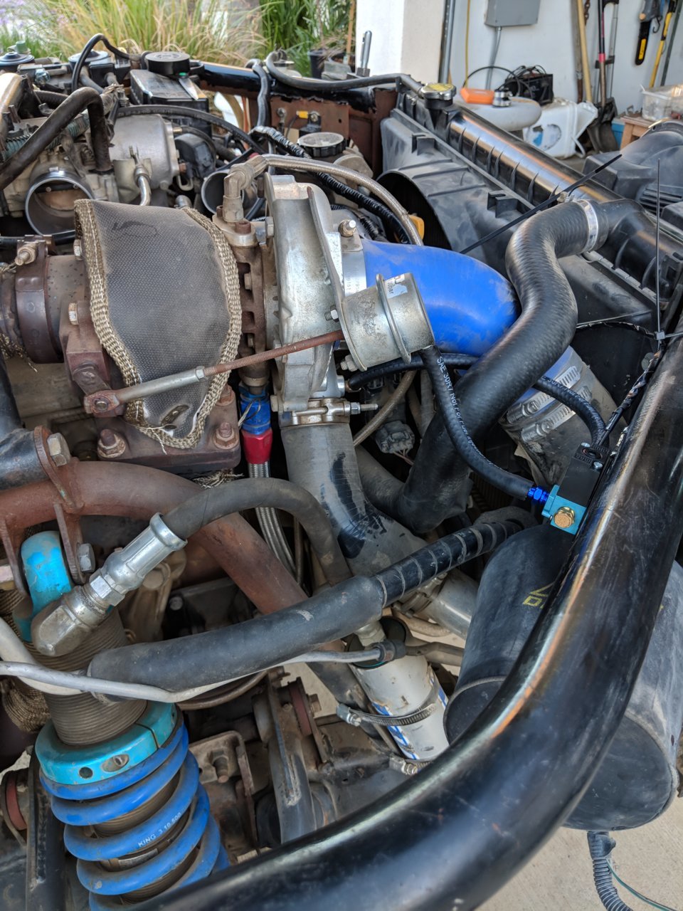

    Did a bit of work. Added an intake temp sensor right before the throttle body. Now I'll be set for boosted air temps. Also now have an electronic boost control solenoid hooked up. Even some hood pins as I'm slowly cleaning up this engine bay. Haven't drove it yet to tune with the new parts. Picked up another throttle body to clog up all those vacuum ports I don't use. Still collecting parts for the new turbo install. For now let's see what a $160 eBay turbo does when you add more boost.

    Is that all schedule 40? Hard to tell. I am curious about giving that material a try

    It looks like plumbing pipe because it's all elbows. I just grabbed the pic off Google. I'm thinking sch 10 is probably strong enough. Haven't played with plumbing pipe yet.

    Not really sure what the difference is it is just the nominal thickness differences. Anyway, this is why I said 40. You know better than I, so I'll wait for the lesson.

    Exactly, just wall thickness is the difference. Good prices on that link. I'll save it.
