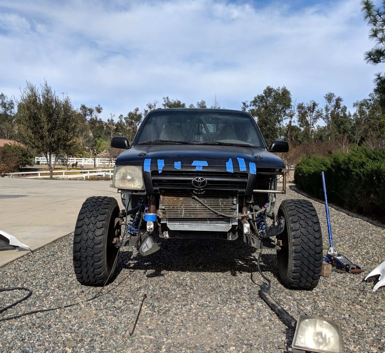

    That picture does mess with your head. I'm within an 1/8". Making core supports suck.
    I need a hand brake for those hoon videos. This is taking a while. Wait til you see the turbo tacked in place. It takes up some space under the hood.

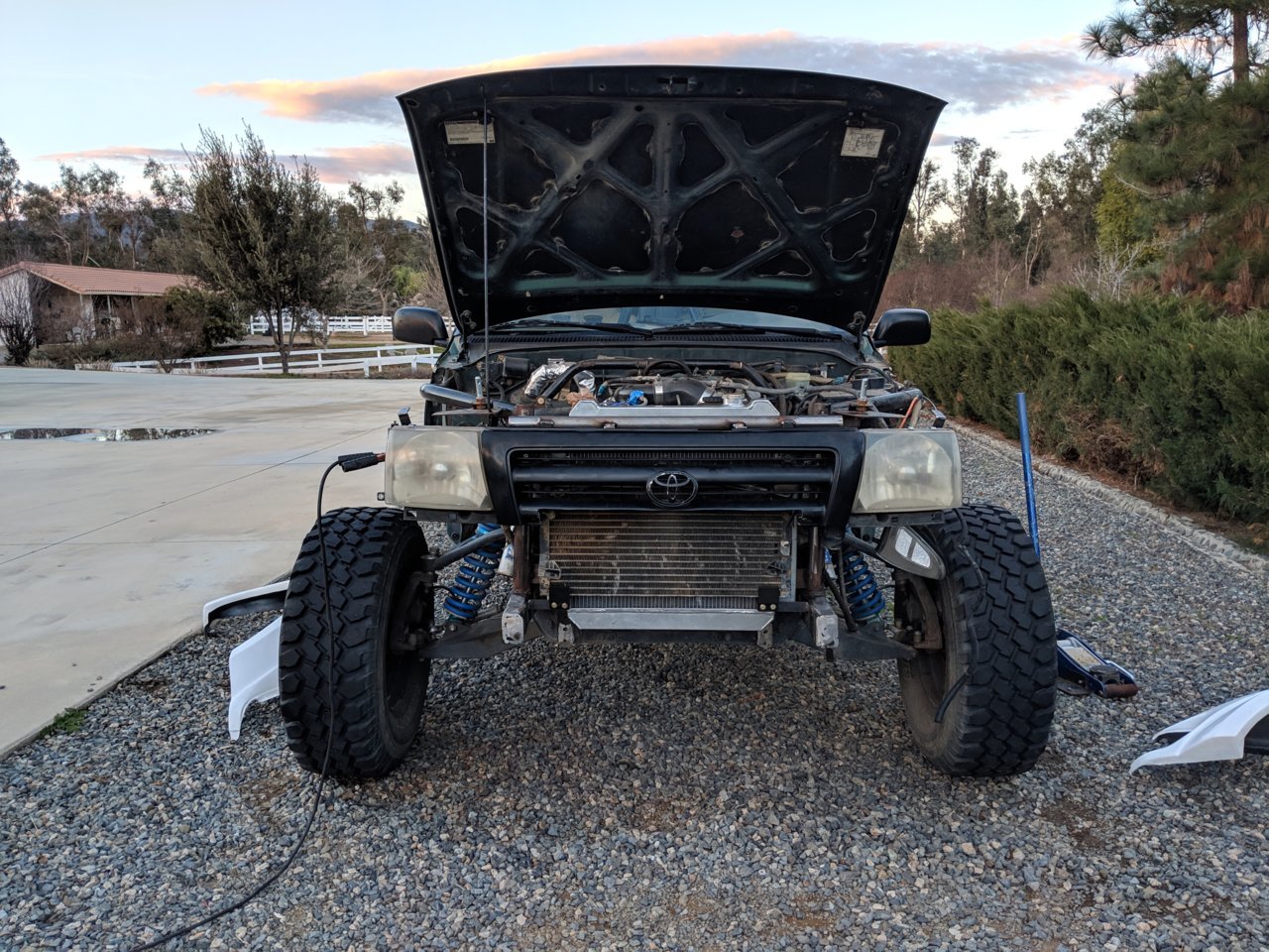

    Looks like something from toy story right now. Looking good if you stand back 10 ft.
    Head lights getting tacked. Front bumper went bye bye.

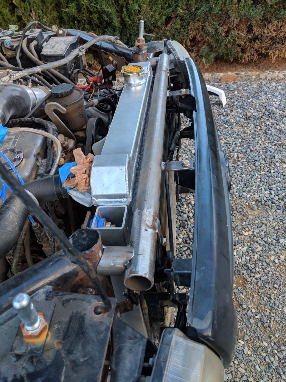

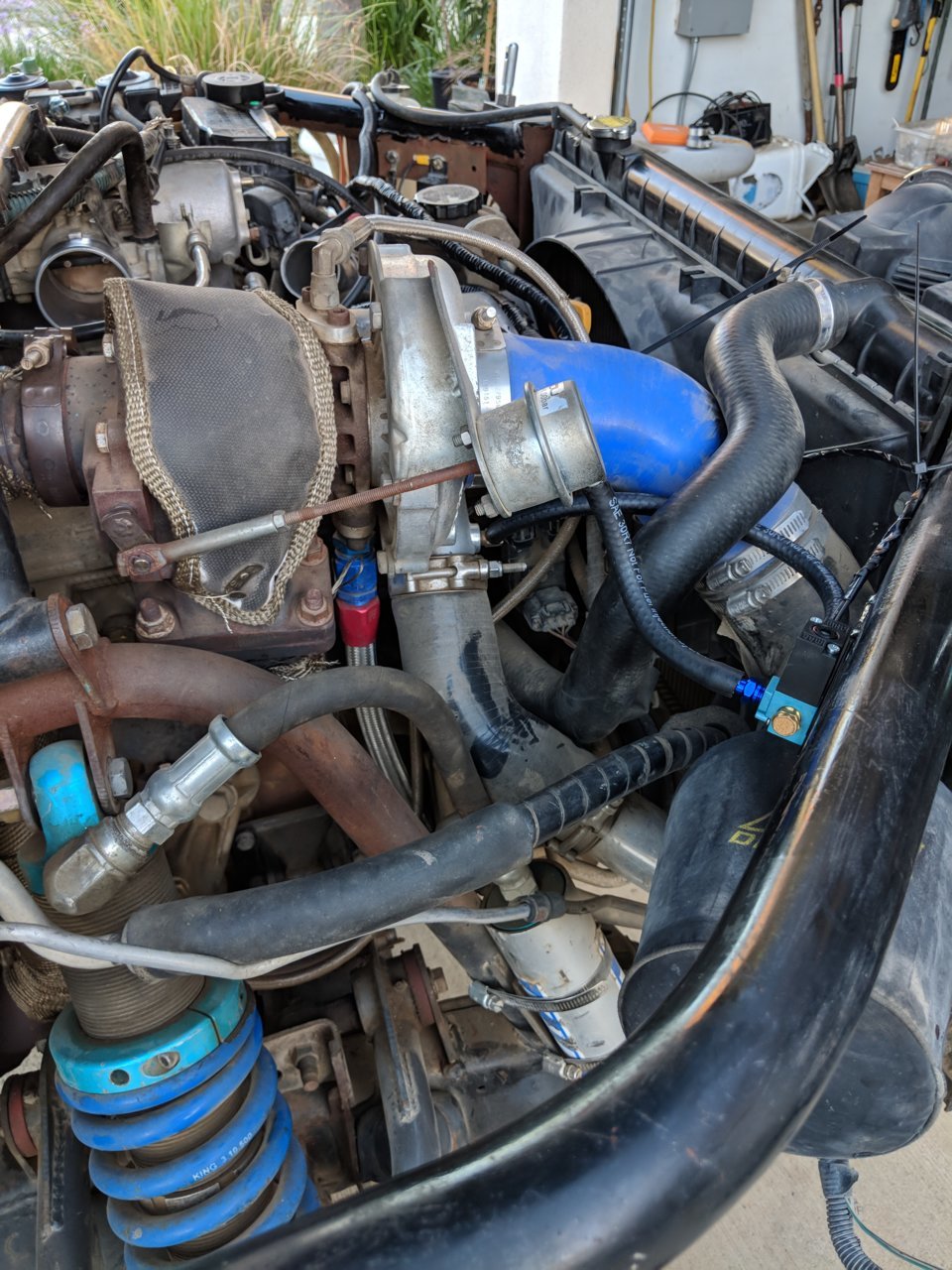

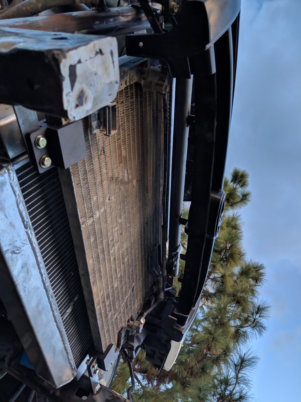

    So many brackets and tabs are going on. Almost done with the body work. Worked in rain and trying to dodge the wind. Check out the 3d printed lower ac core supports. Nylon/carbon blend. Hopefully tack up the new turbo next weekend.

    That bracket is nice - how did you design it / get it printed? Looking good!

    I drew it up on cad and printed it at work. Has .06" rubber inside the c channel to dampen the shock. My stock mounts were toast

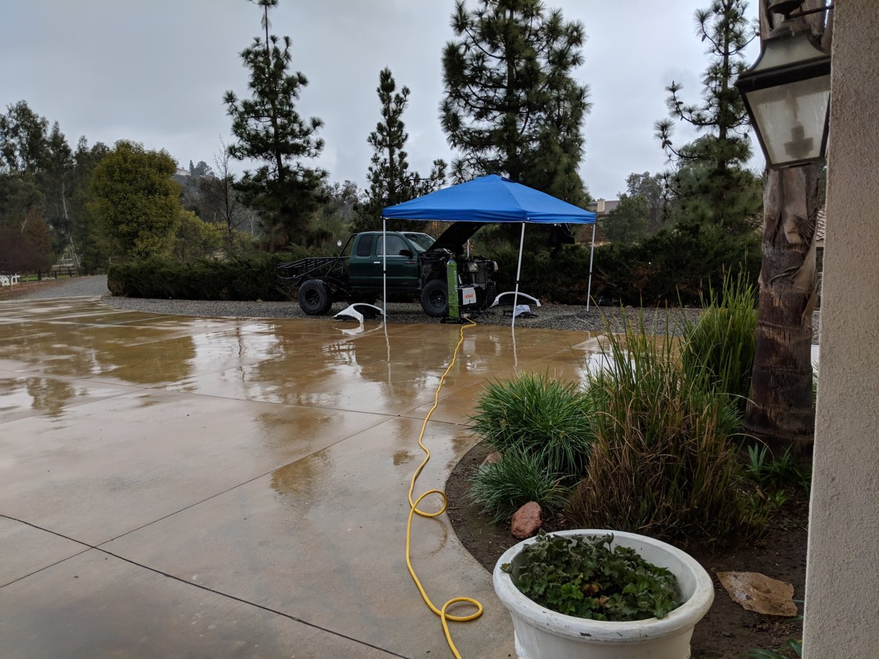

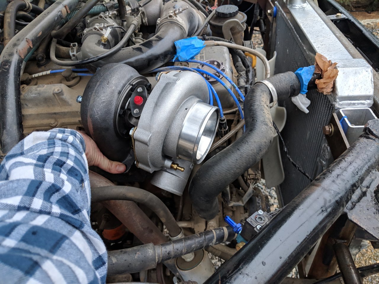

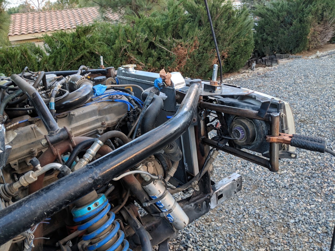

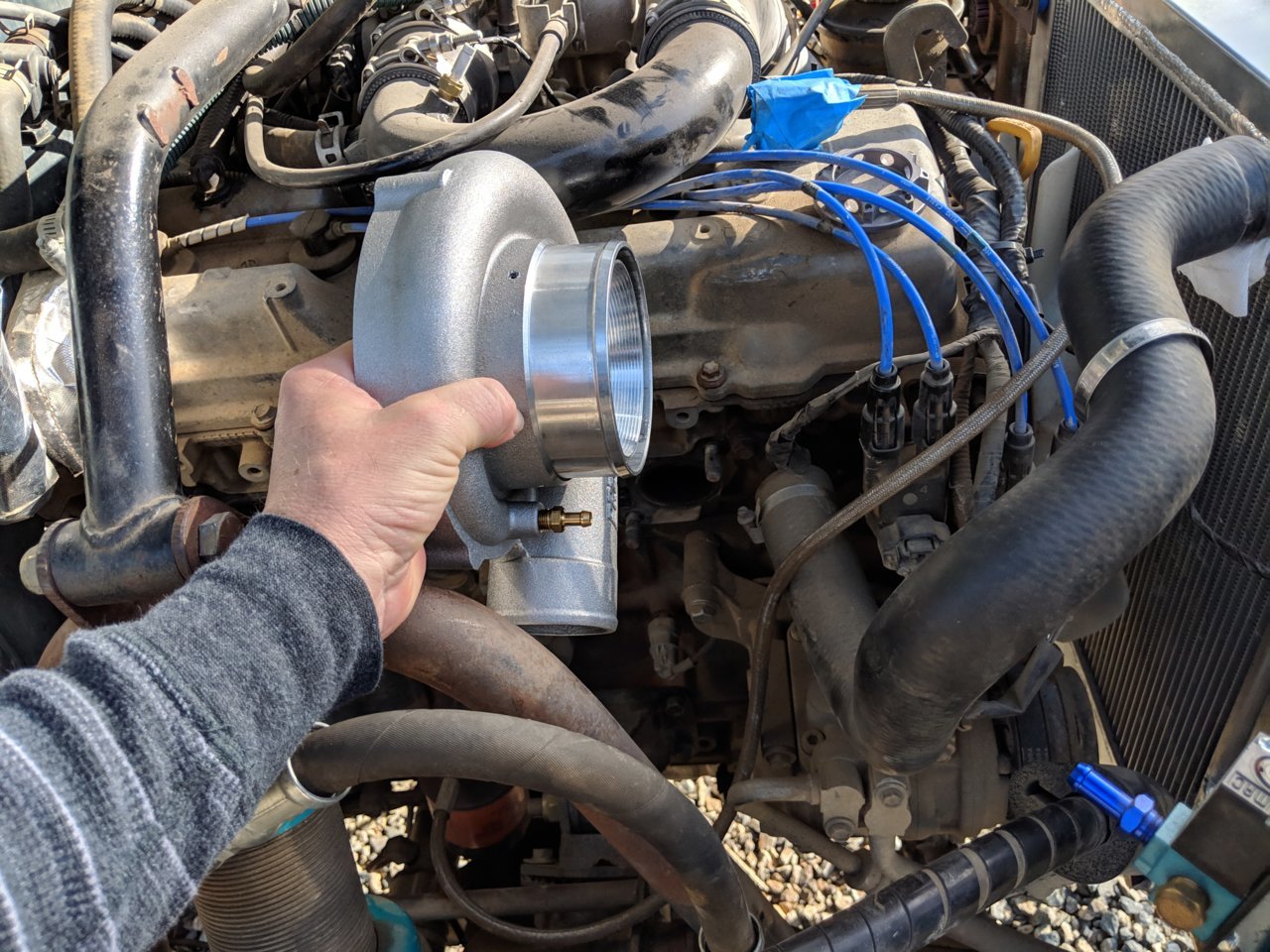

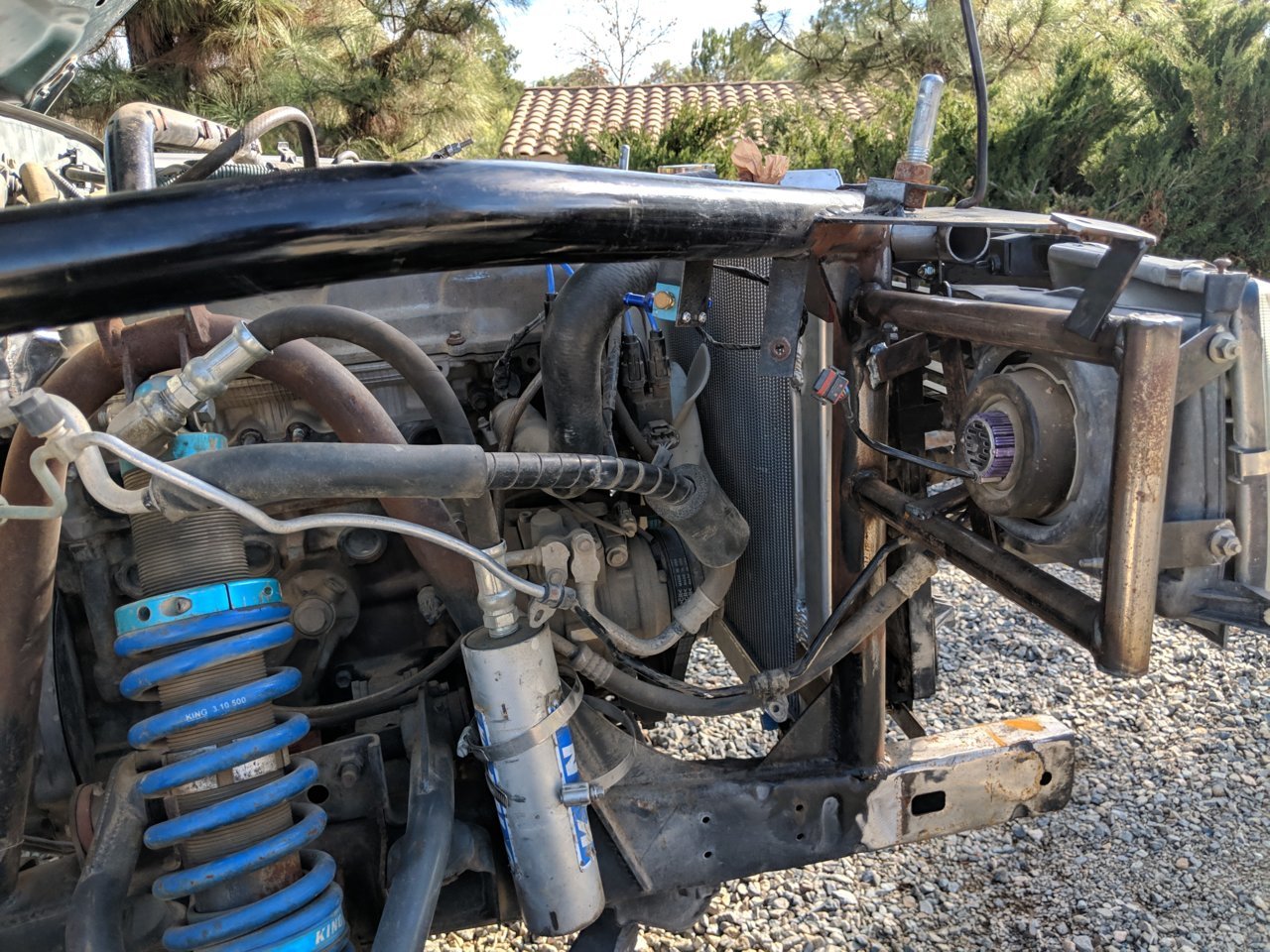

    Back when I was hacking stuff off, I cut off the eBay turbo too. Well this new one is big. Thinking about making a whole new manifold now. Maybe reroute that radiator hose too. Want to push the new turbo down and back. Think it will make everything cleaner. It keeps raining on my days off so haven't worked much.

    Following a similar route as I had to.
    Going to be TIG'ing it up with some schedule pipe?

    Man, I'd love a tig welder. Maybe I can throw some junk out of the garage and make room fro another welder. The plan is to make something new out of Sch 40. Modified log or a 4 into 1 is the idea.
    Give this man a freaking trophy! Come on you know I fab at a snails pace.
