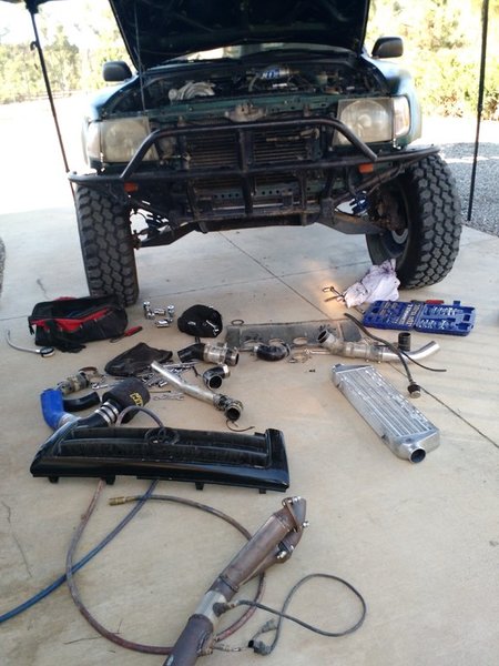

    Got most of the turbo stuff out today. Just have turbo, header and oil lines and the truck will pretty much be stock. Wasn't really that ambitious on it. I really hope it is just a head gasket instead of having to get the valves reset. I might change out the aluminum intercooler tubes to stainless. The aluminum is wearing away in certain spots. Off road makes boosting stuff about 10 times more complicated.
    Since I'm pulling the head I want to get a better head gasket and ARP studs in there. I need to find a local shop near me that can check out my head and let me know if my valves are good. There a a bunch of racing shops in my area. 17 year old motor finally showed me some weakness. At least my bottom end is still tight. I had a glove latex over the valve cover during leak down and it never inflated. Also with the head out of the way it would be the perfect time to switch to solid motor mounts. Man I need a different hobby, lol.

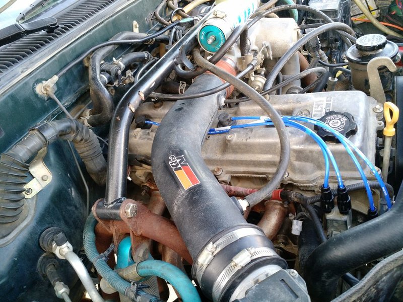

    Pulled the turbo off and got all the stock parts on. It started and ran for a few minutes. After a few minutes the engine started shaking and died. I got a p1310 code and kept getting the code after clearing it. It cranks fires and dies. I might have a loose ground somewhere. I don't think it is the cyl low compression is doing this issue but something spark related. It's probably not a coil pack since it runs. Fun electrical gremlins we have here. Want to solve this issue before I pull the head.

    Still no updates. It was too hot last weekend to work on the truck. September in so cal is a bad time to work on trucks. I have new spark plugs and plug wires going in soon. Electrical trouble shooting of the factory ecu is not my strong point so takes me a while to find it. I really hate that black box. I found the electrical pages from Toyota to test for p13xx codes. I need to sucker in a friend to help out for a bit.

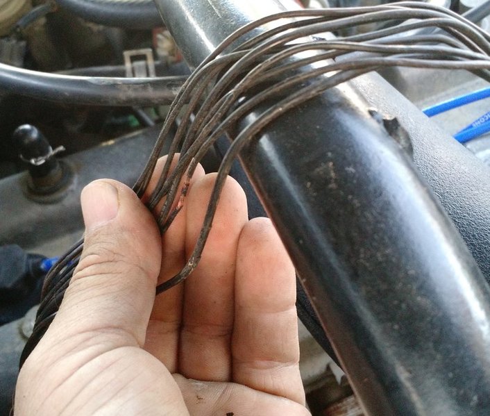

    There is a good possibility I melted wires due to my exhaust. All those wires go across the head. I'm also going to tackle that after I move coil packs around. The plan is to do spark plugs, wires, test coil packs, and check wires. I'd like to move the wires to the intake side but it is a lot of wires. Heat wrap or sheet metal heat shields are in my future

    Put some new plugs and plug wire in and moved the coils around. The truck still threw the same code. I went to the next step of pulling apart the wires that go to the ign. If you see the picture at my fingers you will see some exposed wires. Looks like that is my issue and it controls the 2 and 3 ign. Look like the turbo threw off a little too much heat. I'm going to get some wire and move it to the other side of the head and wrap up my turbo.
