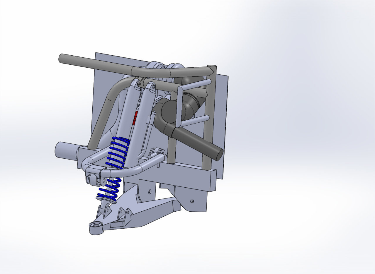

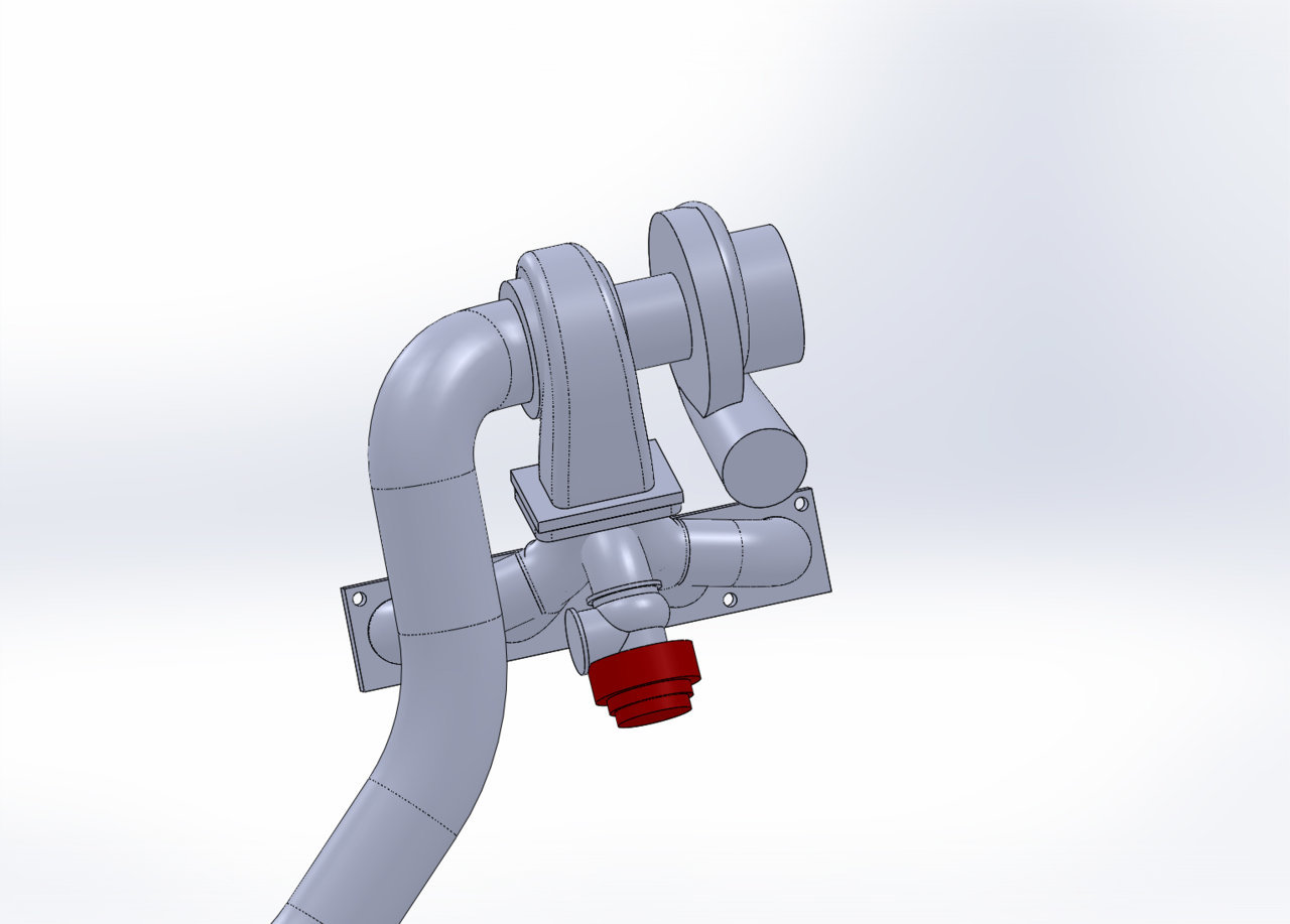

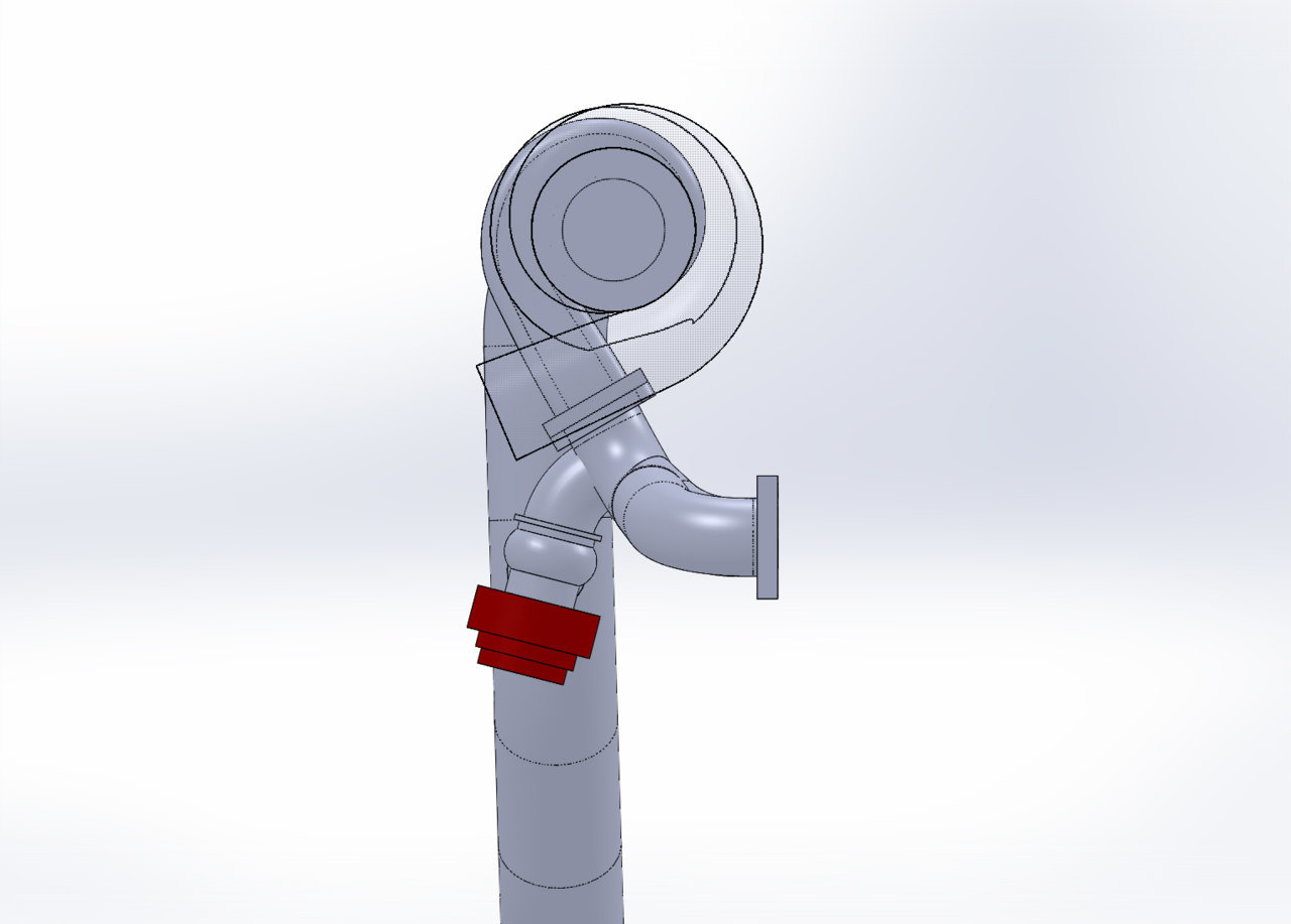

    Well traffic sucks so let go play with some cad at work right now. Figuring out how to do this new turbo. Planning to do a modified log manifold. Using sch 40 1.5" plumbing fittings. Everything should flow a bit smoother. Also seeing if my new engine cage gets in the way. I want to jam in a 10" bypass shock too. The manifold is going to be mild steel since all I have is a mig welder right now. I'll make a jig if I get myself a tig this year.

    So wait.
    Your helping the exhaust leave/cant think of the word :rasta: faster? With a blower?
    Is that what I'm seeing?

    It's a very crude drawing of my turbo sitting on top of the exhaust manifold. Yeah helping the exhaust not hit hard corners like my current exhaust. Help direct that energy to the turbo instead of being absorbed into my manifold.

    Interesting
    I could see it helping!
    Not gain ponys but run cooler maybe?

    New turbo is a tad larger. So making power shouldn’t be an issue. Also got a larger intercooler in the mail. Basically everything will be sized to flow up to 500hp besides the motor internals.

    That will make for good laminar flow, and wastegate scavenging.
