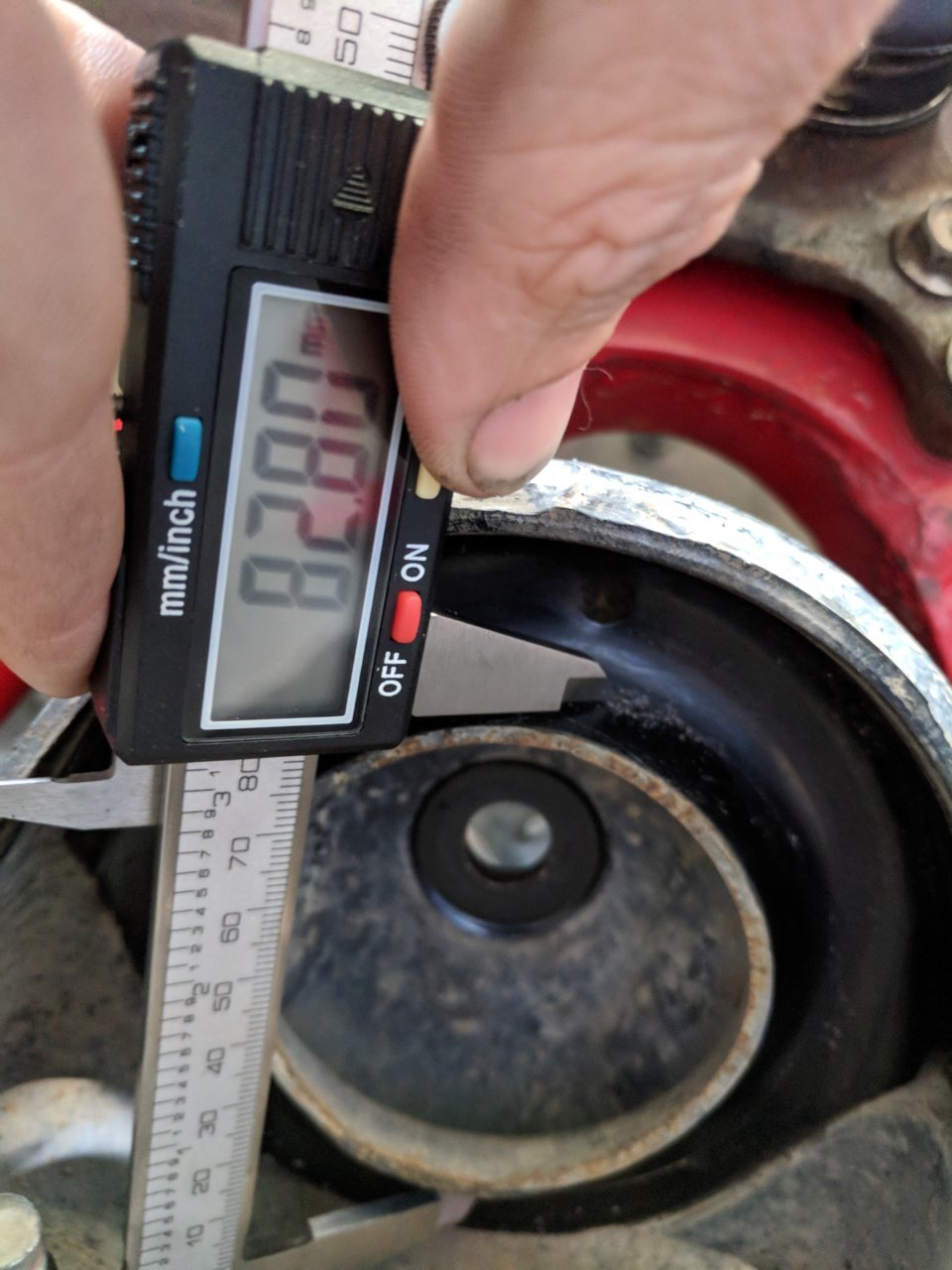

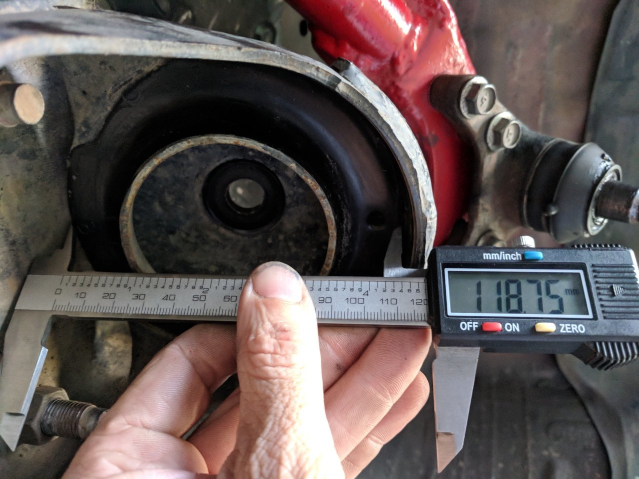

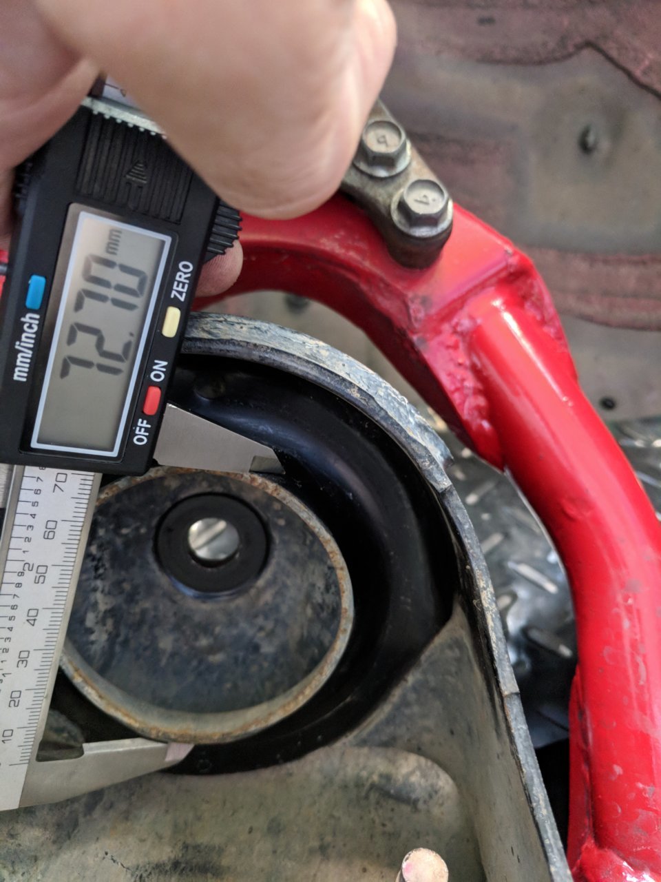

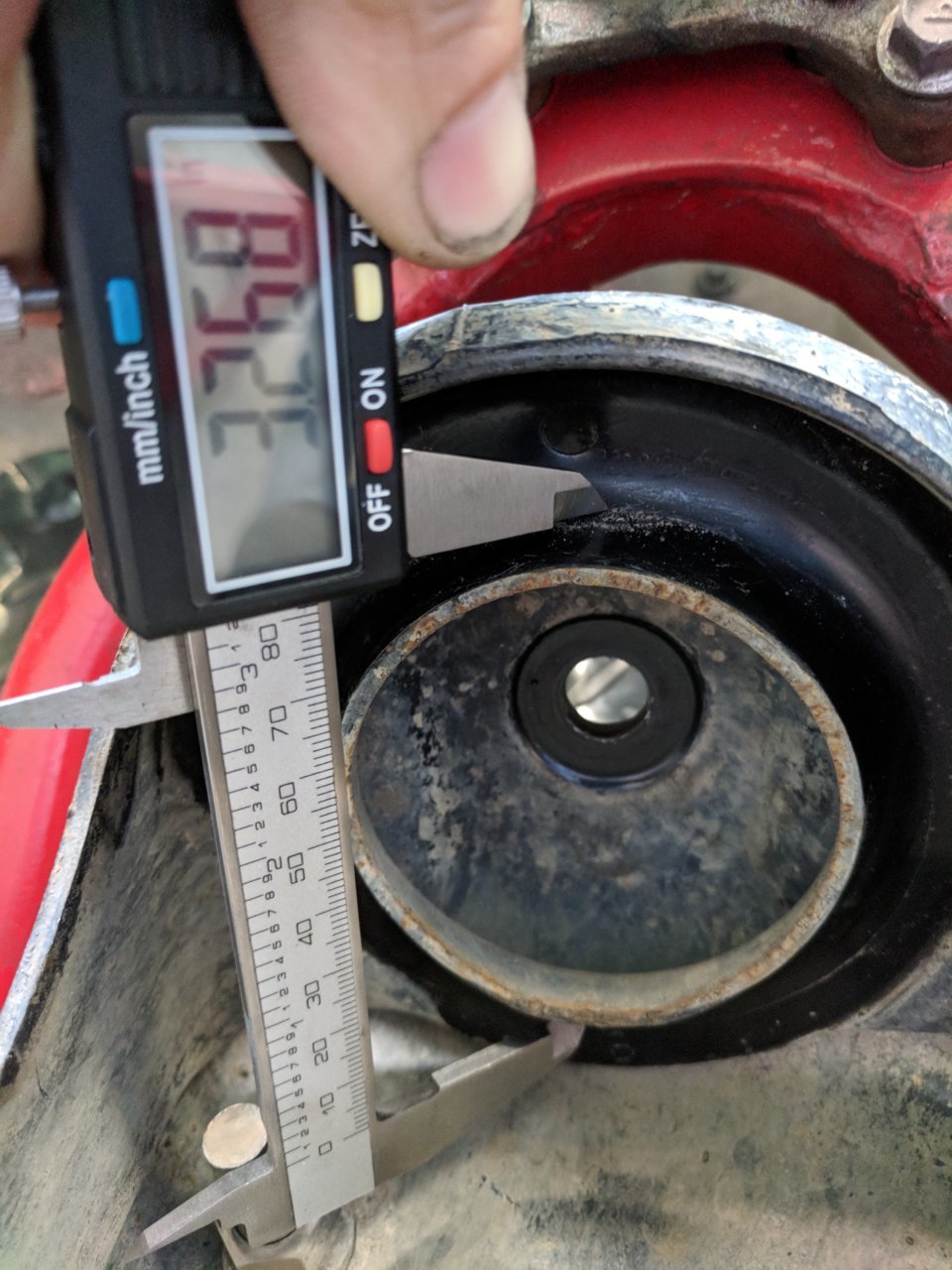

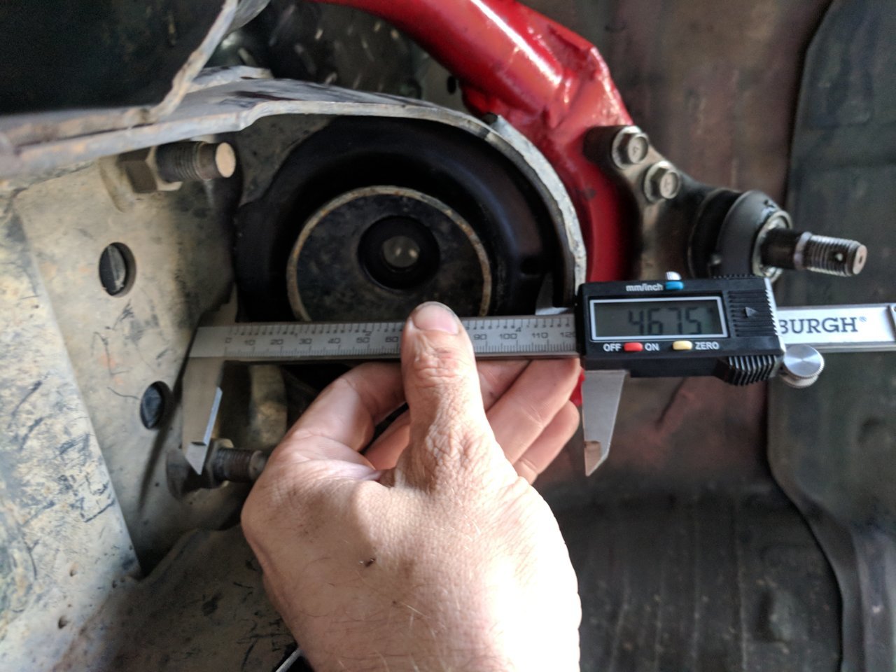

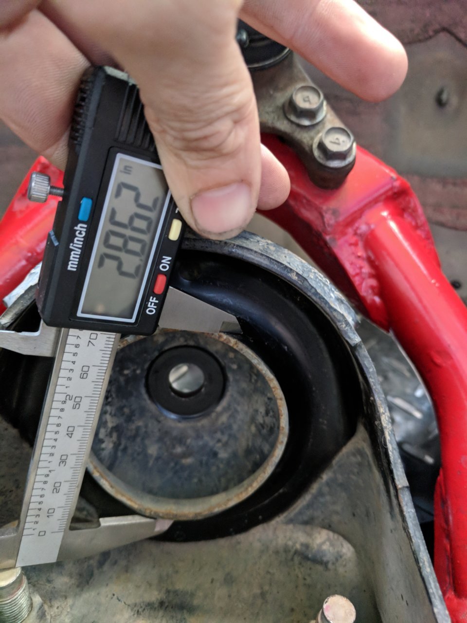

    Okay, so @Sperrunner I have to say you were right about those 2.5" springs and the coil buckets. Here's what I came up with when I measured:
    Smallest diameter to largest diameter. The 4th and 5th photos are pretty close to specs for stock coil spring inside diameter, and I tried to show that you may be able to go with something a little less than 3.3". I wanna say you might be able to squeeze 3.0" springs (standard size) in there, but not certain. If so, it wouldnt rest all the way to the top of the coil bucket.

    I forgot the size but lowrs truck guys run gm springs. These are alot shorter but right diameter. Mini truck guys run 8” tall gm coils with qa1 shocks

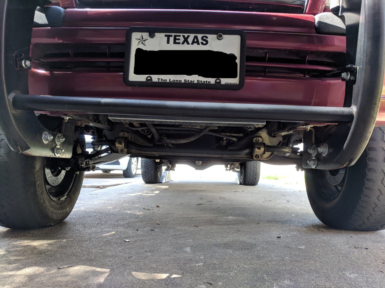

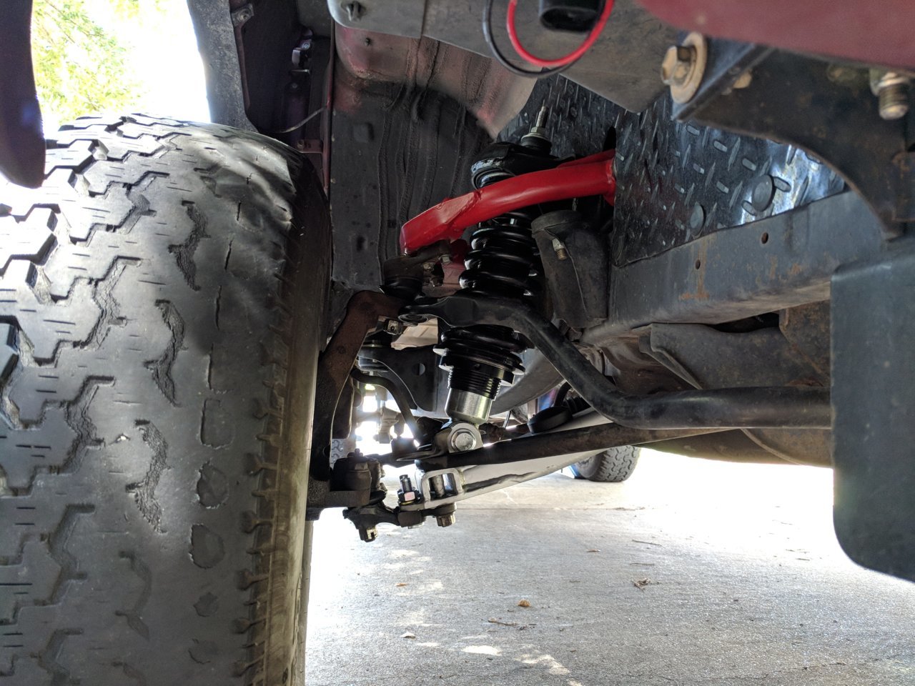

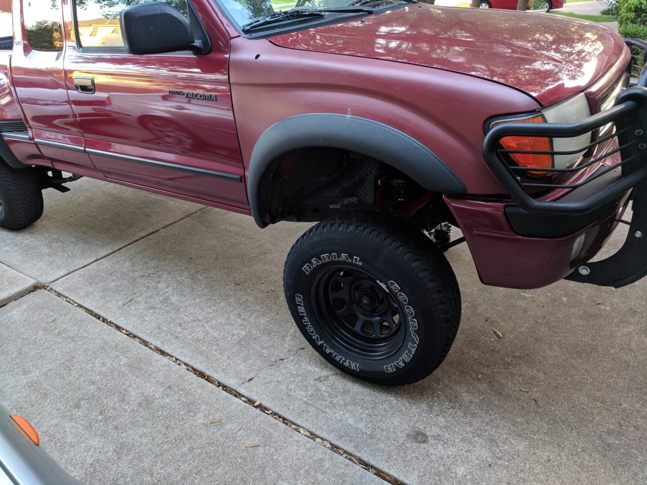

    Notice I am on the lowest setting, so there's more lift to be had if I cut the bump stops mounts off the frame. I was surprised at the amount of lift. Just keep in mind I have a 2" Body Lift as well.

    What do you have in the rear? Does it sit level or does it squat in the rear. Because I assume you have like 6”ish of lift up front
