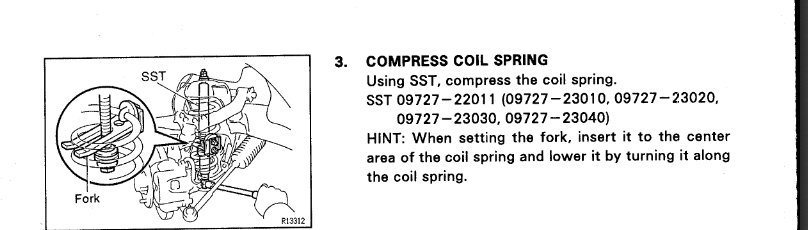

  15. Aug 8, 2018 at 7:42 PM
    #275
    TacoBunny
    TacoBunny [OP] Well-Known Member
    Oct 11, 2017
    #232668
    289
    AZ
    1997 5 Lug 5VZ

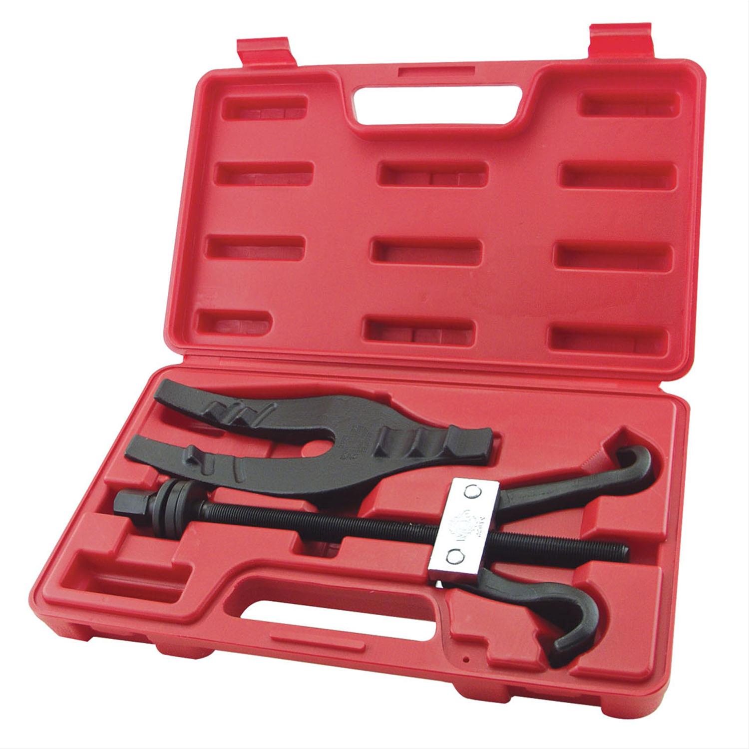

    I have this
  17. Aug 8, 2018 at 7:46 PM

    Well, im a freakin idiot

    this is what the FSM was showing me i just assumed the autozone loaner tool would work

    Lol the toyota tool is like 500$
