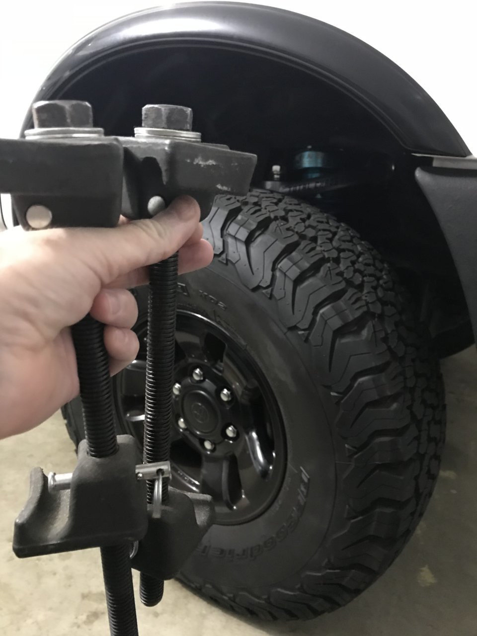

    043557EB-C165-419C-8E9C-74FB9C054C1B.jpg Anyone used a Brannick like I have? I do springs all the time guys send them to me and save fingers. I can do everything from King to stock and this compressor keeps everything straight when compressing.

    Wouldn’t work on a 5lug. Its not a assembly

    E3C1890E-0544-4277-AFC5-022C8D674681.jpg So you have to use these shitsos?

    You can but they are kinda hard to position on our trucks.
    You need the one that goes down the center

    I've used those. They get wedged under the coil bucket or on the lca n had to beat them out with a sledge. They are real sketchy the way they bend and flex. Definitely not safe but they get the job done... Sort of

    Um i dont think the compressor should be bending... atleast mine didn’t

    Lol these pos compressors are better for pressing in bearings and cups w/o heat and cold. So do these five luggers have to have the spring compressed to get the shocks in, if so they have longer shocks in comparison to the 6 lugs, I can just jack the chassis up and they slide in like they are buttered.

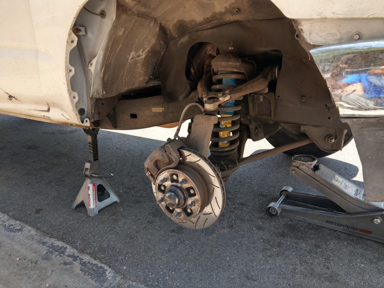

    So to start i took the wheel off (obviously)
    OW-FPsWMIRIWR9KrbTOSbF1h8wGoRXMhhfAR25l0_dedd2ab3f5404b06e1e7cc1fa4a4a2824561a1ab.jpg

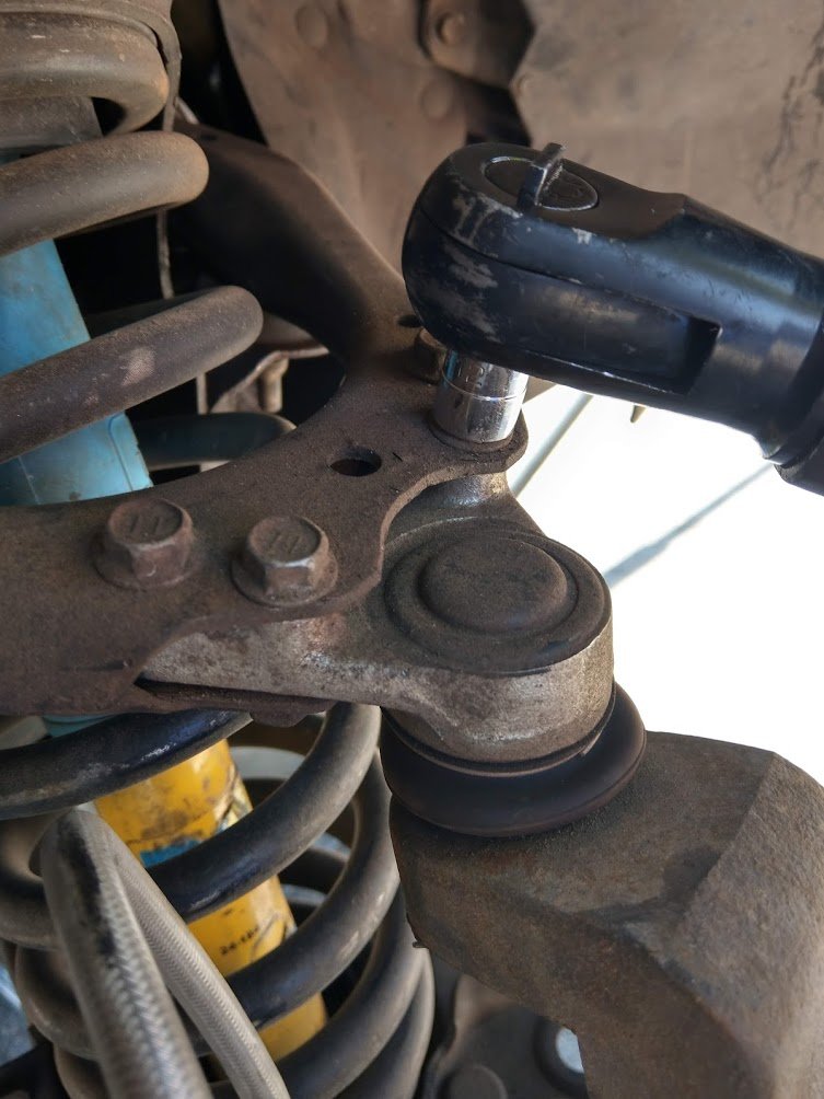

    Remove the 4 Upper ball joint bolts
    q0jaacpKXI1A5xlNTBkGGfjQV8bIYGhKEZfz3TQw_b582fa10ab4b262c957778dfab2c3e9e3af6ac8a.jpg

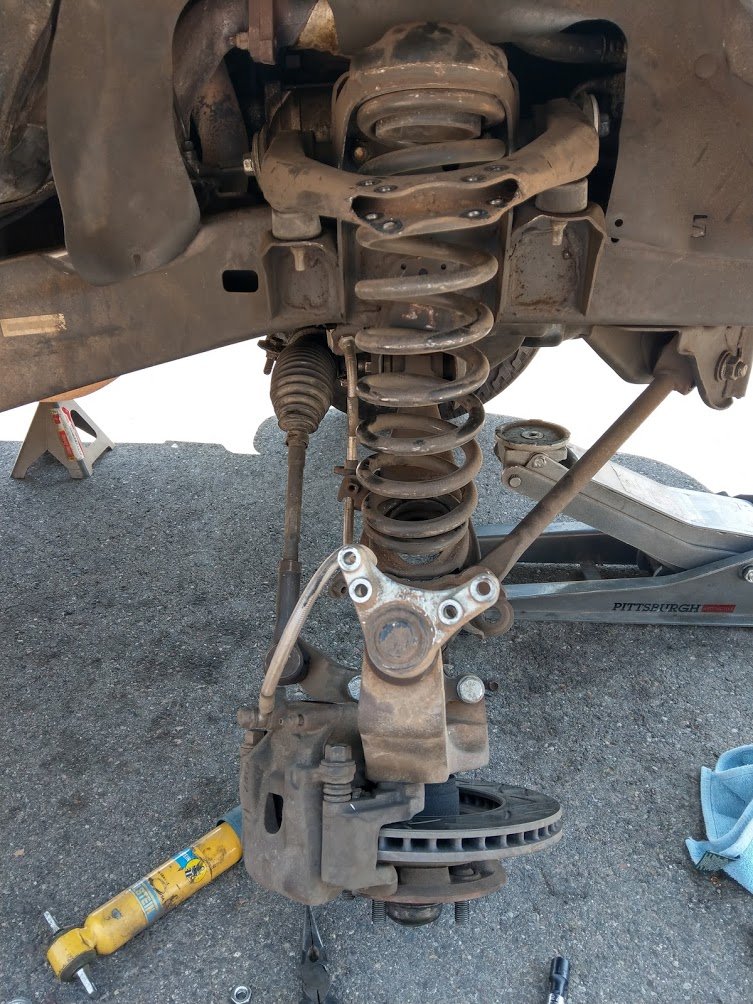

    Pull the upper ball joint from the upper control arm and let the assembly hang (you can use a jack and it wont put stress on the ball joint)
    --J4fKDddqC4IpZrt2sa2X9CsWGwQbrpVtRMOpi1_fab7adf4a3d16037c7b04573ce5dc9114b1e5e82.jpg

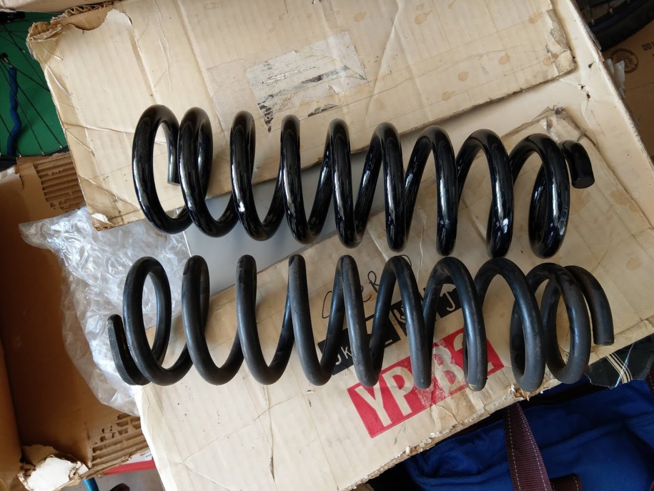

    Lift coils and stock coils are oddly the same length
    vwNtqA_-d39RWckMSPQvlhJeMosIsi7YjM5xlzLr_70004c87b5f9fe5fc6d7ca53269e9c7538716030.jpg

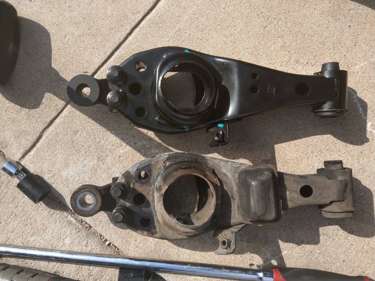

    I didnt get the next step in pictures but Behind the control arm you will fins 2 bolts holding the Cross Shaft to the spring perch, remove those and the Upper control arms will simply pull up and out.

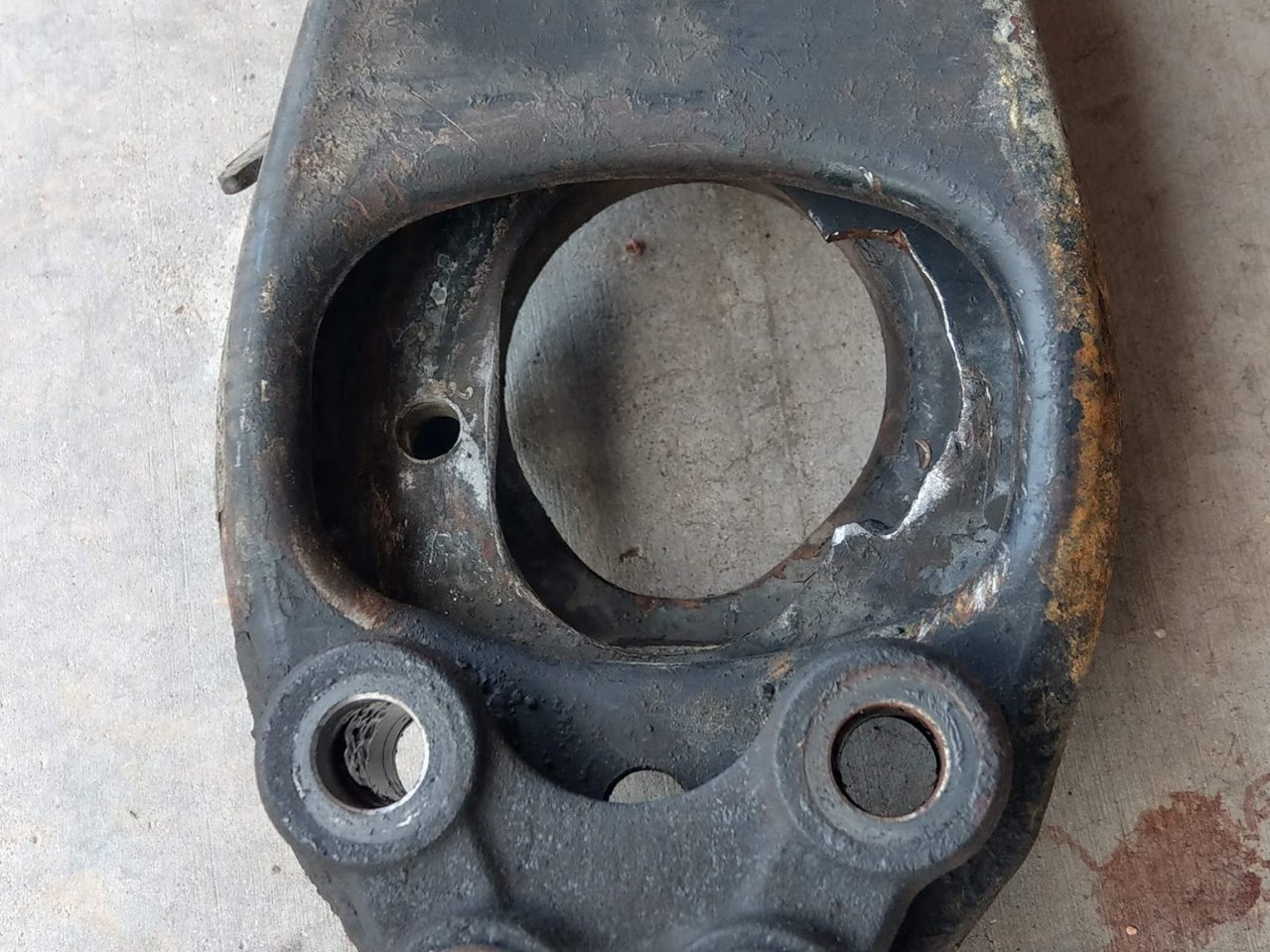

    NEXT: to get the bushings out i used a 5 ton jaw puller... everything worked but the stock control arms are so weak it started to flex and the metal tore down the middle! I used my angle grinder to cut them in half and it made it much easier.
    AoSJJv_ojdy6p5O9tV_UVfJs12DGTAGaZCc7n8Qp_a7c4ad27b922358557d909459e95fa358a36bf2c.jpg

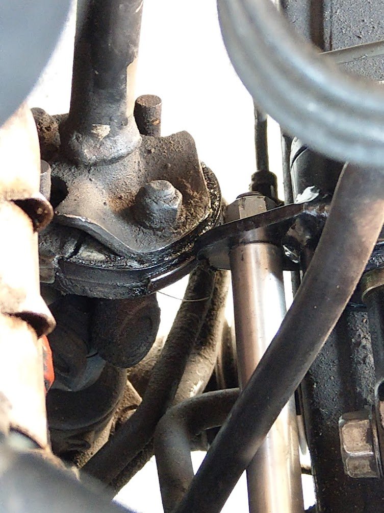

    NOTES: WHEN INSTALLING ON THE DRIVERS SIDE YOU MAY NEED TO TRIM THE BRACING TAB TO AVOID RUBBING THE STEERING JOINT
    Ask me how i know...
    5CdQ6pVsszM3lNfZMKzLk1VUnjIYOrNelgBweoST_ebe4a606263a31cbd6e0720eb85aa49ee8c1df63.jpg
    Trimmed tab:
    MLBtW5KnY3UHbVVZnqBotv8n-xgCx6vRZkK2xRmn_5df4e40a906627049b691ee37ddf9b977f142fc6.jpg

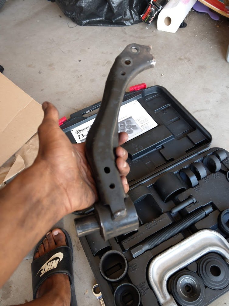

    BONUS:

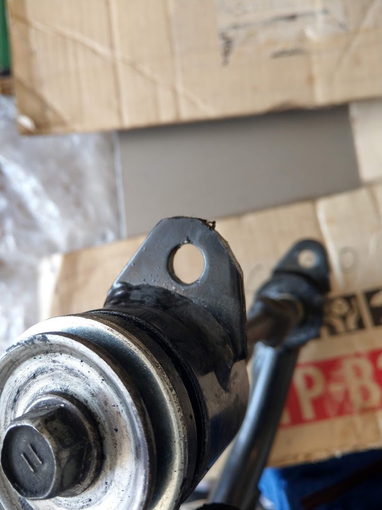

    My drivers side UCA was broken so i replaced that at the same time. VERY VERY EASY to do. I ordered the replacement from MEVOTECH, very high quality and exact fit.
    mwjnbzcMFUk-hfaRAIvUpsu53GVqPQSYgOZ7Enif_9314f7e37be3c7e4a65a2ce94764b539c6c7f64a.jpg

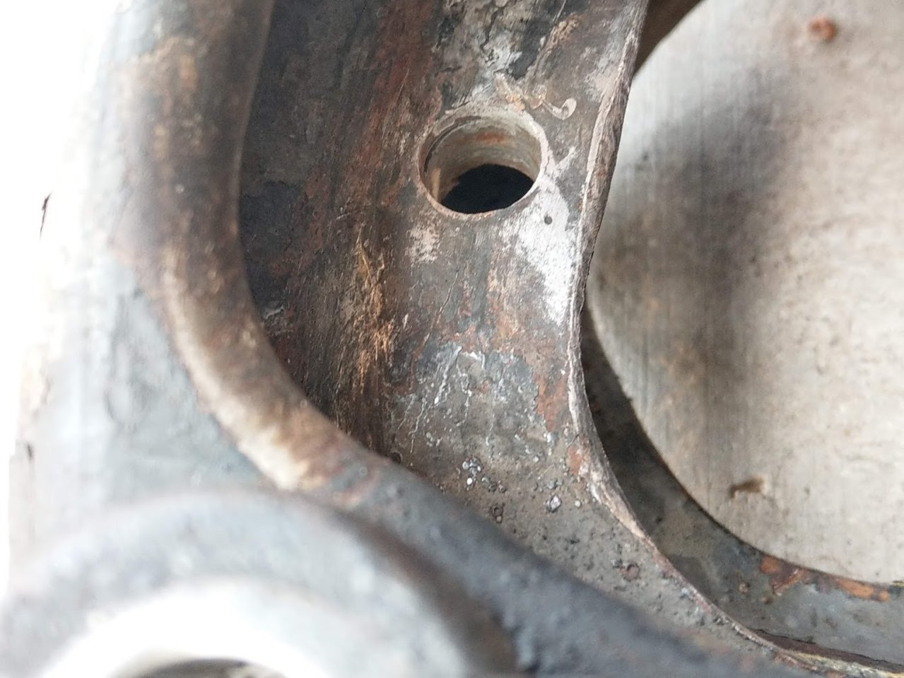

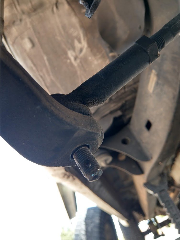

    This is why i replaced it...
    Stripped shock threads
    DEJnFIzG0V41Gu-AXtCvvQv1gG7HaJZ9aVHbS0GJ_5605079e4f04a4a97fc644947e8285415004e122.jpg
    The other side was just missing altogether
    81xjVs9YiqKlArvhmDIyUcGoScD607xweYEDP_VE_330db31453e13cbbe297a5b44a1bbab4393adc91.jpg
  20. Aug 14, 2018 at 11:46 AM
    #300
    TacoBunny
    TacoBunny [OP] Well-Known Member
    Oct 11, 2017
    #232668
    289
    AZ
    1997 5 Lug 5VZ

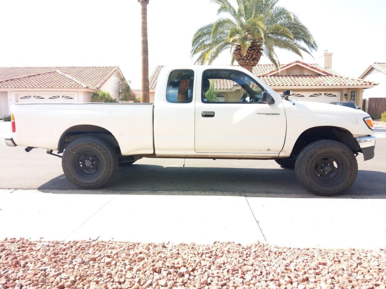

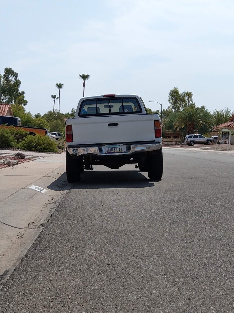

    Heres how she currently sits! Ignore that janky bumper
    JCJIUDgb_lEFwOezunZxFR8fXW1Vq-CqdIFlYown_a047cffcfe026134384127dc28fc268cea7ff736.jpg
