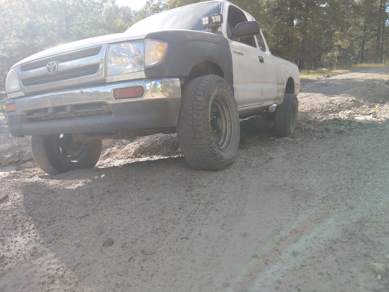

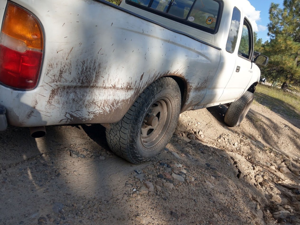

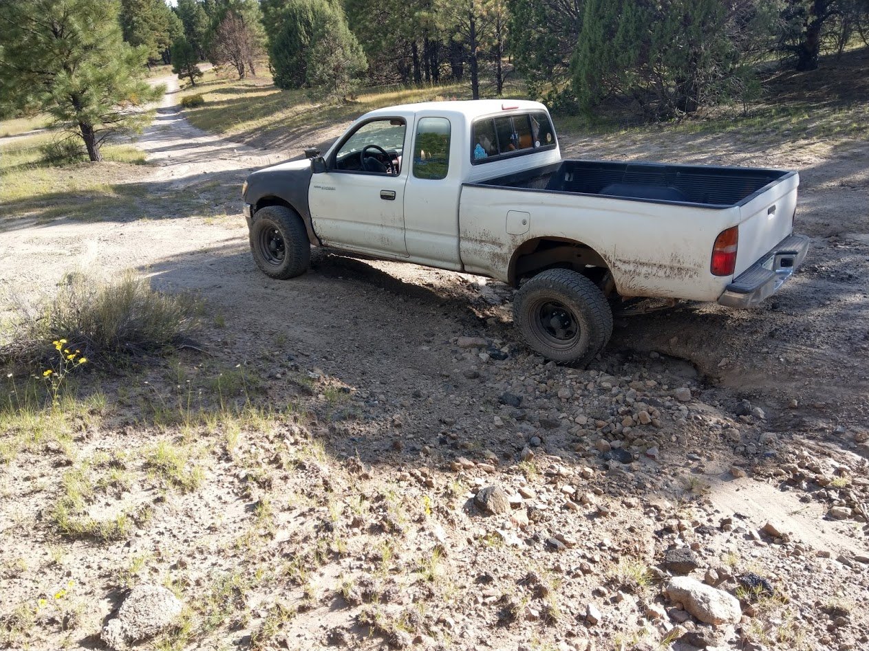

    Dayum, what have my fellow 5 luggers been up to? this place has been dry with updates. I got my Yota out and stretched her legs for the first time in a bit. I might get some 32" tires soon the fronts are pretty damn bald and i want some more height. I also need to get some new shock mounts welded up. i only have 3" of uptravel with my 10" fox resis
    e2mLPCcMff0zeeCVvAmi-kTYkHOqZfTt5eeCB95y_1b4ffc7bcc192baa9364c458bf53b072004528e4.jpg 1YHjUkc1_RCvlkuxmptSTMQIDfTBVDho8pgz53LS_22964df0f83f7aab591b9299905adae4e16f0701.jpg trj5pvtqHZ_HL-knGOtnEdetyIsIXrt6Pdq_oWP6_2dc90cb00e0663ebe3553f58ce25633e7b423327.jpg

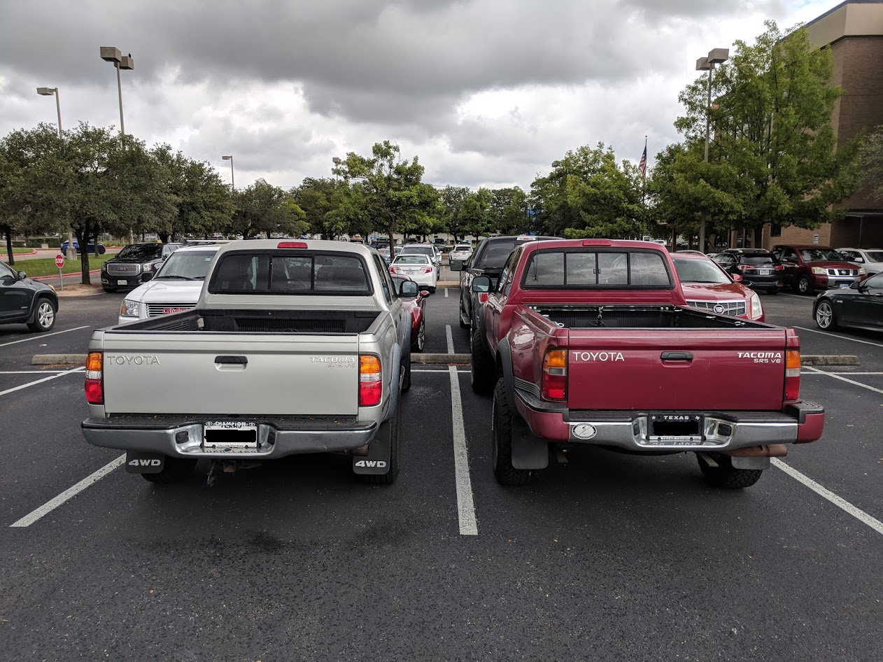

    No updates since I posted last. I have just been enjoying driving it tbh. I was able to snap a photo at work the other day, though:
    Pretty proud I am taller than stock pre-runner/4x4s !!!

    Hows the rack from front to back?
  6. Sep 24, 2018 at 2:50 PM

    It has about 1/2 in of lean rather than rake with my current setup. I plan on getting some 1 inch shackles at some point to get a good rake going.

    Do you have measurements from hub to fender?

    I just whipped out the measuring tape to get a quick estimate. I would have to remove the wheels to get an accurate one. It was ~22-23 inches from my rough estimates, though.

    On the rear? What about front

    They are both between 22-23. I don't have exact measurements at the moment. Sorry.
