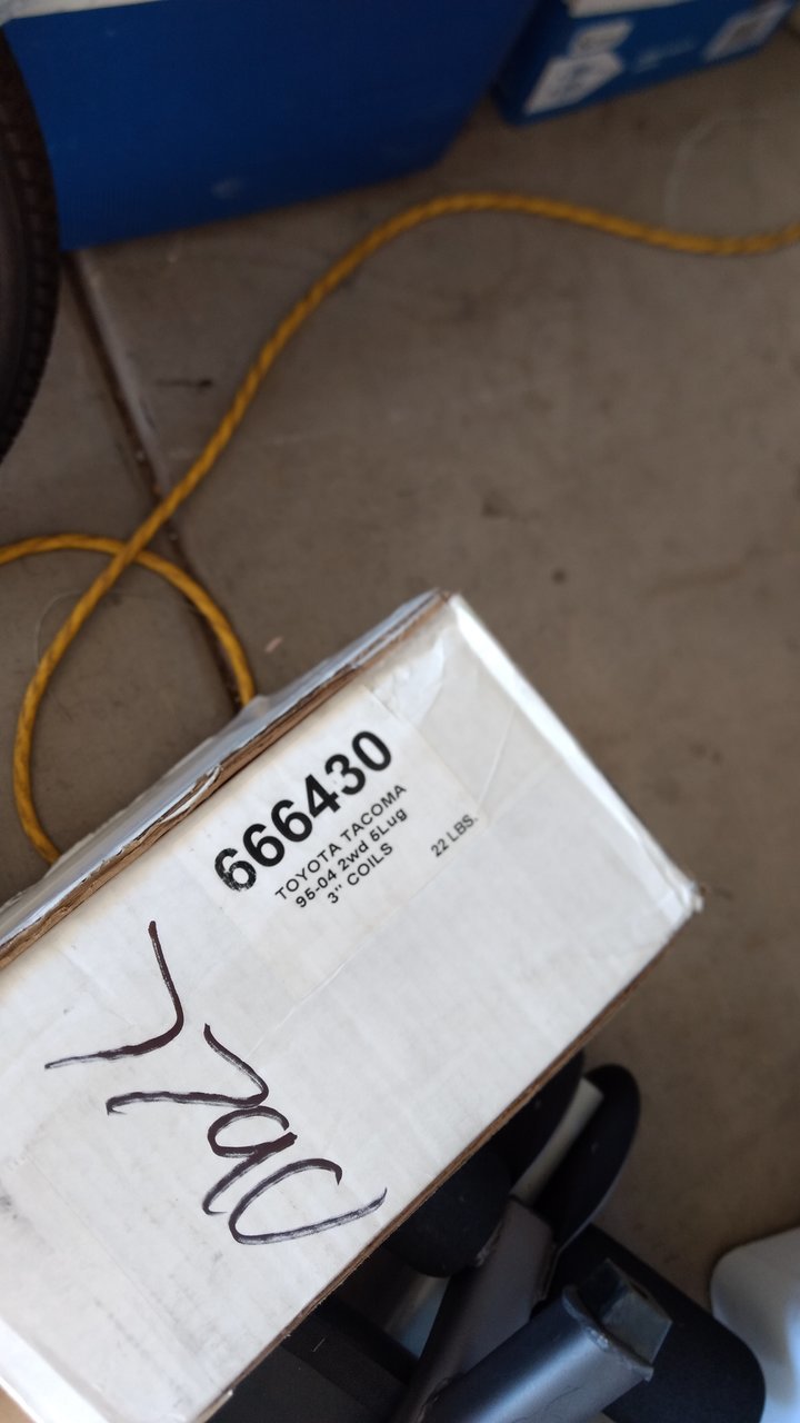

    Springs still in box

    Are you going to get those coilover?
    Putting the upper arm on alone will actually lower it

    yeah i am, the order is processing still. im pretty excited, once these are on i can finally get my wheel aligned. ill post pics once i start the build process.
