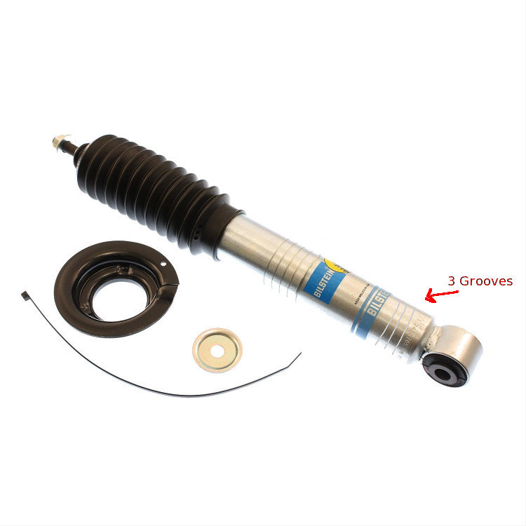

    I have been toying with a few ideas for mid-travel myself. What do you think about this one?
    1.) Convert lower control arms to use the coilover plates sold on streetacos.com
    2.) Get Bilstein to re-groove the 2nd gen Xterra/Frontier Bilstein 5100's at the bottom of the shock body.
    3.) Use appropriate coils, bushings, cross shafts, etc.. for new setup
    I actually emailed Bilstein today, and they said it's $10 / groove, but you have to buy the shocks elsewhere and send them to their Cali location for service. You also void your warranty.
    The ride height adjustable 5100's for the Frontier/Xterra (24-187053) have the following travel specs:
    Extended Length: 15.26"
    Collapsed Length: 10.55"
    Compared to the Fabtech FTS-7078 shocks I am currently running:
    Extended Length: 14.30"
    Collapsed Length: 9.52"
    I think the one inch difference would be manageable, especially with a lift and relocating the coil spring perches lower. This could be a much cheaper solution than coilovers if it ended up working out. I am still trying to figure out the specifics, like whether or not you could find a good coil spring for that kind of setup and the right bushings for the lower shock eye. Here's a photo of what I am talking about:
    I guess the overall goal is to make a "similar-to-downey" setup without the downey coil and lower arm.

    That looks like it would would well enough i just personally dont like the digressive valving of Bilstein shocks. The one thing im worried about with new shocks is the entire inch less ill have of compression
