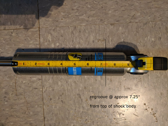

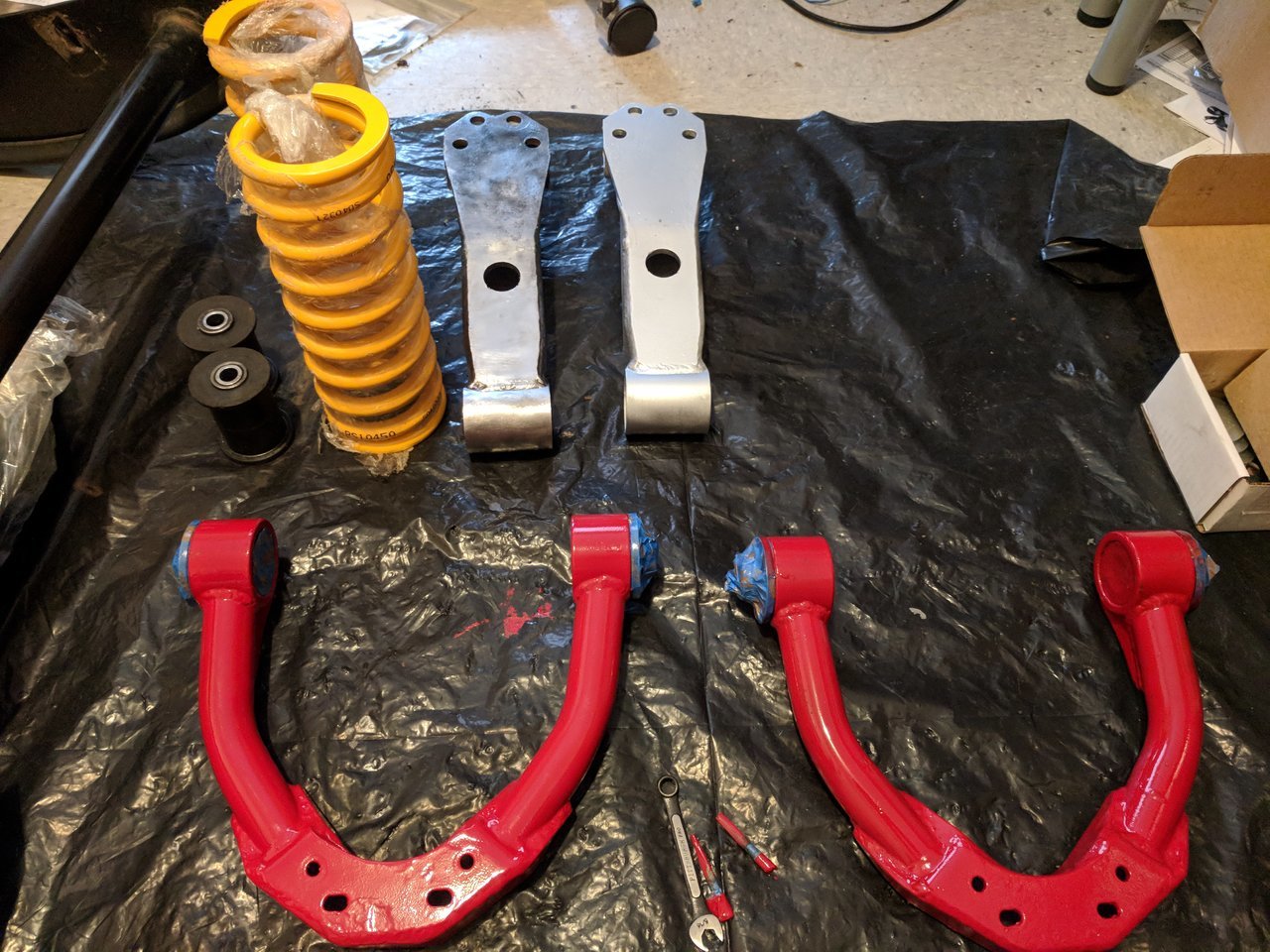

    @TacoBunny, I pulled the trigger on those Allstar coilover sleeves and my 2nd gen Frontier Bilstein 5100s idea. Thanks once again! I have been reading miata and supra forums for weeks now... lol.
    I ordered the TC cross shafts, also. I am in the process of sanding and painting the control arms from the used kit I bought. I also found some cheap coils on ebay that I am going to give a shot, though they may be too low of a spring rate at 450#.
    It may seem silly to some to paint these parts and make them look so pretty only to get them dirty and banged up again, but I was more concerned about the corrosion that had set in already. I had a little fun with the color scheme, I know! I have added years back to them at least... sweat equity.
    I am about to send the shocks off to bilstein to get them regrooved for the coilover sleeves:
    I probably wont ever go long travel. My plans are to swap in 4wd tranny and do a SAS front-end eventually. I just want the added height and offroad capability in the meantime. I am not looking to do anything high speed like jumps or anything.

    I noticed that too. I doesn't even look like there would be enough clearance for the stock shock setup with eyelet and t-bar. Maybe just bad photos? Some sleeves or bushings and longer bolts that sit on top would work. Other than that drill/cut a hole in the middle of the boxed plate so the eyelet can sit a little below the arm.. like the streetaco plates have.
    My truck is red, and I also had some red primer left over, so the decision was made for me. As far as the springs go, I had to talk myself into yellow, but that price had a lot to do with it. I never would have bought yellow otherwise. The silver... well they were close to that before.
    It's going to be a few weeks before I can get the shocks back from Bilstein and then find some time to install it all. I am still trying to figure out the top mount part. I am not sure if I can omit using the top perches that came with the Allstar sleeves or not. I got poly spring seats just in case. If I use the perches, though, then I have to put a bump-stop inside the coil to keep the upper perch from smashing on the top of the shock body (I think). I would lose about an inch of compression that way. I also may have to space the top perch away from the coil bucket mount some to keep it from coming in contact with the upper coil bucket. I am really not going to know until I get it all apart, which will be fun. It would def be less painless with a real coilover, since those come with all the top mount adapters you could possibly need.

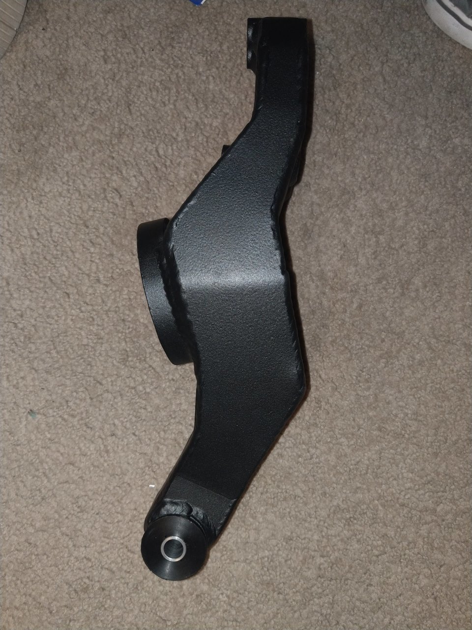

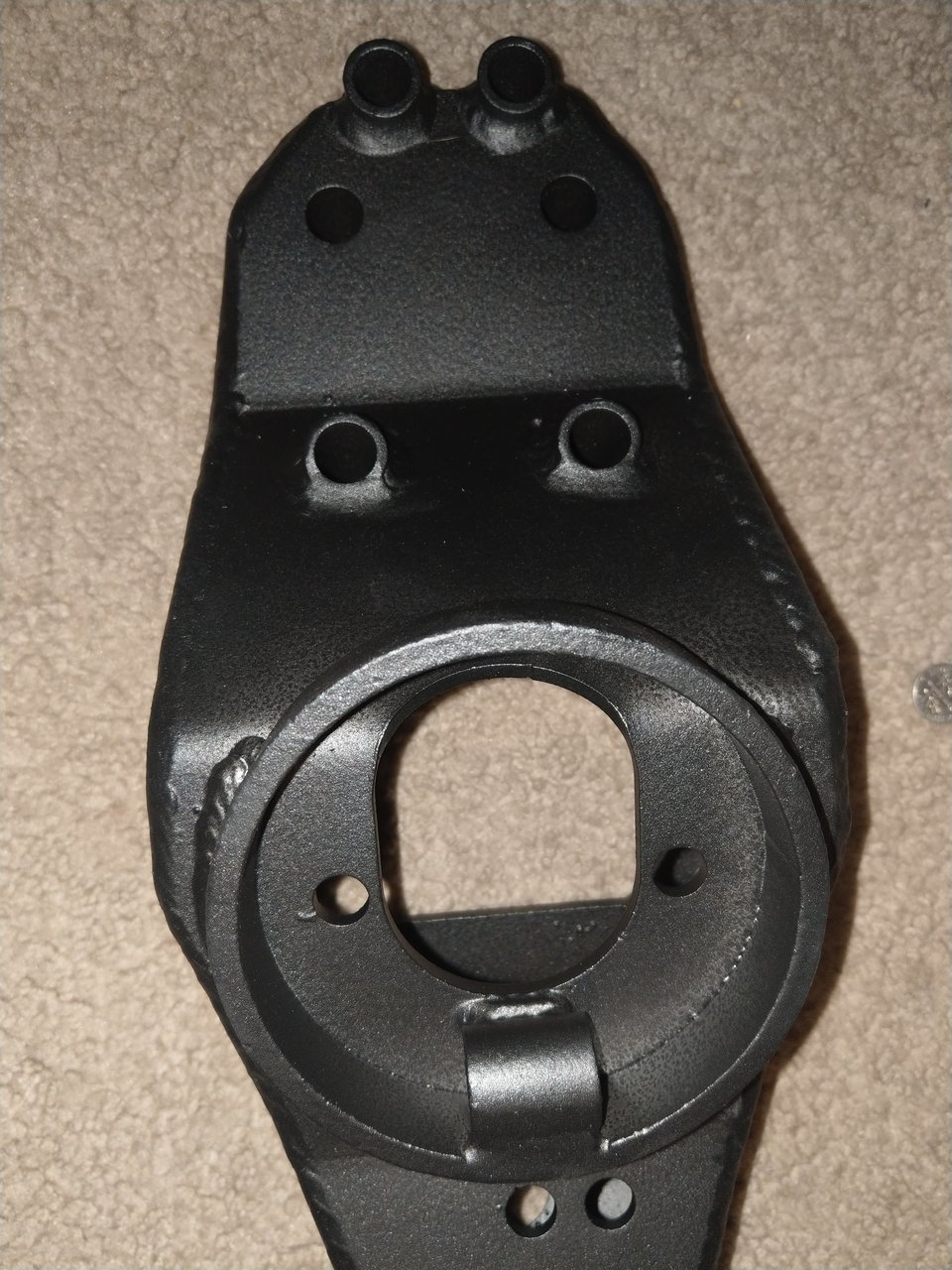

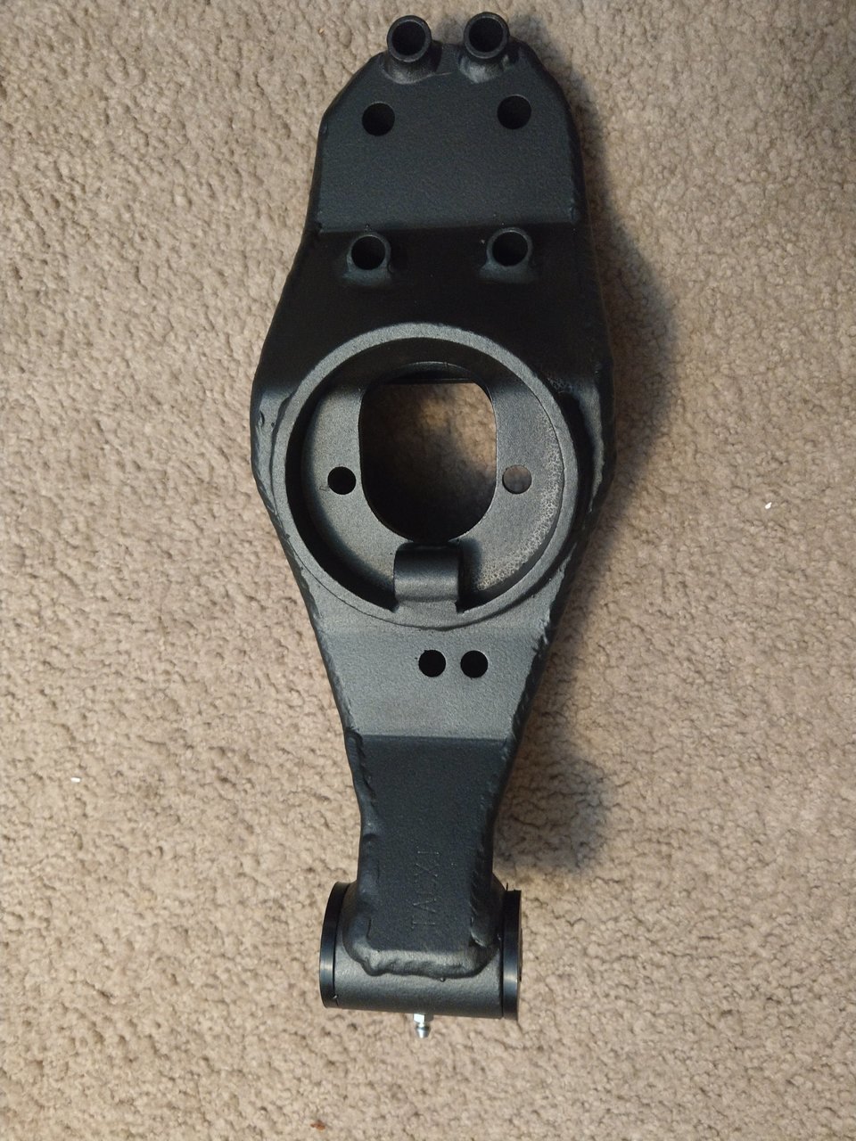

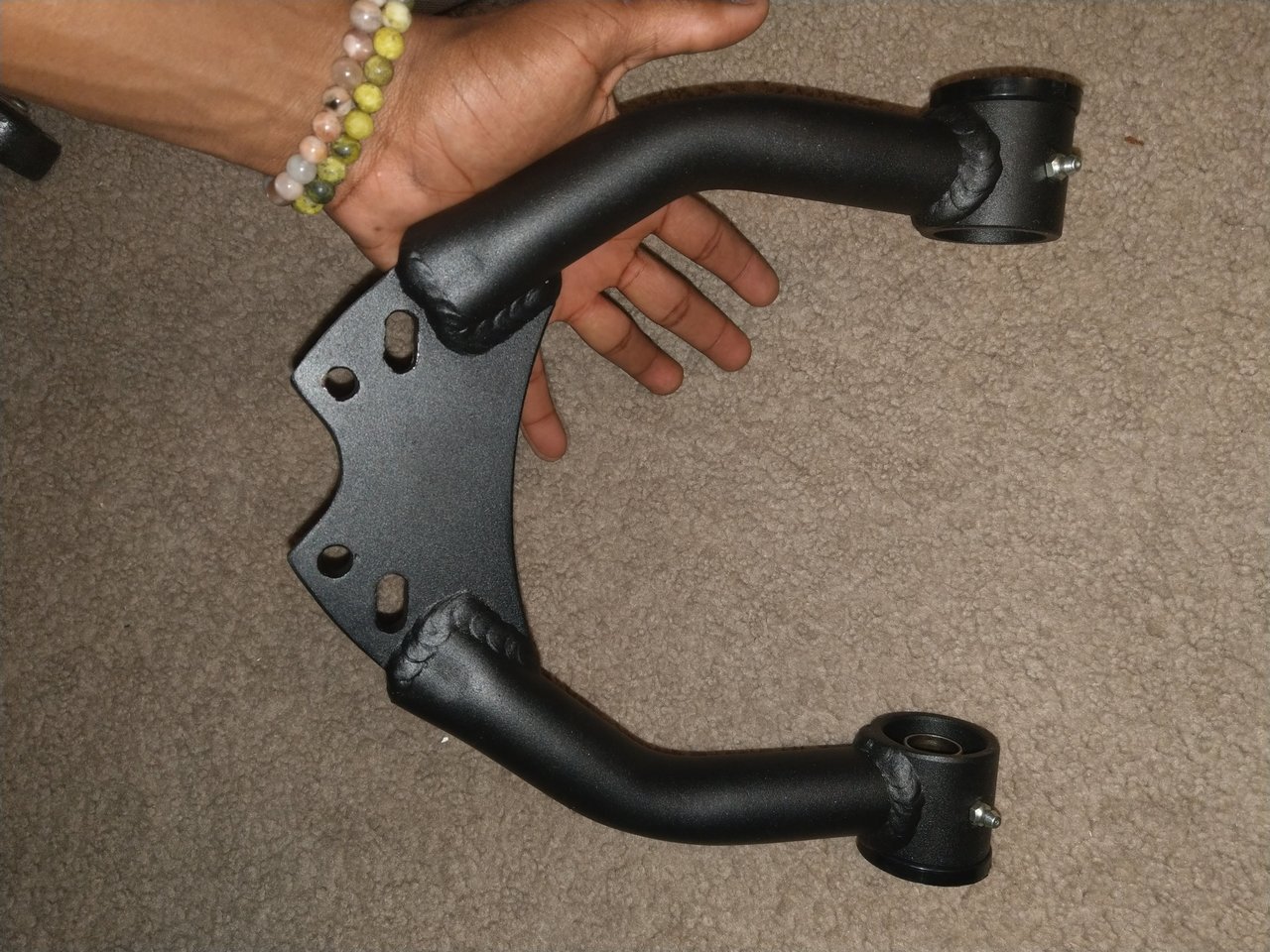

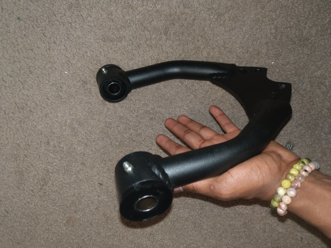

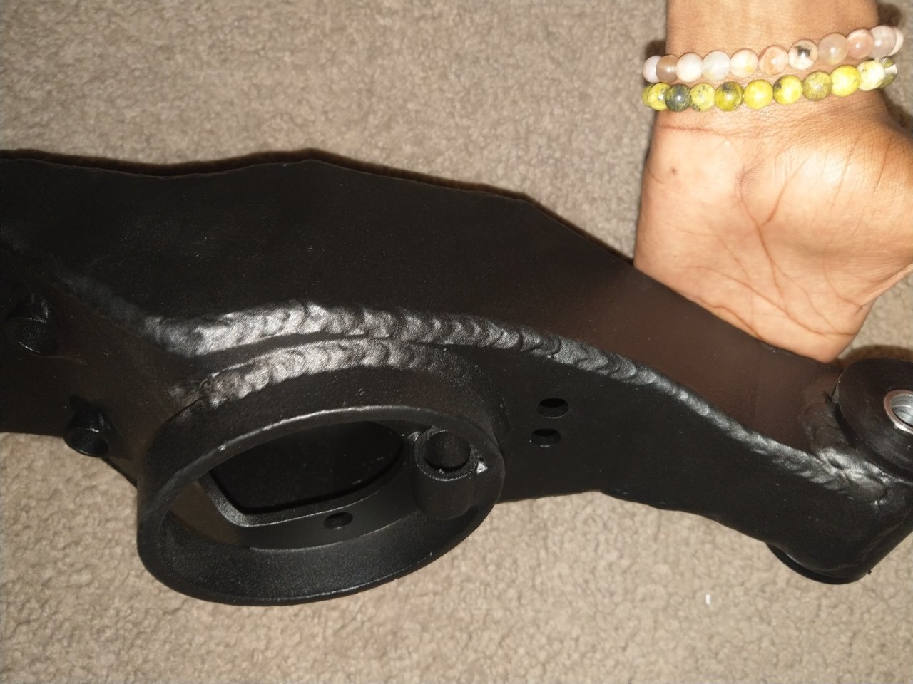

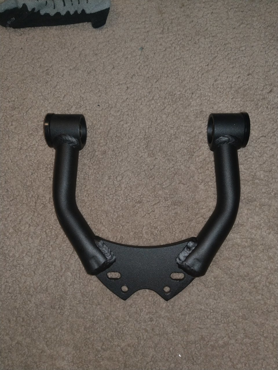

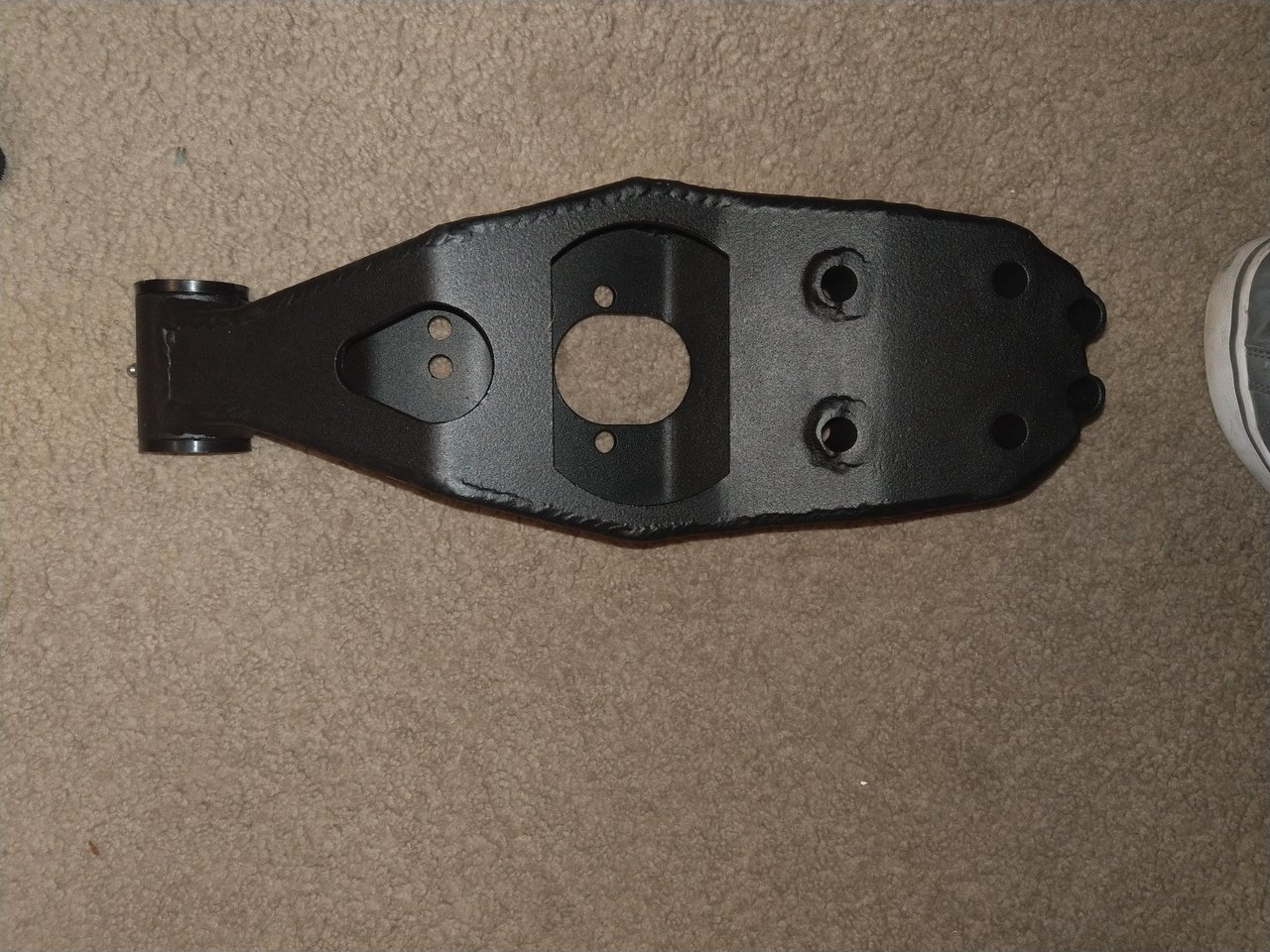

    I just picked up these bad boys today:militarypress:
    Theyre so damn beefy:muscleflexing:, theres no doubt in my mind theyre stronger than the stock ones. They do seem a bit longer than the stock arms as well so it may increase travel but im sure ill see some lift!:thumbsup:
    They claim 3" of lift

    Made by who?? How much?
    TacoBunny[OP] likes this.

    Its a local place in Mesa AZ its called AIRBAGIT i linked them in the very first post. I was skeptical about the kit but i pulled the trigger and from first impression i have no complaints! Decent Welds, boxed design, and full coilover options and i can even keep my original spring/ shock setup. i paid 900 for the kit but id say its worth it

    Its the company truck
    Interesting, were they designed for lift kits?? By the name of the company it sounds like its for lowering
