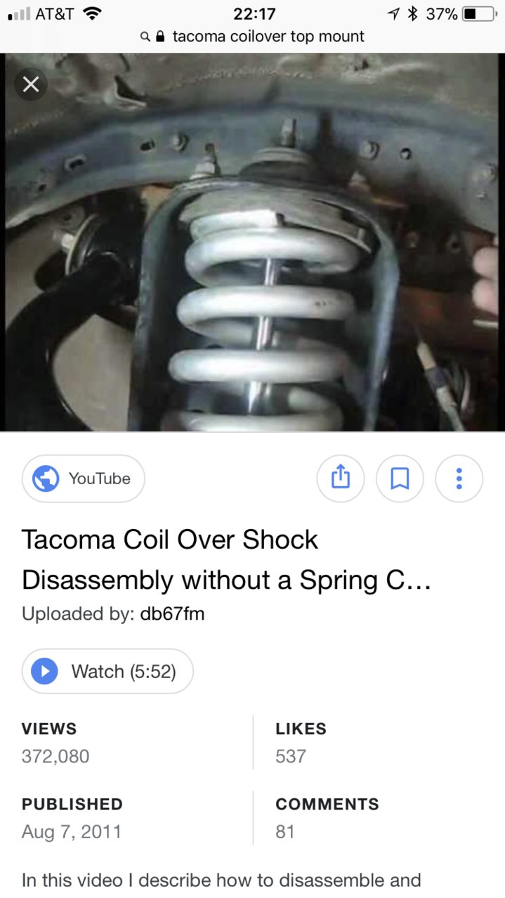

    But how do you plan on mounting your coil over on the top? Are coil buckets are designed to support a coil over

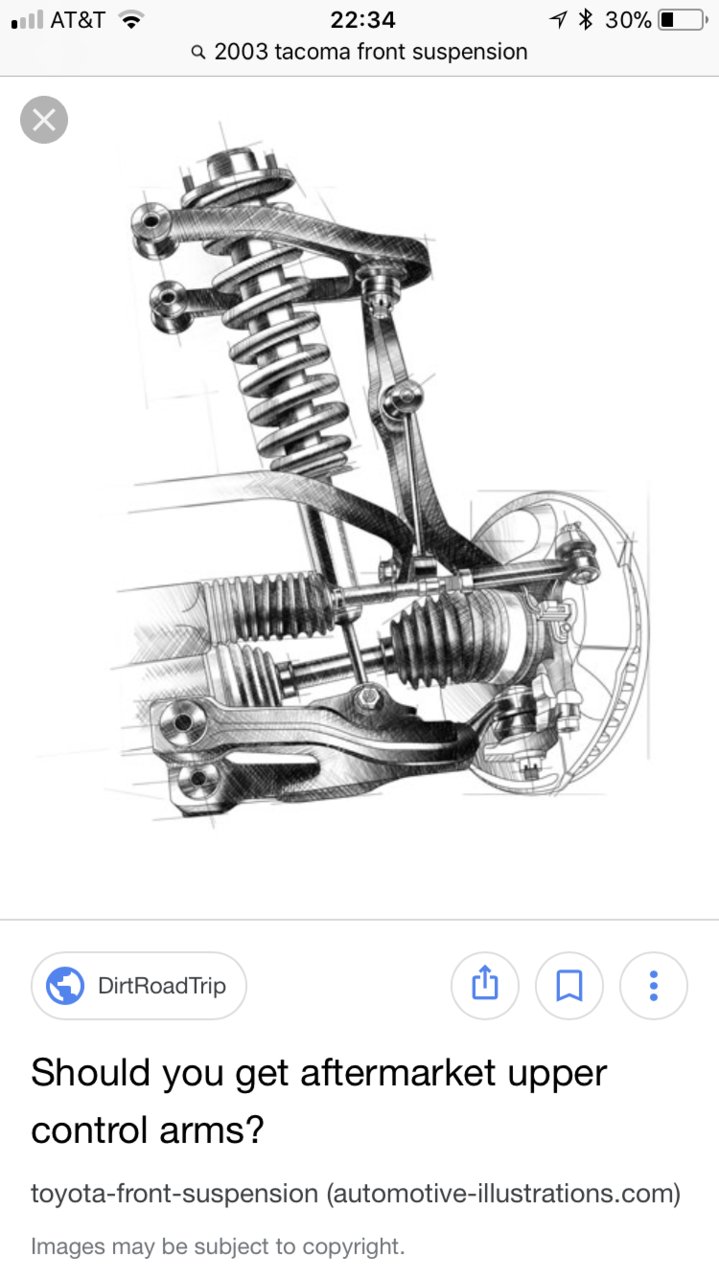

    Those lower arms... I get it now! It looks like they are longer because the strut rod has a separate mount. Your photos are much better... btw.

    The top of our coil bucket isn’t smooth, there is a ridge inside. Which will make it kind of hard to mount the top of a standard coil over to.

    Those work for are stock set up but not for a coil over

    This is how a normal coil over mount in a 6lug, nice and flush with the 3 bolts to mount a coil over and the center one for the shock. This is why when doing a LT kit you have to chop of the coil bucket to mount a different style. Also you do it cause it needs to be higher for longer travel shocks.

    You might want to just look into modifying a coil over spacing first. Would be cheaper that way you dont need to get actual coil overs. You also need to take in consideration that they don’t mount at a 90 degree angle. There is a set amount of off set to allow for proper travel.
