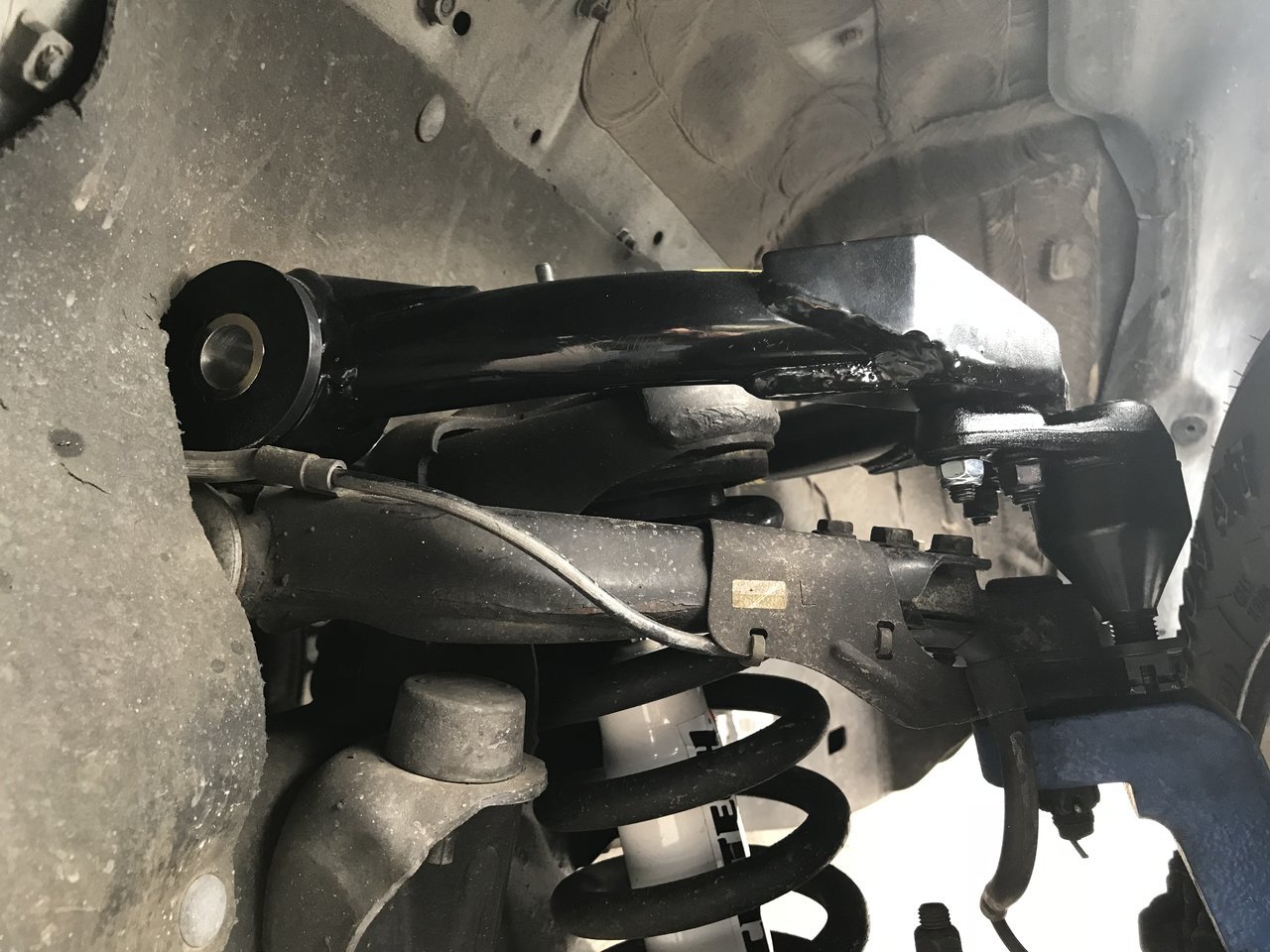

    Some progress being made, the supplied bushings have inner sleeves that are slightly larger than the cross shafts but not enough that there is play when both sides are booted downIMAG0076.jpg IMAG0074.jpg

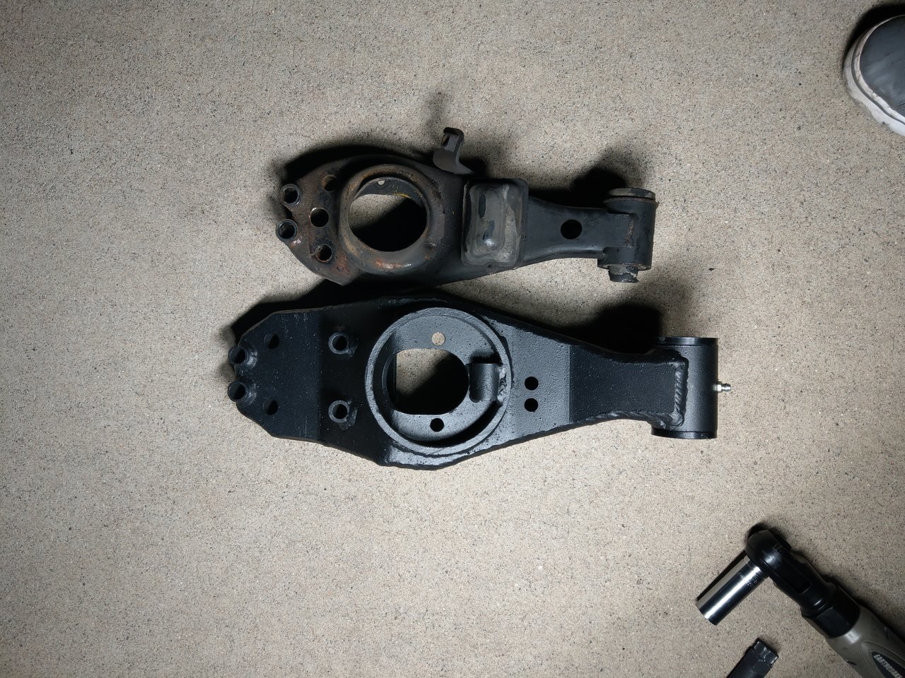

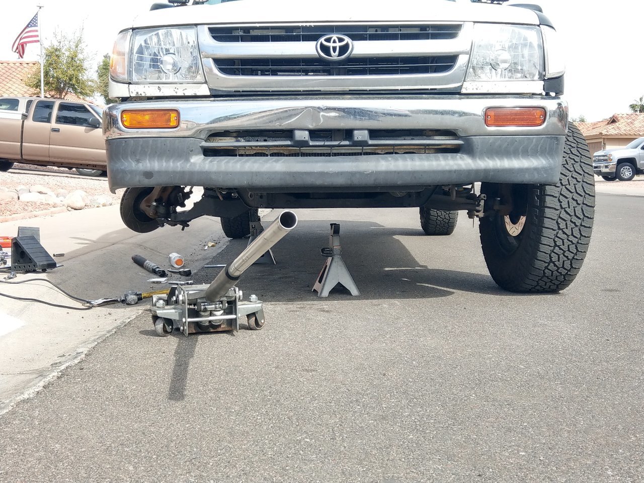

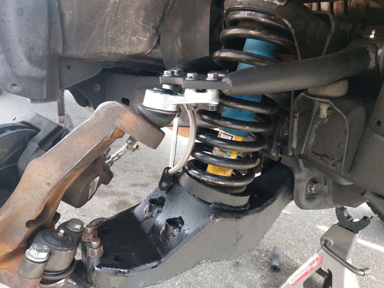

    So theres a HUGE problem with the HUGE LCAs, they cause an insane amount of camber and the tie rod is WAY too short. can anyone send me pics of the doetsch UCAS?? like ASAP... i was hopign the car up and running this weekend but i guess not. im extremely disappointed right now

    can you take pics of them next to your stock arms if possible? ill send pics of the truck rn

    The steering wheel won't even go straight without riding the steering stops I'm livid. This took so much effort just to get the spring on

    I should've stuck with the doetsch kit. Lesson learned 1k later lol. Sorry to get your hopes up but the lowers are the problem

    Goto my build tread and you can see how my current setup is.

    We're running the exact same setup aside form the shocks I've still got the billys

    It looks like you need longer ucas vs the ones they gave you

    yup, for sure but that still wouldnt solve my steering tack problem

    You would need longer tie rod shafts

    Should message the company that made them and ask what is all needed to work with the lift, seems like more is needed then just control arms

    It also looks like the lbj should sit on tip the lca not under, or use oem spindles.

    Try mounting the ball joints on top of the uca. May help a little bit but doesn't look like it will

    Is there a lift spindle for those arms? I know on full size trucks there are lift spindles and there are bracket lift spindles. And that company should have tie rods to go with those arms

    They only gave me the arms, they're getting returned ASAP though. I'm trying to be optimistic and hope the UCA and coilovers combo will be a good lift with a good ride
