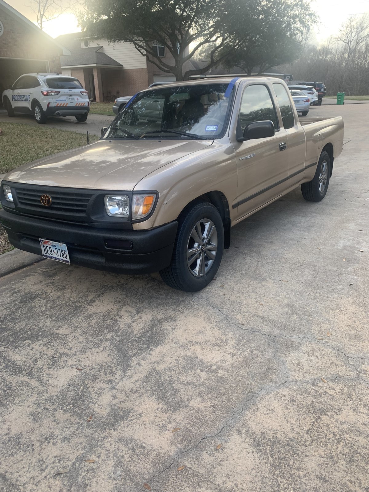

    1996 Taco 2.4L 2wd Automatic
    Clock Volt meter/LSPV Delete/Hyundai 16’s/FP gauge/after 9months of wrenching ZERO oil leaks
    Y’all probably saw a few threads on my progress with Son’s future Taco…….
    96 5 lug 2.4L
    Still weeks away from finishing getting veh mechanically sound.
    But started researching rim swaps away from 14’s Steelies
    Keeping eye out on CL
    After over a week of measurement data collected

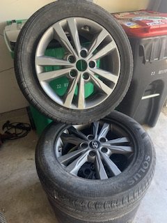

    I pulled trigger on 14 Sonata rims

    $100
    Tires are trash mind you

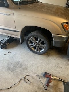

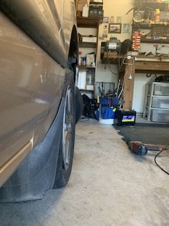

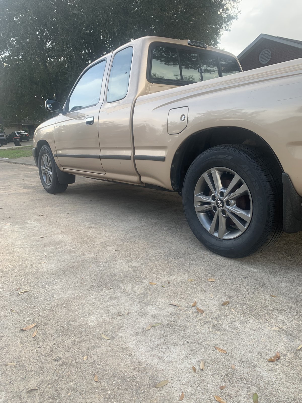

    IMG_3332.jpg IMG_3329.jpg IMG_3330.jpg So kid and I are cleaning interior this weekend
    I couldn’t help myself
    Had to test fit to see how (bad/decent) rims fit
    Holy Crap
    I can’t believe the result
    Complete bolt up swap…..same lugs fit….even center caps on front fit and clear spindle dust caps IMG_3327.jpgIMG_3328.jpg

    I’m sure I can clear 225’s!!!
    thanks to all that replied to my Q’s and helped
    Took alot of searching/documenting
    I’m beyond impressed with results
    Hope this helps someone in future!

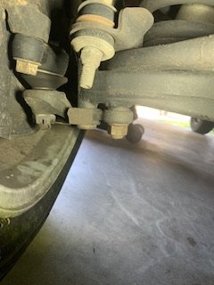

    I sought out the ET25 Jeep rims out of concern for upper ball joint clearance, which looked tight with the 14”s, but your pics show that the 16” ET50 Sonata rims are large enough to clear OVER the ball joint…nice! And the Sonata rims are much better looking than the kinda clunky Cherokee wheels…

    Dustem
    Thanks man!
    So to answer your Q’s
    -205 55 r16 are the trash tires from pix
    If those size are mounted, will definitely clear frame/bumper/dog leg of fender
    Now I’m going to go bigger, but nothing crazy
    Once I make mechanically sound/save up some tire $$…..will surely update
    Hell 15yr old son has won $180 in fantasy NASCAR after the end of second segment….he might have to toss something in the tire pot!
    (Wheel bearings scheduled wrenching this weekend)
    IMO 235’s will be pushing it
    -yeah I ran into a site that had legit measurements of a 15inch Toyota stock rim….knew that fit….went with that for data. With all my hours of searching, couldn’t find stock ‘legit’ Steel measurements

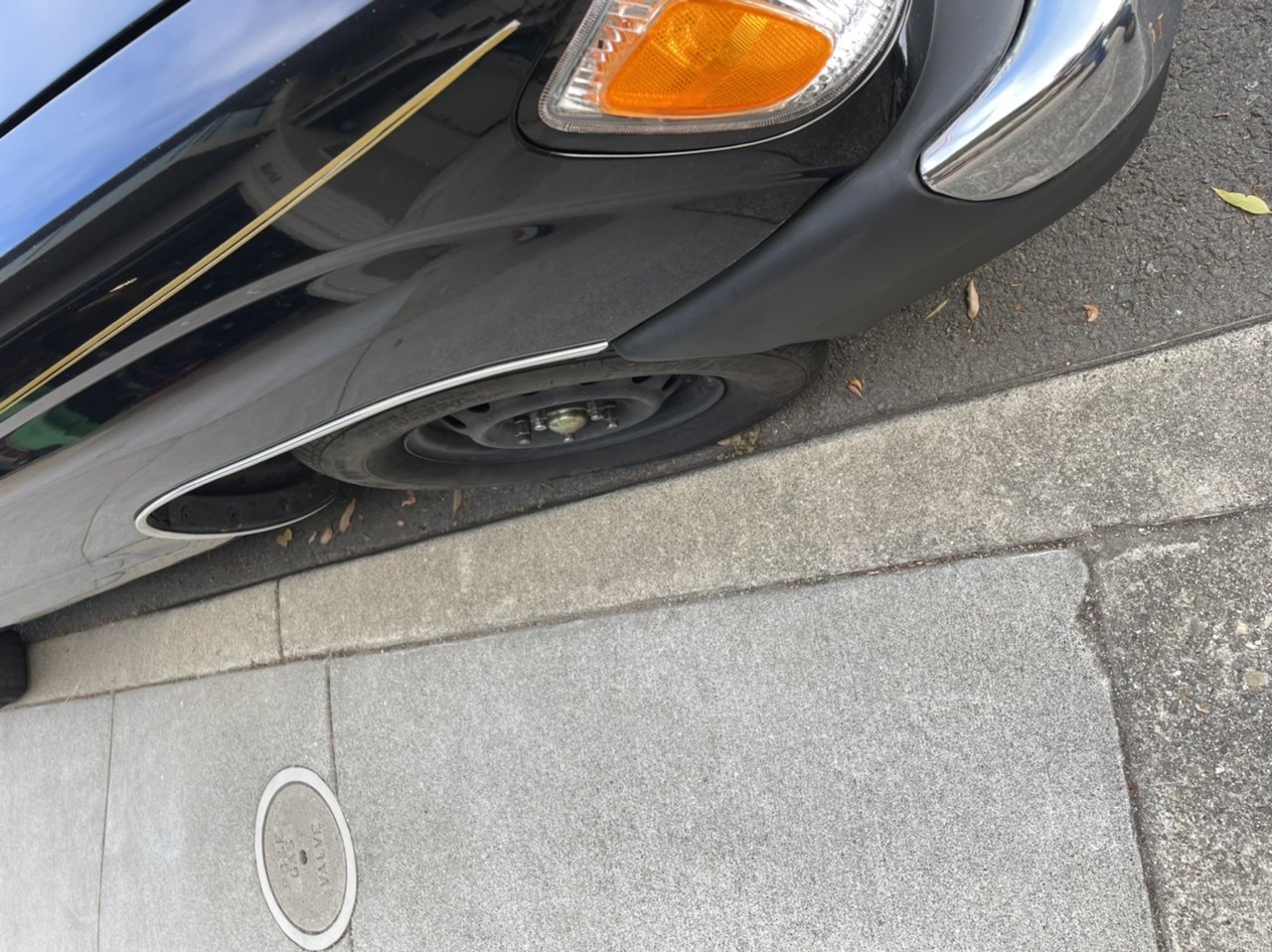

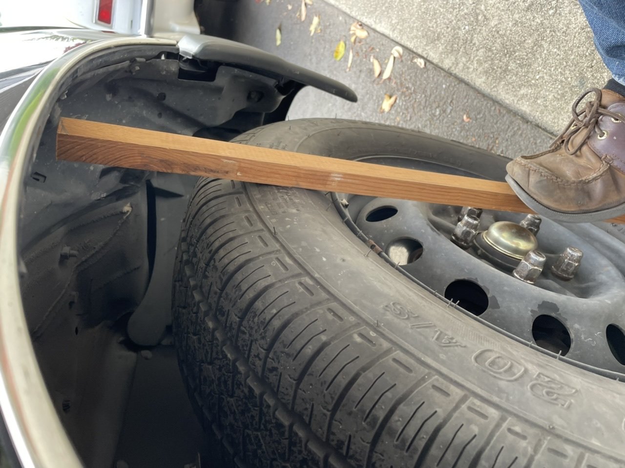

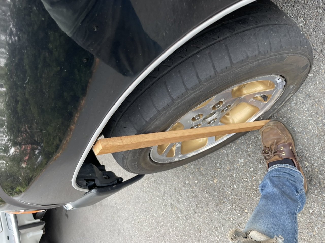

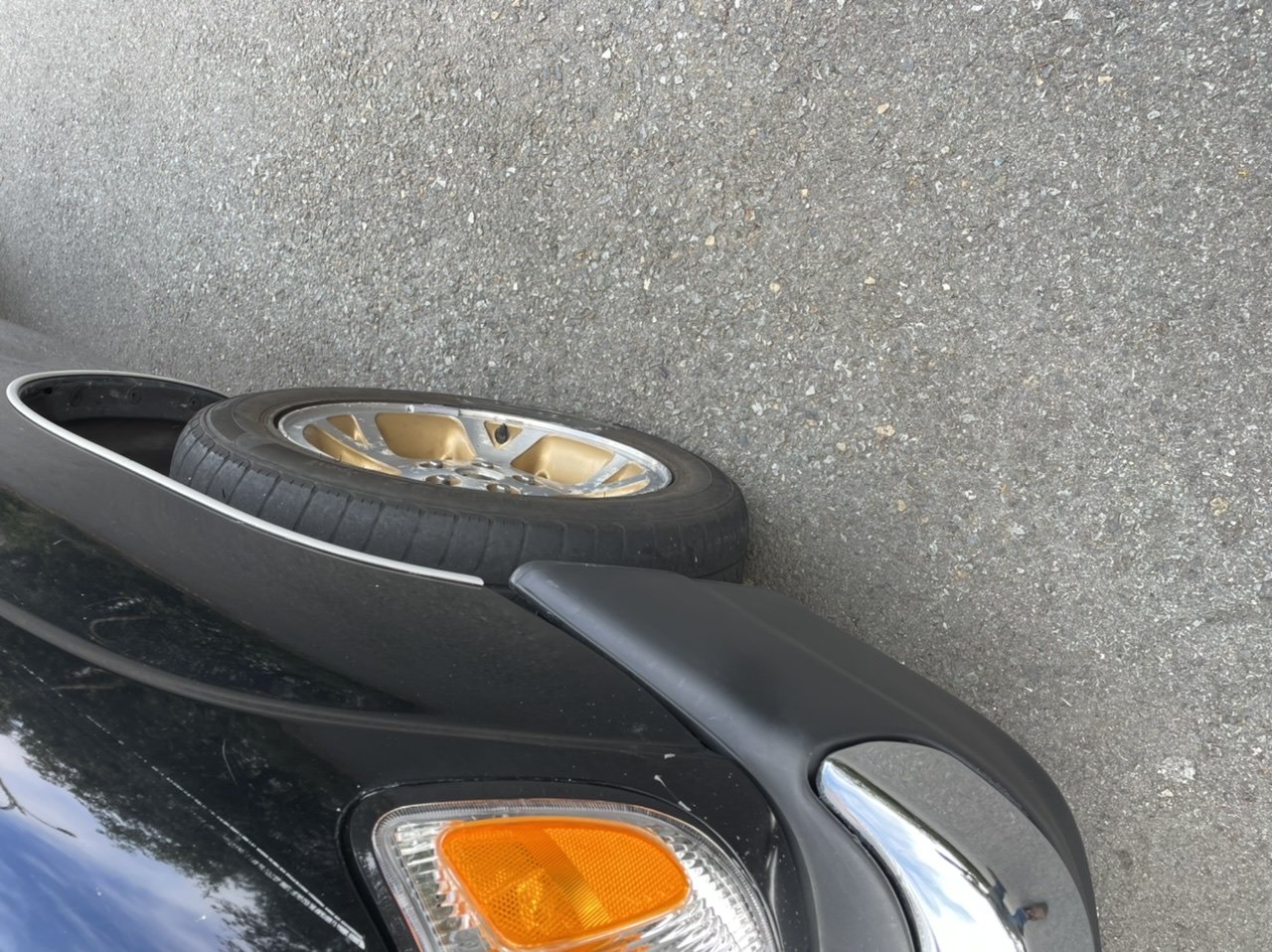

    Well, I found a 215/55-16 tire for one of the Cherokee rims (16x7, +25.4 mm offset) to check for clearance.

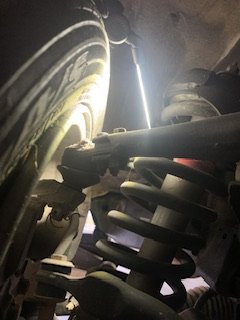

    That tire is almost identical in height to the stock 195/75-14 on the 14x5 +34mm offset Toyota rim. . Attached are pics comparing the two combinations installed after a ride around the block to settle the suspension.
    Not great; my high-tech tool (old growth redwood!) suggests insufficient offset; might not hit the fender at stock ride height, but I’m planning a 3” drop.
    Backspacing works out almost the same on both rims and clears the upper control arm ball joint by over an inch, so a 16” (or 17”) rim with more offset will easily fit and tuck the tire in for enough fender clearance.
    Back to Craigslist!

    pulled trigger on these for a hundo
    BTW
    I still wasn’t 100% positive on off set….everything else was a match
    I went to Discount Tire….fed guy at counter a story(wasn’t going to buy anything)
    He plugged those measurements (hand written pix) into his computer
    Said that Sonata 16’s would fit/clear NP
    He wasn’t sure about caliper clearance.
    Took a chance for $100
    Can’t believe how good they fit/clear
    -center caps fit over front dust caps
    -steelies lugs fit as well
    hope this helps brother!

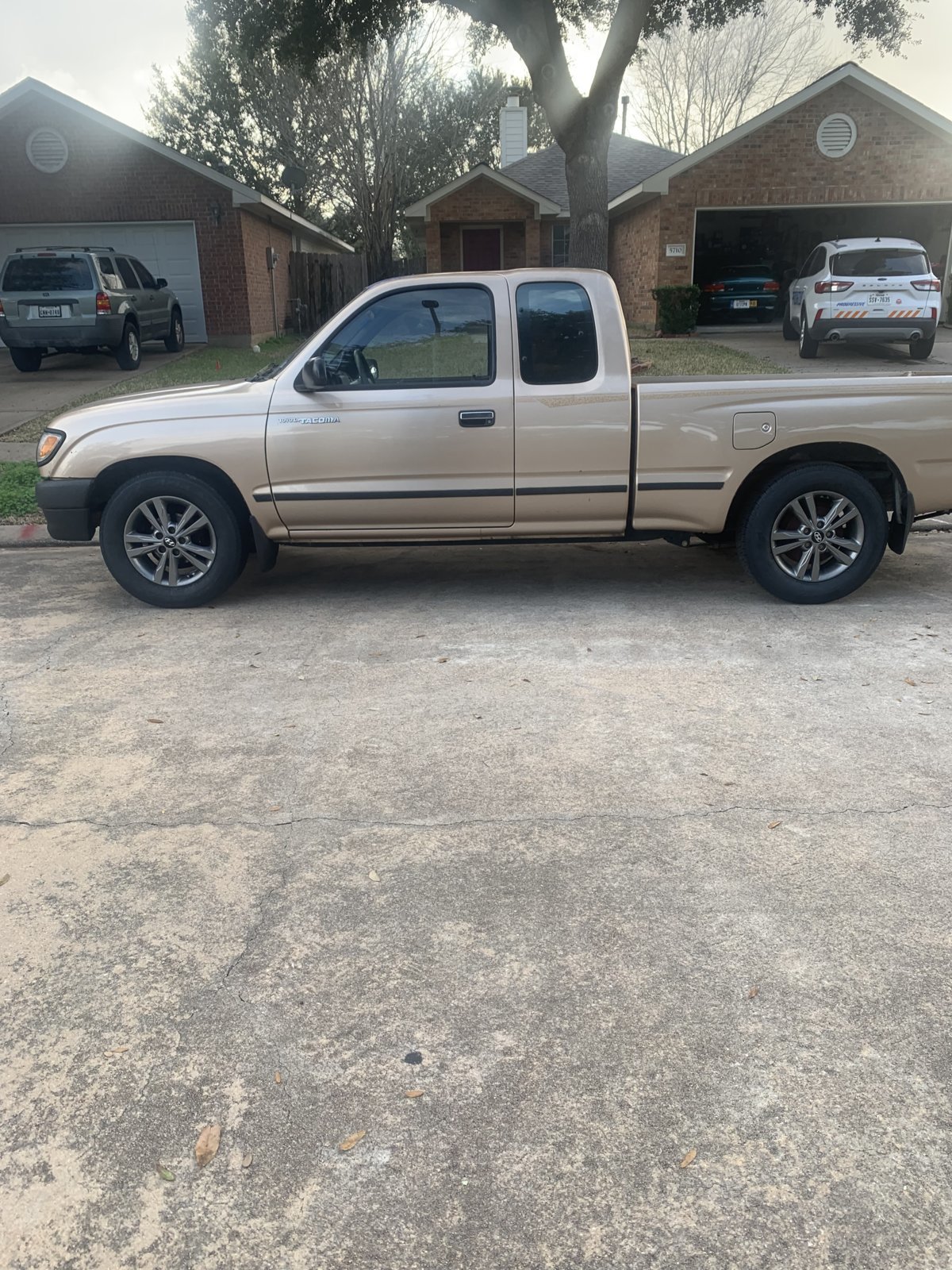

    Tah Dah!!!!!!!!!!!!!
    225 65 R16
