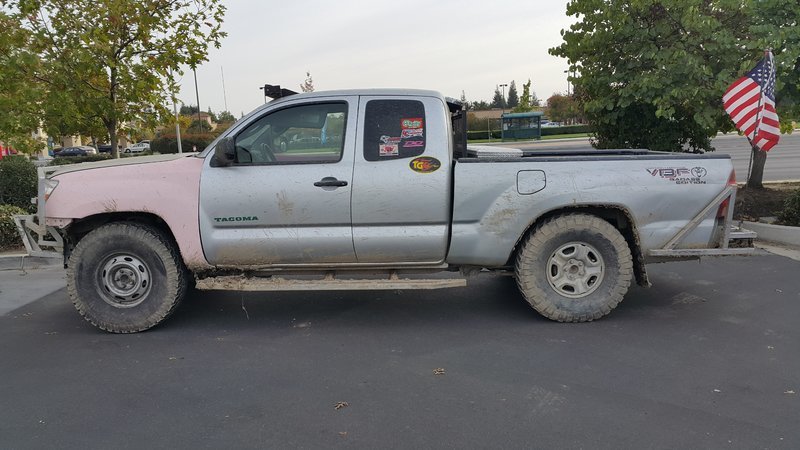

    3" blocks up front, no lift in the rear, 33s with 4.56. Rubs like crazy, hits bumps every time I jump it, but the increased ground clearance is worth it.

    Where exactly are you rubbing I'm running a readylift lift and eventually plan on going 33's

    Thank you.
    Well I removed my splash guards, but I rub on my frame either side when I turn full lock. It rubs on the upper arms a bit as well.
    Just re gear if your gonna run 33s, mine felt gutless with stock gears until I went to 4.56 and e locker.

    Have you trimed any frame yet? Also which lift are you running Ive heard of someone using two different spacer lifts to clear 33's... Great points especially with the regear and e locker as well. It must be a fun truck

    No, I haven't trimmed anything at all, just getting rid of splash guards. Just regular strut spacers I got from Amazon. Yeah if I kept the splash guards the 33s would've chewed them up. If you look at the picture, they completely take up my whole wheel well.
    Lol yeah it's quite fun especially it allows me to follow the other tacos when I got to meets.

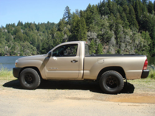

    Not mine, but you can see how freaking tight it is in there, haha

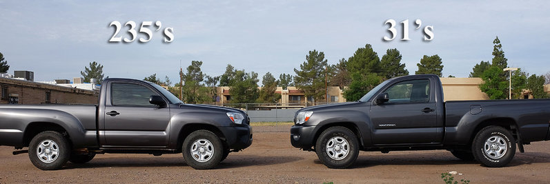

    Here's a better picture with a comparison. No lift on either.
