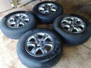

    I just picked up these Highlander 16" alloys used and now I am shopping for some new tires. Any suggestions?
    My original Taco rims were the 15" steelies and tires were 215/70/15.
    I don't offroad but I do a lot of highway and country road driving. I was thinking of getting tires a bit bigger but not too big because I like my fuel economy (25mpgs!) and accurate speedometer.
    According to the tire size calculator, the closest match to stock would be
    215/65/16 but I was thinking perhaps 225/70/16? (lots of choices in that size)
    Also, any recommendations on the tires? I've been looking at Yokohama Geolandar H/T-S and some of the Goodyear fuel efficiency tires (Assurance Fuel Max) but don't know if the latter would be appropriate for a light truck?
    Finally, anyone have TPMS issues with Toyota alloys? Not sure if these rims have TPMS sensors in them? I don't like the idea of buying new sensors so I may just go without and disable the dash light?
    Thanks everyone! It's been hard to find info on 5 lug wheels/tires.
    Brian

    Thanks for the responses!
    ISUGrad, I got the rims from Craigslist for $200! I've been looking for a couple of months searching CL with the phrase "Highlander rims" and "RAV4 rims". I'm realizing there are some complications though. I just ordered new lug nuts and I didn't really do my homework on other stuff like TPMS. It appears that I will have to disable it or find another work around because I'm not going to pay for new sensors (I'm not sure if my steel TPMS sensors will work in the new alloys).
    As for tires, I'm having internal conflict with keeping the stock overall diameter the same - 215/65/16 or going up to something like 225/70/16. The only thing holding me back from going bigger is the pretty good gas mileage I get (25 mpg).

    I ended up going with Michelin HydroEdge 215/65/16. My fuel economy has definitely taken a hit down to 23.5mpg (although that could be winter gas?). So I'm glad I went with the smaller tire. I'll admit, it doesn't fill out the wheel well as much as I would like but its fine. But now that gas is approaching $4/gal in Cali I'm glad I didn't go with something bigger.
