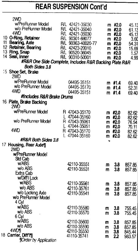

    I don't see any differentiation in my 95-00 parts list, so you're looking at the same part - 90310-50006. Part 14 in the diagram below.

    Weird, I thought the same thing/was confused at to which seal it was in the diagram, but then looked at the image (below) of the parts I have in my 6-lug Replacing Rear Axle Seals tutorial, and the part number on the Toyota bag is 90310-50006. Matching that up to the parts diagram, 90310-50001 was replaced by 90310-50006, which is why I went with part #14 in my answer. :notsure:

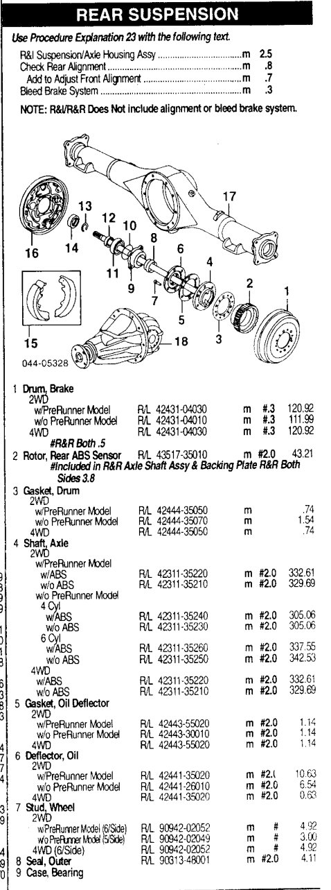

    See my last note above. 90313-48001 is definitely the outer dust seal, not the axle seal that leaks.

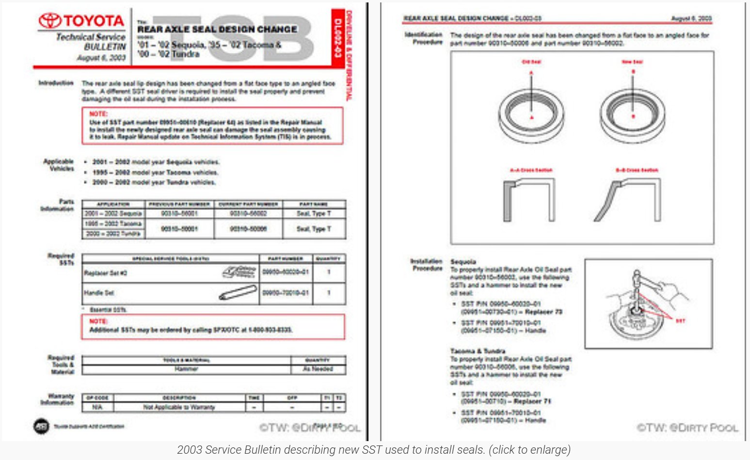

    Here's the Toyota TSB that discusses the change from -50001 to -50006, and it's obviously the part we're talking about:

    @O'Silver_Taco - not sure if we're talking past each other. I though OP was asking about the inner seals (that press into the housing), since those are the ones that folks generally need to replace when they notice a leak.
    At any rate, OP now has part numbers for both. :thumbsup:

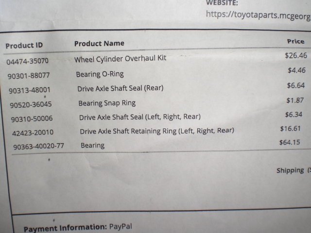

    Brain fart......I could have it backwards......have a 98 and here's all the parts for a non abs one if you do the whole thing..
    minus the wheel cylinder kit...
    went back corrected my BS...
    If you have abs you have to have a second drive axle shaft retaining ring and snap ring...
    Like I said its definitely good to replace that inner one....before it causes a butt load of pain...
    The new seal will ride in a slightly different place because of its redesign...
    its worth watching the timmy videos thoroughly.....
    A lot of the 4-runners are leaking after the new seal.....hence that TBS they released above....
    If you have a pre 2001 I'd get the older seal if you can.....O'timmy dont tell that in his videos...
