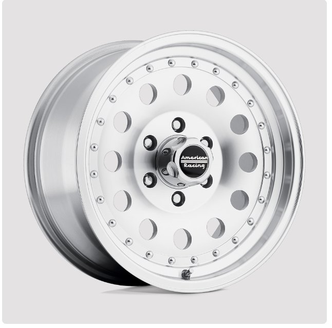

    I'm just seeing so much information I'm overloaded. I really like the look of the simulated beadlocks on these wheels. They have the correct Wheel Size: 15x8 and correct Bolt Pattern: 5 on 4.5. .
    But I heard that steel wheels rub the calibers, however the ones linked have a 3.75 backspace and a neg offset of -19. I saw someone mentioning that clears. Does that clear the calibers? Also, what makes it to where steel wheels rub calibers and not others?
    If that does not work, what do I need to be looking for when it comes to finding wheels that will bolt on and work no issues?
    Anyways, going forward once I get wheels that work, I was going to go with these tires and take off those black boxes and call it a day. Any issues with this?

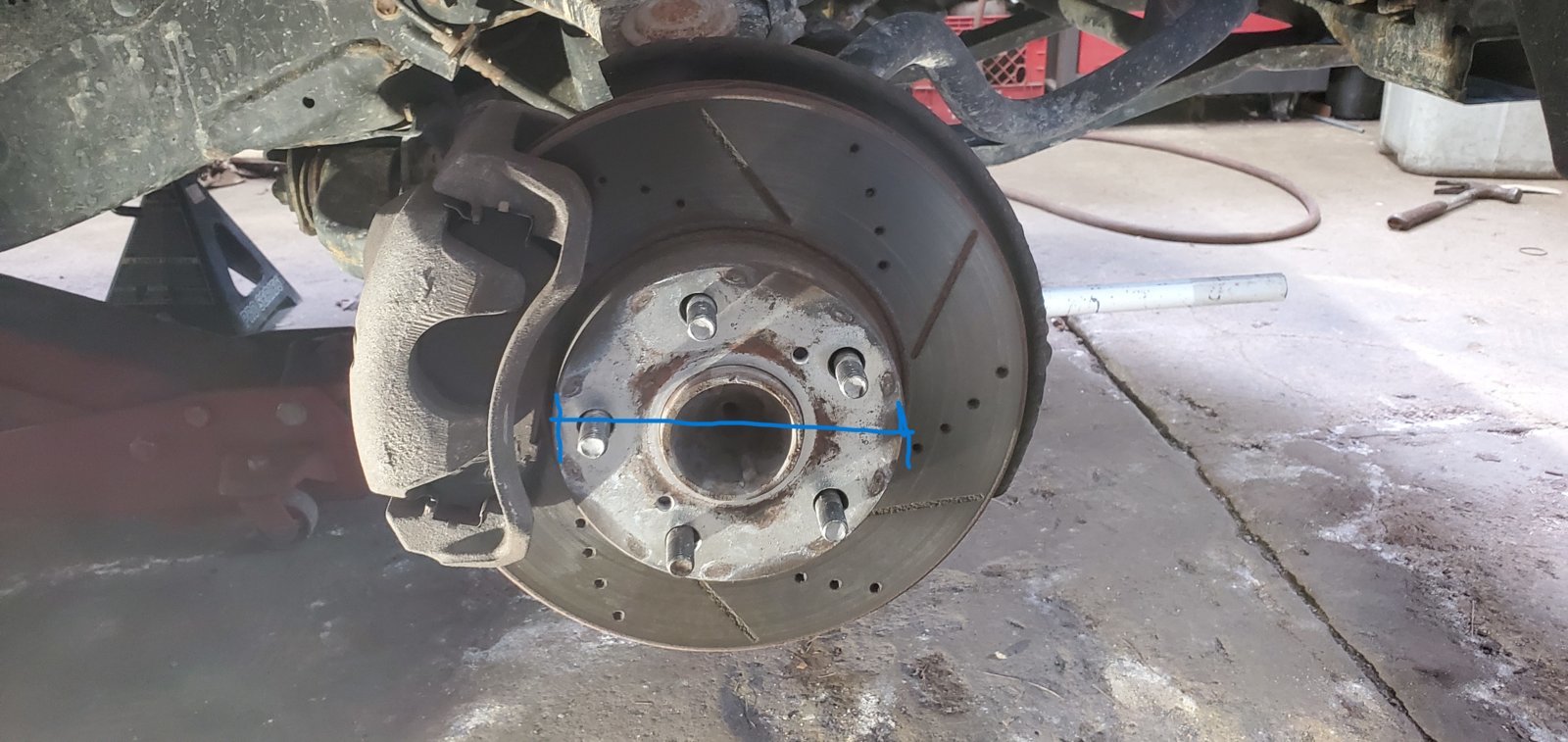

    I'm no expert on this, but I think the biggest issue with getting rims to fit (with a reasonable offset) is that the mounting surface of the rim can't be much larger than the mounting surface on the disc rotor.
    For example these rims will not fit without a spacer and grinding on the caliper.
    These two blue lines need to be close to the same length.

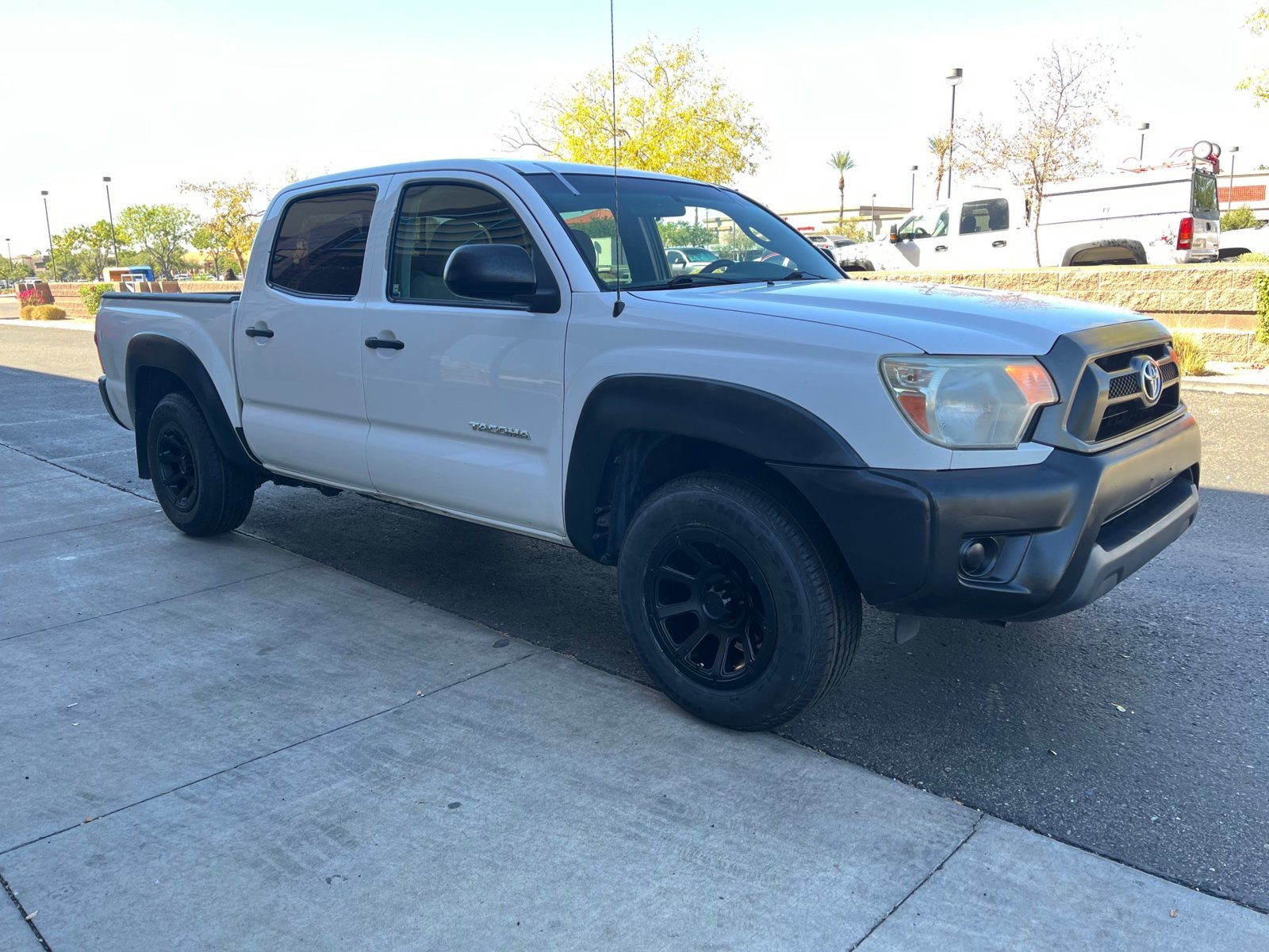

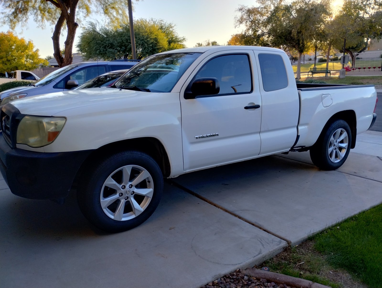

    RX 350 wheels fit with no modifications and can be found cheap.IMG_20231207_164300144_HDR.jpg
    ireymon likes this.

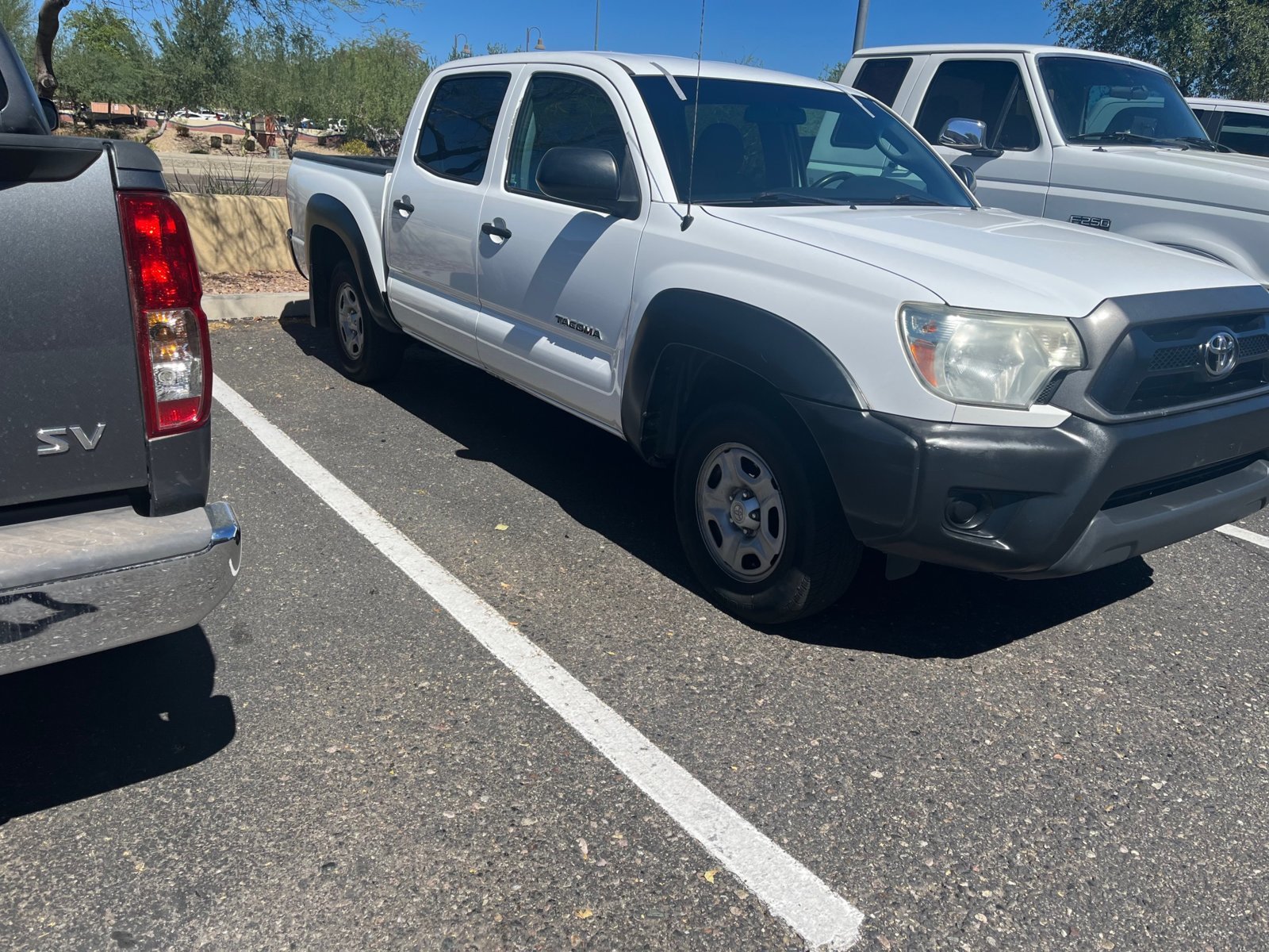

    235 75 15 fits with no mods if you use a wheel with stock specs.
    I collected a set of 'spare tire' wheels, painted them and added the SS trim rings for an old skol flair.
    Not everyone's taste, but I don't try to pretend to be something I'm not with my lowly 5 lug.

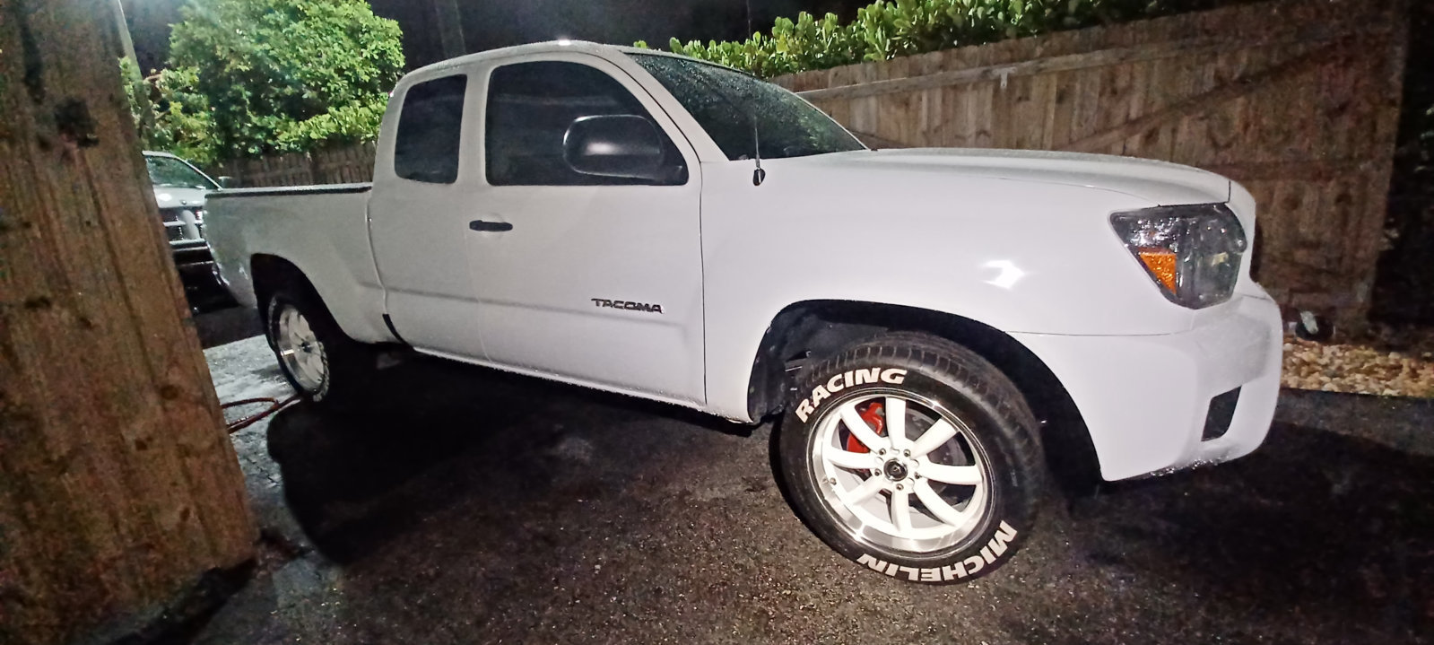

    Here's my 13' base access 2.7 with G-line 18x8's +30, I scored a set of barely used 255/45ZR18 Michelin Pilot Sport 3+ from FB marketplace for $100. I wasn't sure about the permanently glued on white lettering but I couldn't pass for that price. It cost20230621_211413.jpg more to mount & balance them! Im in process of cleaning the shop & have 3 of the original steel wheels with factory dry rotted tires if anyone wants them. 20230621_211327.jpg
