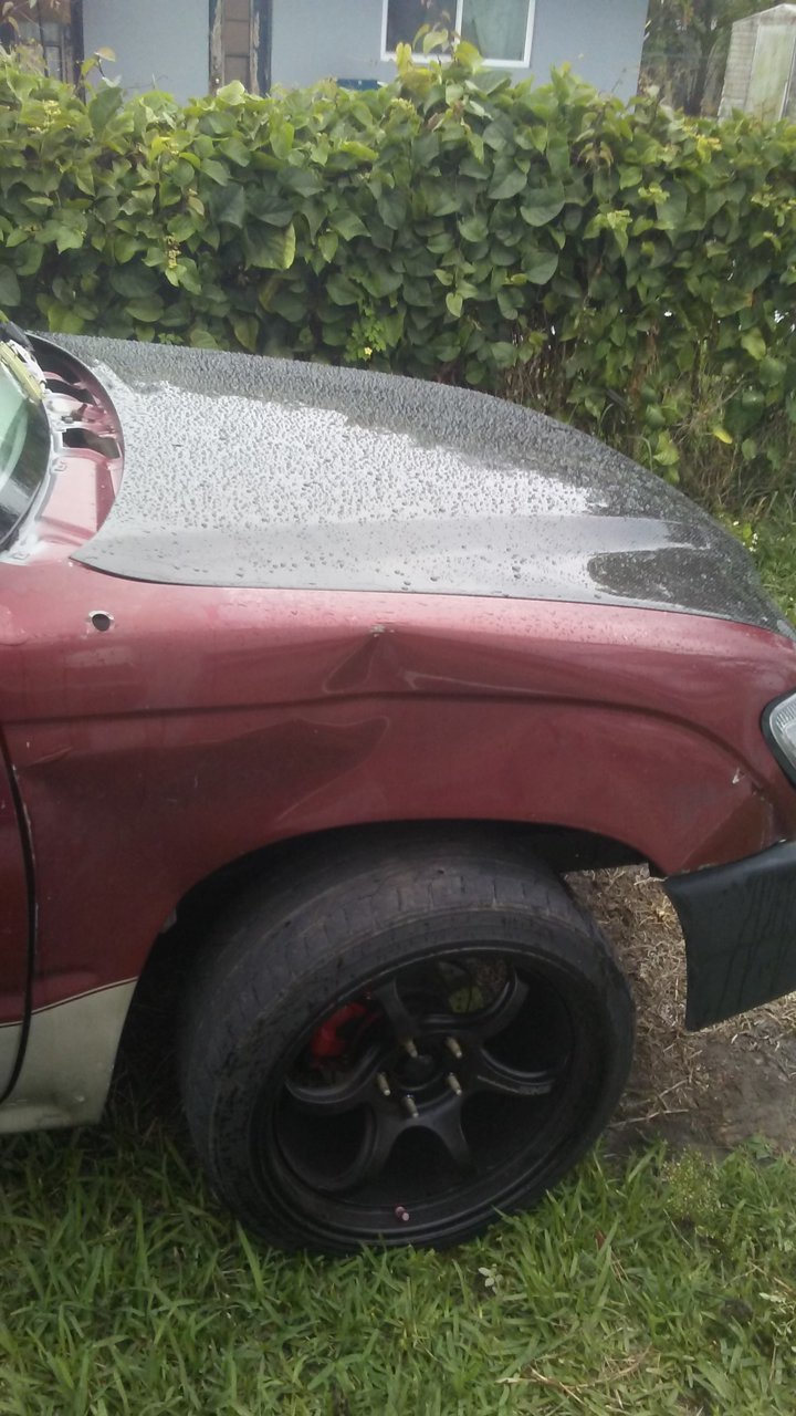

    Why don’t you replace that poor truck’s fender?

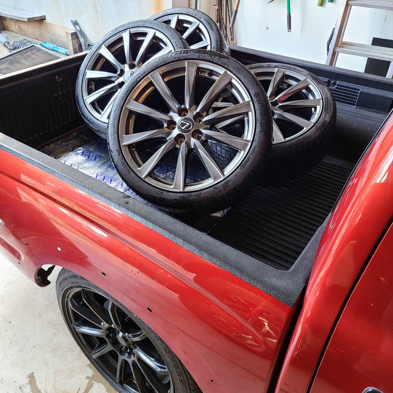

    They're 08 IS-F rims. 19x8, 19x9 staggered. Excited to try them on.

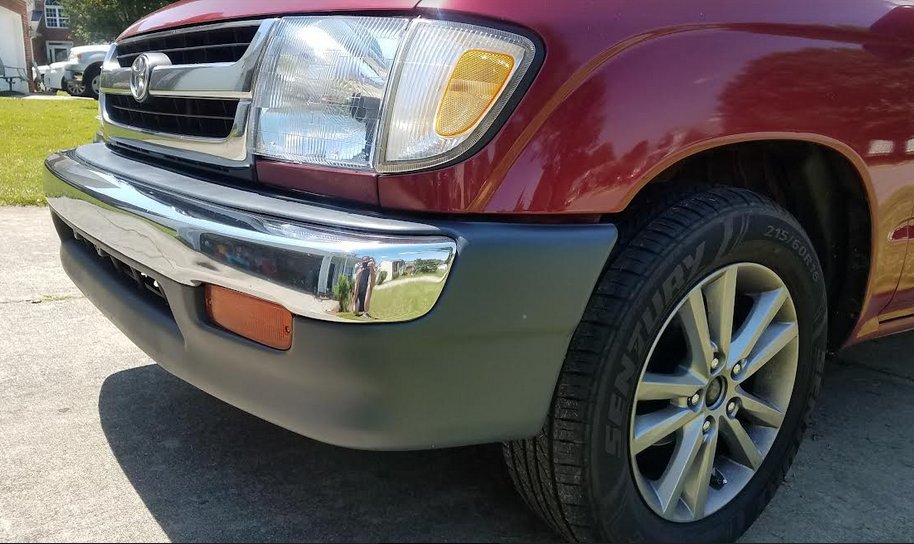

    I have 16" Sonata wheels and they fit great. I can get more pics tomorrow if you'd like. The wheels are 16 x 6.5 with a 44 offset. Not sure if the extra 4-6mm on the Elantra wheels would be a huge deal as long as you're smart about tire size.

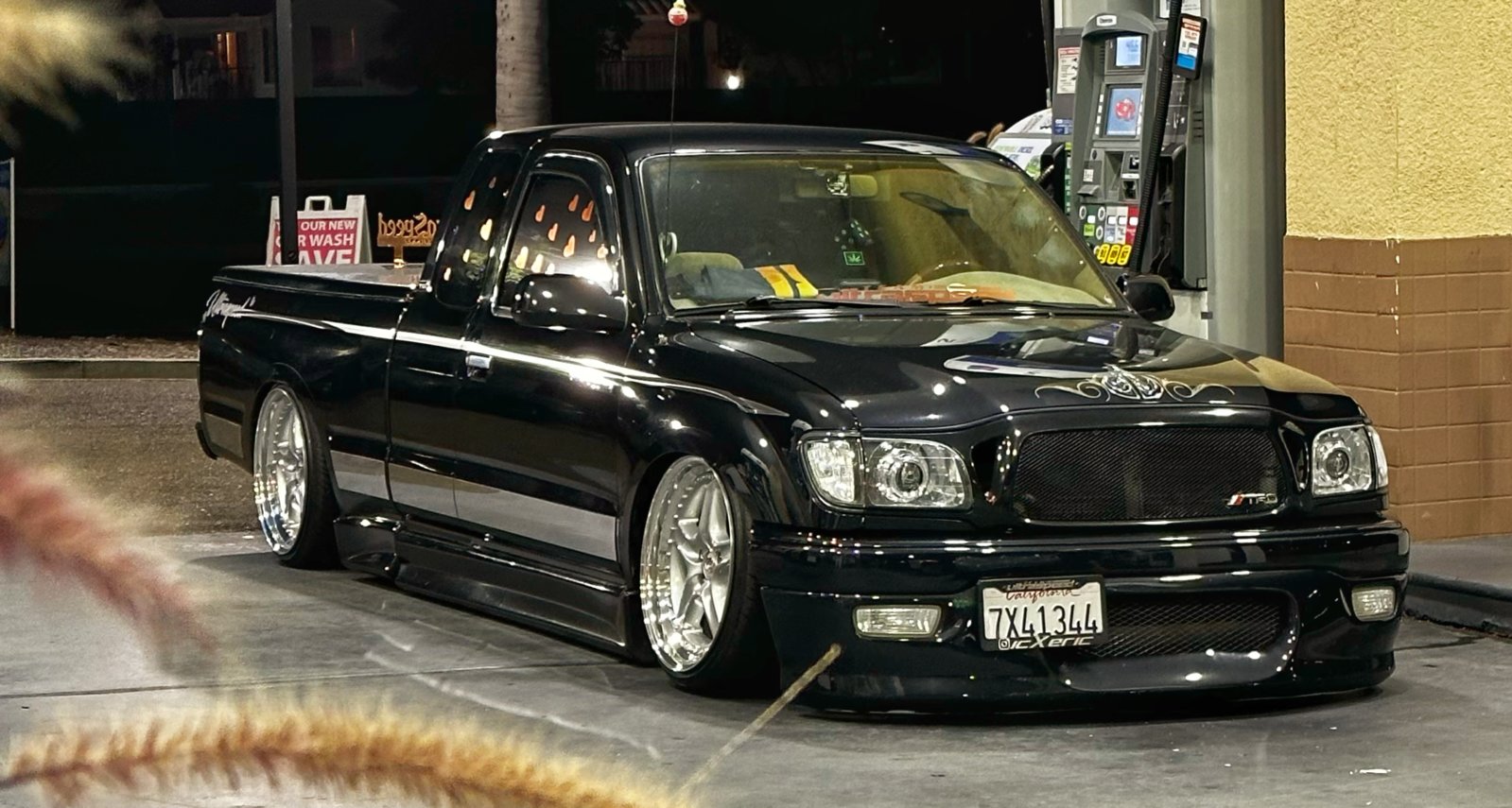

    Exterior TRD 5 Piece body kit Grillecraft grill DDM Tuning HID retrofit Custom etched Lexus HID Projectors Custom two-tone pin stripe by Jprints Chrome Rocker panels Wheels/ brakes 99 Lexus RX300 OEM wheels converted to 3 piece by ChamorroBoy86 Cadillac ATS Brembo 4 piston calipers Cadillac CTS-V Ceramic Brake pads Mitsubishi EVO IV 12.6” rotors provided by BR Autoworks modified by ChamorroBoy86 Subaru WRX STI Stoptech Stainless Steel brake lines Suspension Custom FBSS air suspension Accu-Rate manifold Dual 444c Viair compressors Accuair Chrome tank Custom Polished Hardlines Streetacos weld on c-notch Custom front shock mounts Custom airbag brackets Streetacos ball joint flip kit Engine TRD supercharger URD 2.2” Supercharger Pulley 312cc NA 2JZ Supra fuel injectors JBA Ti Ceramic Headers Spectre Carb Legal CAI LCE Pro Clutch LCE lightened flywheel 16” electric fan HPS silicone radiator hoses Yellow Top Optima battery Custom Battery tie down Universal oil catch can Denso 105 amp alternator AEM 320 LPH Fuel Pump Interior 02 Lexus SC430 trispoke woodgrain Steering wheel Japanese Rose Wood dash kit Authentic JDM Tsurikawa Nishijin Sakura Gold Black (heart version) Authentic JDM Suichuuka shift knob Authentic Junction Produce Fusa Authentic Junction Produce seat cushion Authentic Influenced VIP satin Pillow set Broadway mirror Custom Aloha print door jamb decals from BigHeadzdesigns LCE Short shift kit Electronics Soundstream VRCP-65 Double Din Multimedia entertainment center Alpine MRV-F545 4-channel amplifier Alpine MRD-M1005 monoblock amplifier NVX VCW124 12” Subwoofer MB Quart DSH216 6.5” 2-way component speakers Black Vue 650S Front and Rear Dash Camera AEM boost gauge AEM Uego wideband O2 controller URD Mass Air Flow Fuel and Timing calibrator
    2001 lexus RX300 OEM wheels

    Just bought xrunner rims for base 05 5lug. Stock height no mods. What tire size should I run? Also any suggestion on brand or model of tire appreciated. No off roading highway only.

    2005 2wd base 5-lug

    Jon
    255/45/18 will fit no mods? Should I consider any larger diameter sizes ?
  12. May 20, 2025 at 1:41 PM
    #52
    gstodd
    gstodd Well-Known Member
    Jan 17, 2023
    #415649
    394
    2005 2wd base 5-lug
    AS long as you don't lower too far then yes, the 255 on the X-runner will fit great. They'll be flush with the fender in the rear and slightly inside the fender up front.
