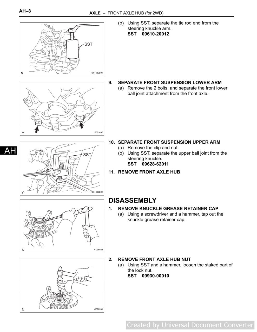

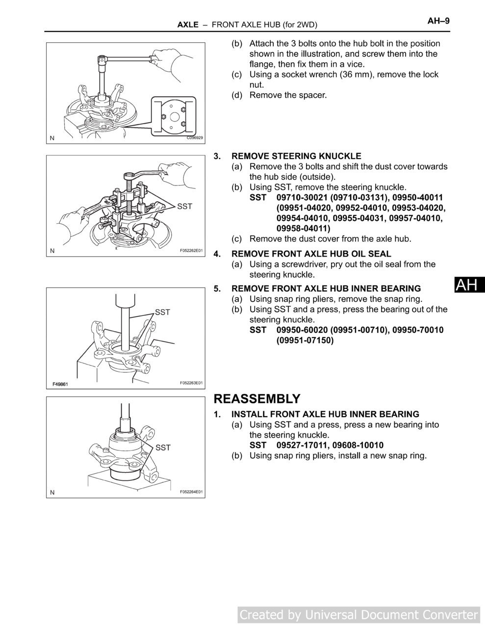

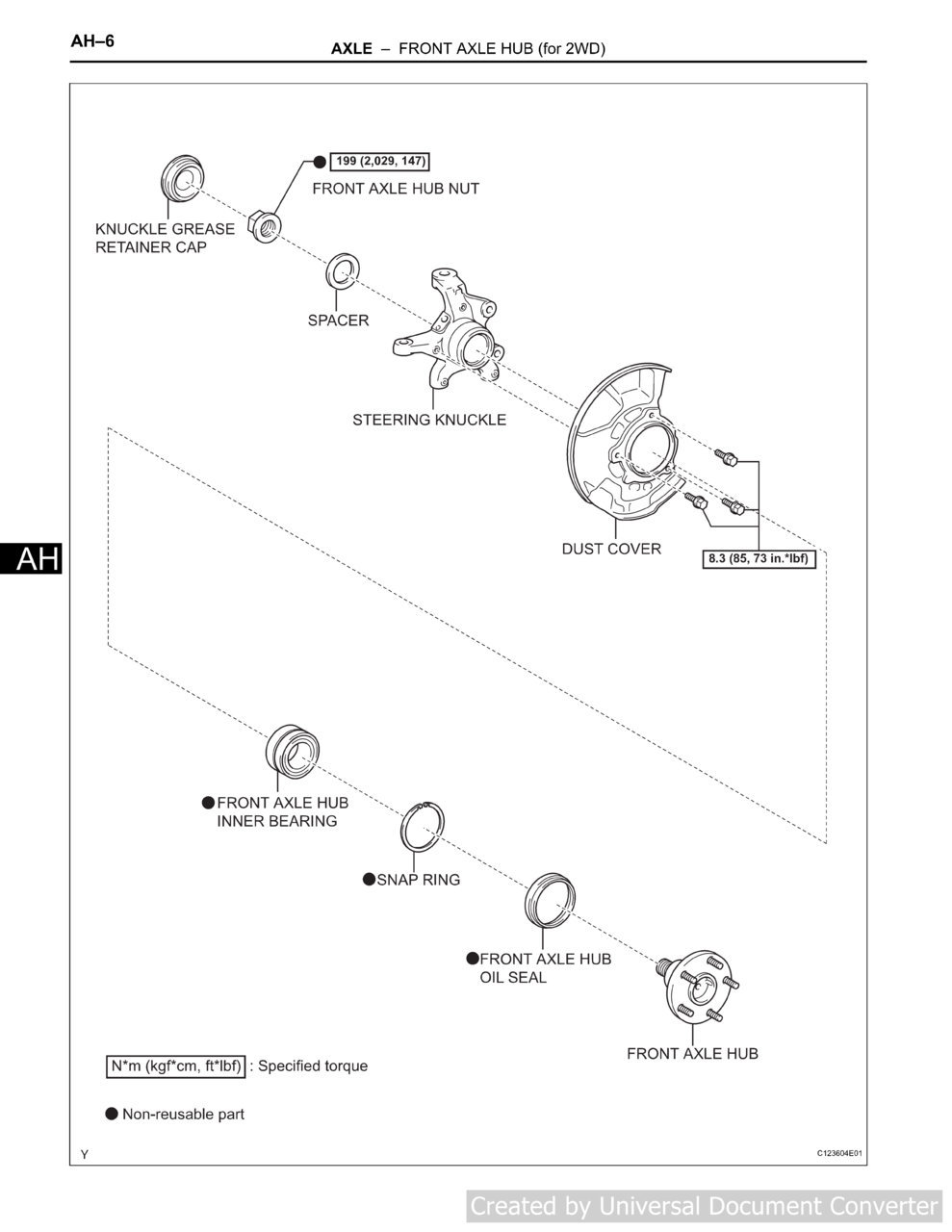

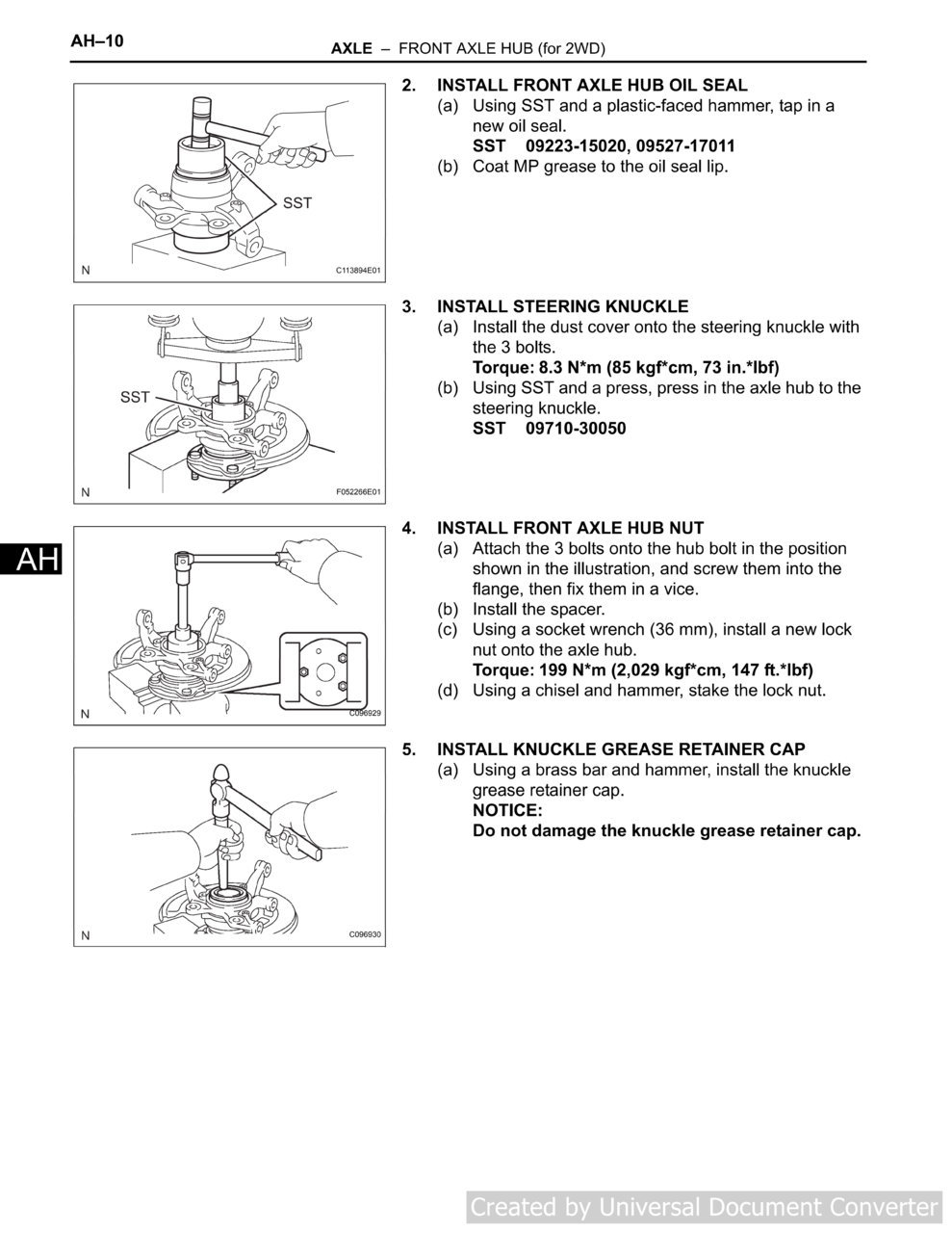

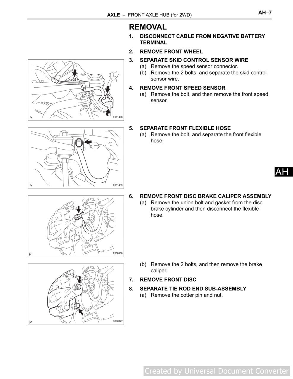

    No hub assemblies on a 5 lug, bearings are pressed into the knuckle and the hub is pressed into the bearing.
    Bearing looks like this, you need special tools and a press to change them.

    They aren't really rare, all 2nd gen 5 lug Tacos use a press-in bearing and many front wheel drive cars also use a press-in bearing. Just did one on a Honda CRV yesterday.
    Take the retaining nut off, slide hammer the hub out (or use the special tool if you have it), remove the knuckle, remove the retaining ring, press the old bearing out, cut the race off the hub, press the new bearing into the knuckle, install the retaining ring, press the hub into the bearing, install and torque the retaining nut, and re-install the knuckle.
