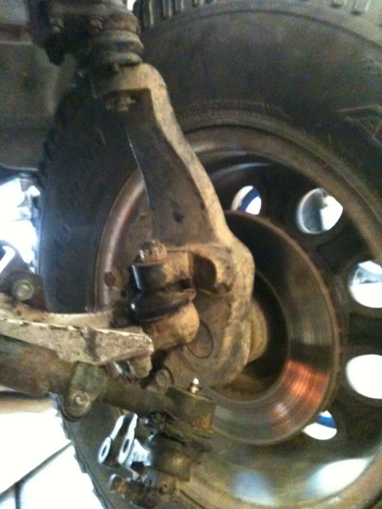

    My current 5lug status

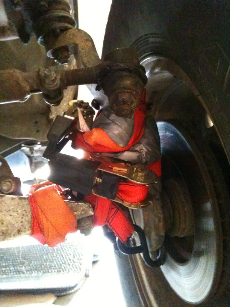

    Steering knuckle bolts sheared off while rallying it pretty hard in the dirt. Got way lucky that it happened going really slow turning around. Grade 8.8 bolt sheared first the the grade 10.9 went. Felt it pulling while braking so I slowed down to turn around and check it out and snap she went.

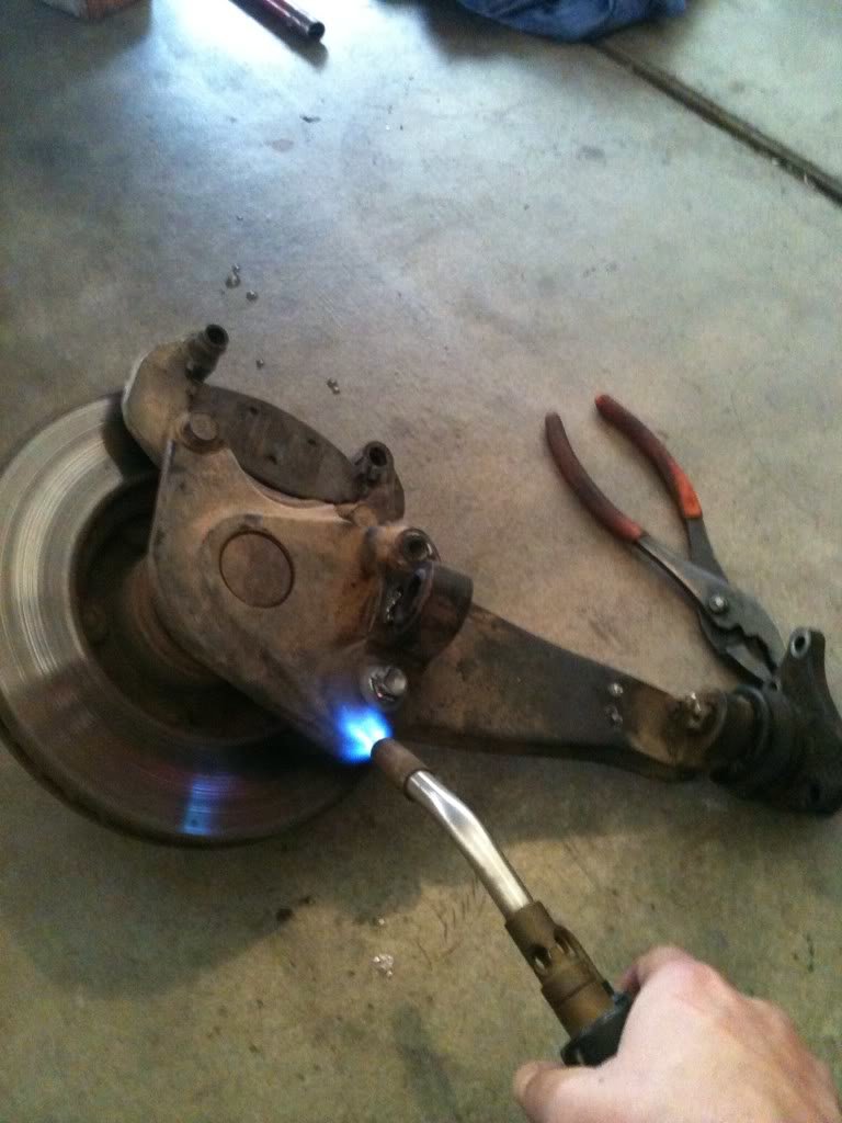

    Was able to weld a nut to the grade 10.9 stud to back it out but the welds wouldn't stick to the 8.8 grade so I'm going to try a couple other things before I consider just welding the knuckle to the spindle. Although its cast so crackage is likely
