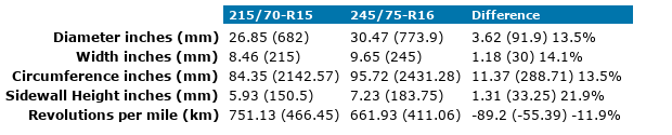

    Don't get me wrong, I loved the truck and was very happy with it before the mods took place! I've had it since Feb 2009 with 0 miles til its a year old now with 19000 :(
    The truck has gone cross country and back without a single issue! But now with the mods, I think its more visually pleasing since it won't be seeing off road very much and not the most practical. Haven't noticed a gas mileage difference yet, since its only seen 30 miles since completed yesterday. All thats left today is an alignment and then the gas checks begin!
    The big thing was the speedometer being off by like 4-8 mph! Any ideas what the easiest way to fix this, I'm guessing the dealer would be useless as usual!:mad:

    Well pretty much *everyone* is saying that Toyota intentionally has the Tacoma speedometers reading 3-4mph faster than actual speed at 60mph. So your larger tires may bring your actual speed up to what the gauge reads. Do you have a GPS device to check it with? That's probably the most accurate way, aside from waving down a highway patrol officer and flashing them two fives for a speedo check.

    Also curious to hear about the performance. That is quite a jump in tire size, but looks very sharp!

    Yep, Garmin Nuvi. The higher the speed, the bigger the difference. Looked at Hypertech, but I'm curious if the dealer will adjust them. I'll ask when they do my 20,000 service.
