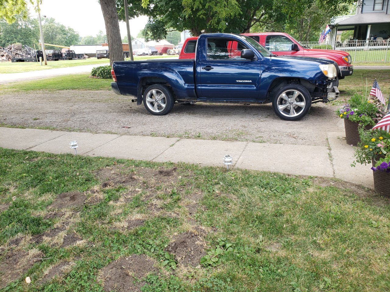

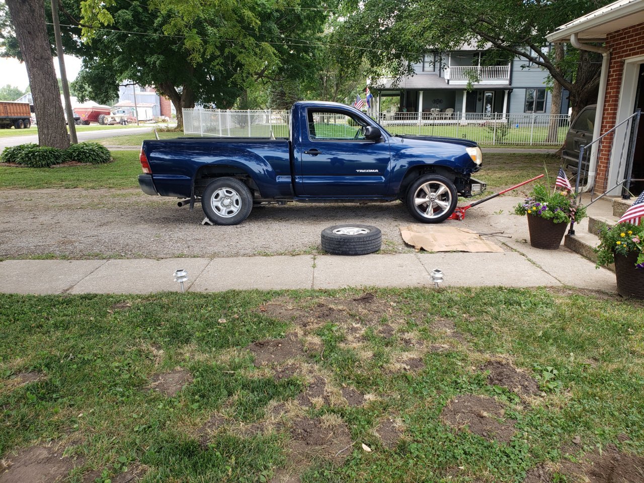

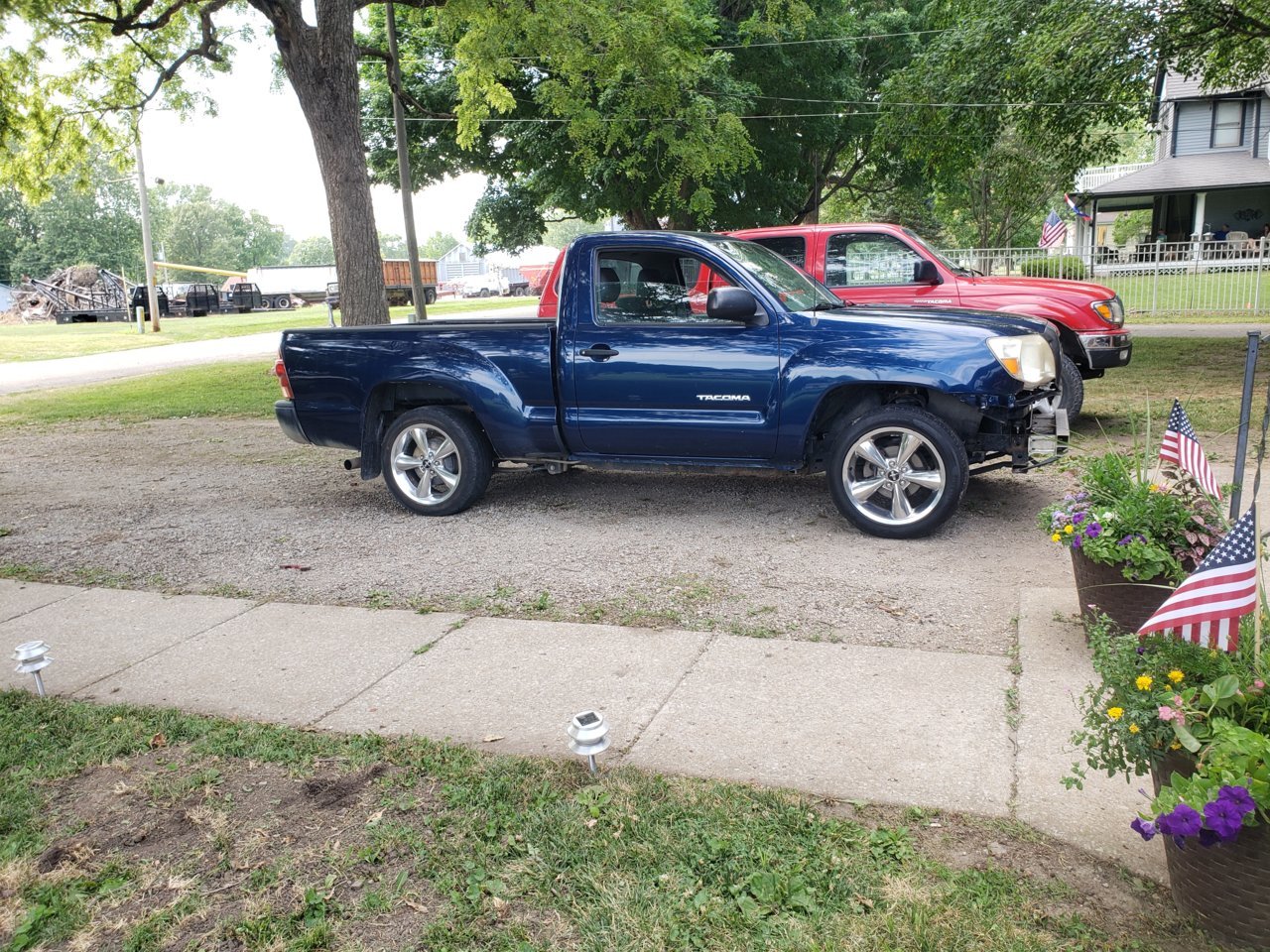

    Got them on. I think it looks a lot better. Who do you all recommend for a lowering kit?
    Thinking 3" in front and 4" in rear... thoughts?
