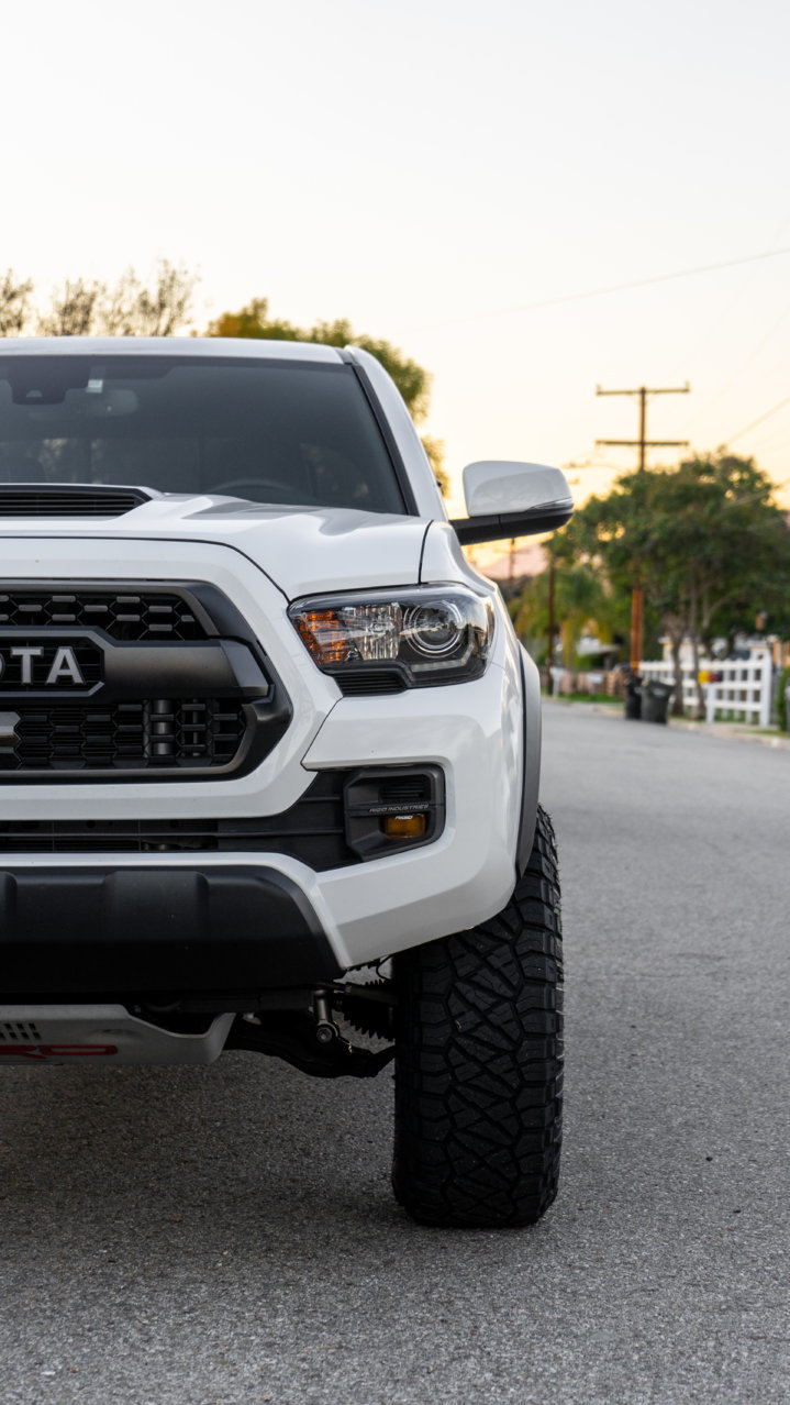

    With that you will get tire poke, but the wheel will be inside the fender and close to flush

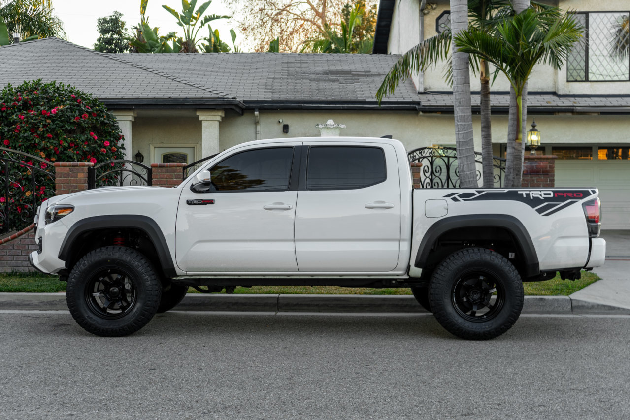

    What tire size would you be going with? We use to "compare" different wheel specs with tires. It is a "general calculator", but it'll show you the difference in width
    As a visual, heres a common wheel and tire package spec we offer,
    17x8.5 -10 with a 285/70r17. Your poke would be similar, wheel being essentially flush with the edge of the tire poking out.

    While not being a bilstein setup, nor doing this customer's suspension package - he did have a spring perch which is at 2" of lift upfront.
    I did recommend and prefer to do a CMC and other trimming to fully clear the tire under compression if he were to go offroad. However, it does not rub for the daily driving as a commuter vehicle.
