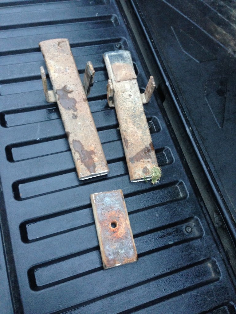

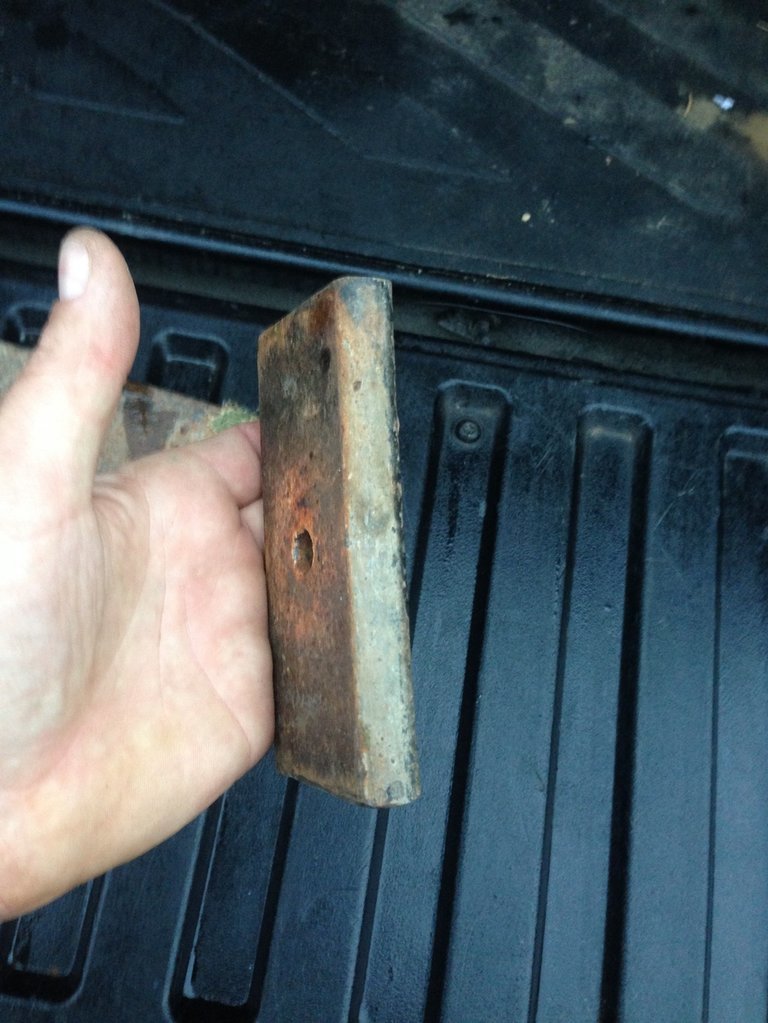

    I took a cutoff wheel to the other springs I have. 5/8" thick. I dont see why this wont work.

  11. May 21, 2016 at 6:34 PM
    nd4spdbh
    nd4spdbh Well-Known Member
    Oct 7, 2013
    #114055
    14,598
    SoCal
    13 DCSB TRD OR v6 Auto
    that works.

    I'm going to go with 5/8"

    LOL yeah. Something tells me itll be an increase of roughly 5/8" in rear height.
    I need to cut the other one still and grab some new centering pins then I can install them .
