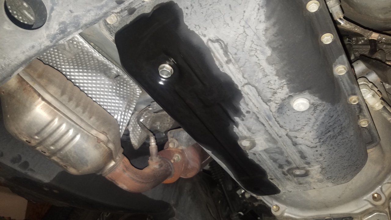

    2006 Prerunner and 4x4 w/V6 engine, 5.2 qts with filter change, according to the manual.
    Tex-Tac likes this.
  2. Sep 22, 2017 at 9:45 PM
    #22
    T4RFTMFW
    T4RFTMFW Well-Known Member
    Jul 23, 2014
    #134525
    69,757
    That's what the book calls for, but not what everybody puts in.
    There was a thread somewhere with owners saying what they put in, pretty sure that's where I got 5.5.
    I always did that amount, always read perfect on the stick.

    That's the transmission pan
    Whitetrash, 4WALKER and T4RFTMFW like this.

    I'm pretty sure that is the transmission.....
    You aren't the first nor will you be the last...

    My lord why does this keep happening. I am ashamed for you.

    At least you didn't pour the transmission fluid into the radiator overflow tank as some have done. Just because it was pink too.
    You didn't did you?

    I accidentally drained the wrong plug yes, but I know what and where my radiator fill cap is haha

    Well it's not empty, but I bet it doesn't shift quite right. The pan hold about 4qts and a full refill is like 13qts
