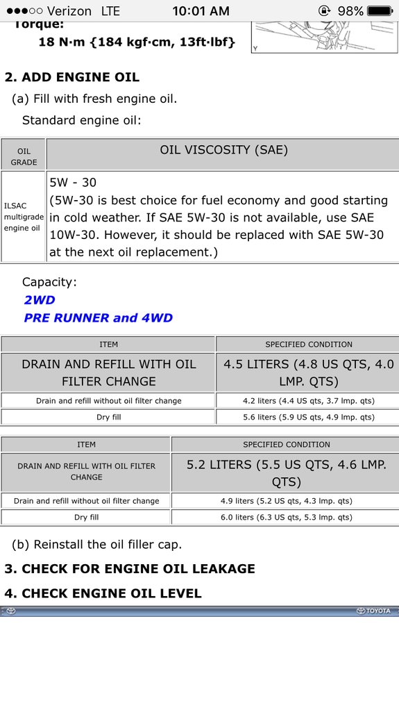

    This is straight out of Toyota TIS, 2006 tacoma with the 4.0 1GR. Prerunner is top box and 4wd is bottom box. Looking at the big grey box not the dry fill one.

    2.7 = 5.5 Qts.

    For engine lubricant, the owners manual for my 2008 Tacoma SR5 PreRunner, V6 4.0L (non-TRD or 4X4) model states the following:
    ENGINE LUBRICATION
    Oil capacity (drain and refill),
    L (qt., Imp. qt.):
    4.0 L V6 (1GR−FE) engine
    Two−wheel drive models except Pre-Runner
    With filter 4.5 (4.8, 4.0)
    Without filter 4.2 (4.4, 3.7)
    Four−wheel drive models and Pre-Runner
    With filter 5.2 (5.5, 4.6)
    Without filter 4.9 (5.2, 4.3)
    4.0 L V6 (1GR−FE) engine—
    SAE 5W−30
    Outside temperature
    SAE 5W−30 is the best choice for good
    fuel economy, and good starting in cold
    weather.
    If SAE 5W−30 oil is not available, SAE
    10W−30
    oil may be used. However, it
    should be replaced with SAE 5W−30 at
    the next oil change.
    5.2 liters = 5.5 quarts (or 5.5 quarts = 5.2 liters)
    (Don't get liter's and quart's confused. They are two different units of measurement. One is metric the other U.S. Standard)
