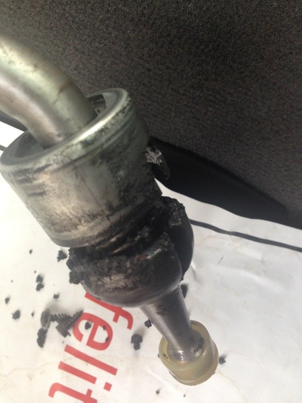

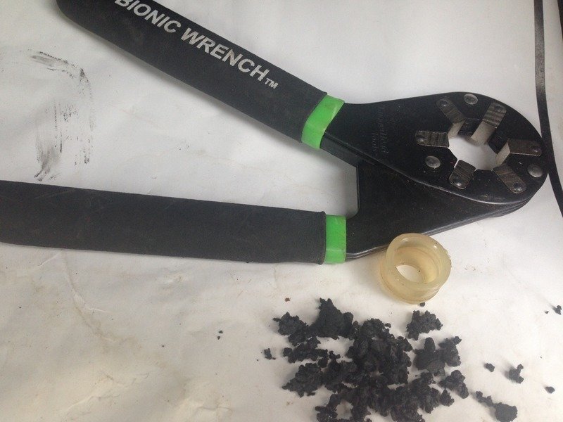

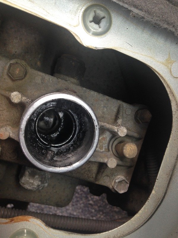

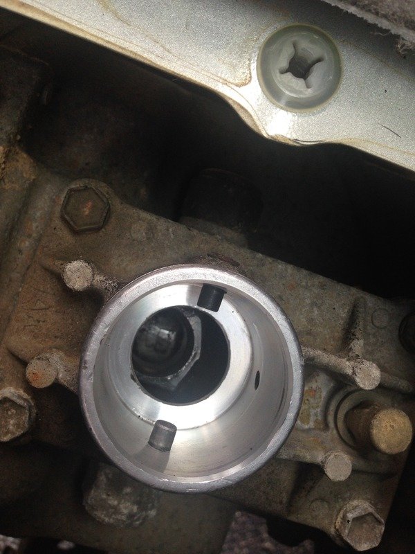

    Just wanted to thank all that chimed in on this topic. I ended up ordering from Marlin Crawler and installed the new shifter seat and socket today. Definitely felt a big difference. Feels alot tighter and shifts smoother. There was literally nothing left of that OEM seat, just pieces. I only ran into one problem, but that is because I didn't read the instructions on Marlin's site. Please make a note to anyone replacing their shifter seat and socket. Remove and discard your old Toyota seat and rubber insulator. I was trying to reuse the rubber insulator AND the new seat. As you can guess, it did not want to fit. I tried for an hour to mash it in there, and then decided to read the site instructions again and there it was , plain as day. Needless to say, this job would have taken less than an hour, but all is good now. Thanks again to all that helped and pointed me in the direction of replacing the shifter seat (You know who you are).
    That last picture is what was left of my shifter seat. I used the bionic wrench to get the old socket off because it was a bitch to remove.

    Well done... your bushing was completely toast. Im surprised that it wasnt jumping out of gear.

    Me too. I couldn't get in gear but never once jumped out of gear. The rubber insulator was the only thing left, but it was in good condition
