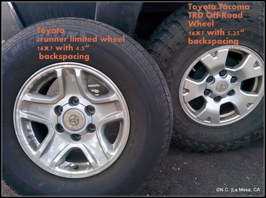

    here's a pic for reference, they will stick out about a half an inch more.

    Thank you for the picture! As I understand it my TRD OR wheels have backspacing of 5.25" and the 5-spoke backspacing is 4.50". Switching wheels should yield 3/4""more space, which I desperately need.

    Over the weekend I picked up these 4-runner wheels. I confirmed the backspacing with a ruler. :)

    Be careful with the wheels in the top picture. Not sure if the user was using spacers or not but I had these wheels and they hit my calipers
