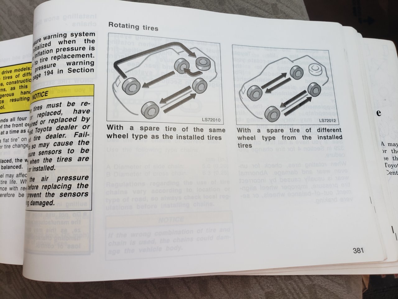

    My 2008 has a 5 tire rotation pattern right in the owners manual. Take a look.

    From my Owner's Manual:
    That said, it's not the pattern I use. I make an X bringing the rears up so each tire spends time at all 5 positions. I don't use directional tires.
    Edit: The method shown here in the owners manual is actually pretty dumb. The tires won't wear evenly over the course of their life if you use this method. Make sure each tire spends time at the spare location.

    The tireS will wear just fine if your alignment is good. I’ve never cross rotated tires and have never had tire wear issue. No less than 60k put on any set of tires. So the edit attached is completely false.

    Yet again trying to out engineer the engineers. Guess Toyota has it completely wrong.

    The only issue I see here is that your 2 driver side tires are going to spend way more time on the road than the 3 that are being rotated out on the pass side. Maybe im just crazy.

    It's right only if you are running a 5 tire rotation with directional tires. I'm guessing the number of people doing this is zero. As pictured, When the tires on the driver side have 50,000 miles on them, the tires on the passenger side will only have 33,000. So no, they will not wear evenly.

    I can see that. I’ve never rotated the spare in. It’s the spare.
