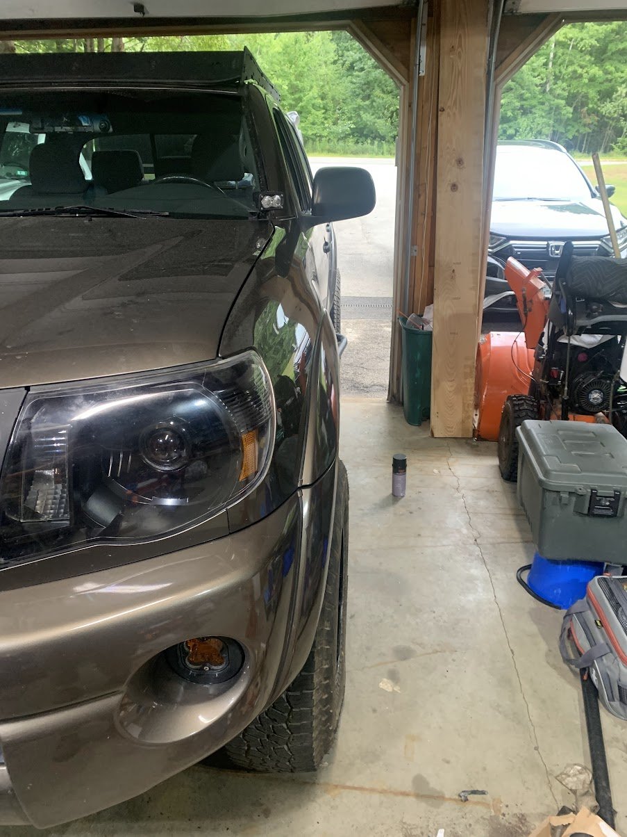

    Fox and Locked suspension 63's Skinny 33's
    Why not just run the wheels without the spacers? Those wheels are ideal for that tire size. Not too wide but the tires will sit just about flush.

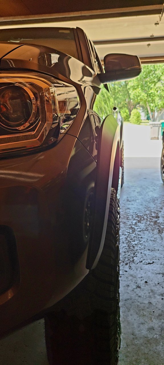

    20230709_075600.jpg 20230608_135745.jpg I run the stock 16's (+25) with the same spacer bringing it to -7mm.
    No rubbing with 265/75/16.

    Well I have but a little poke looks good sorta-ish?

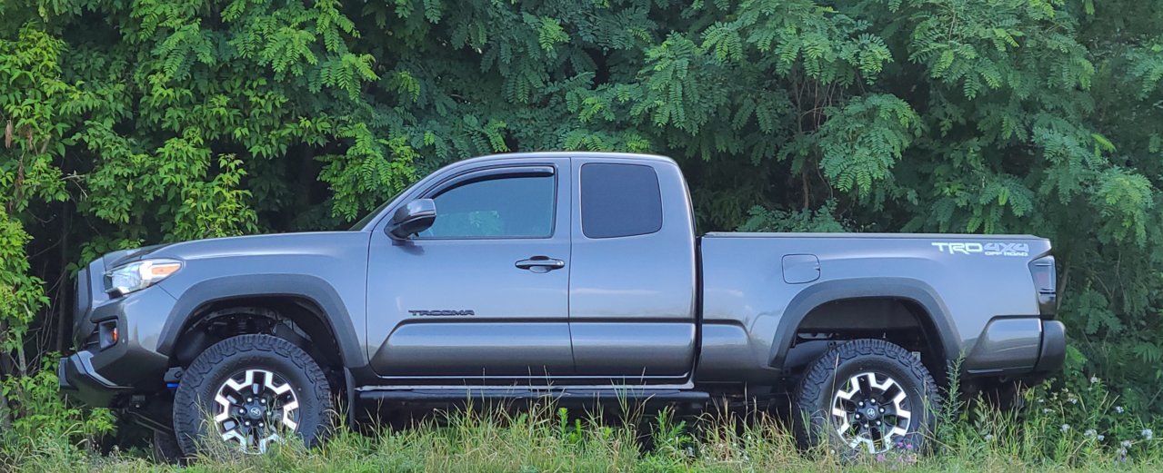

    Ok fair enough heres my truck with 0 offset and I think the poke is ideal. But different strokes for different folks.
    AIL4fc8iRObMfD0c_EOoSgFz-8OldAwzy-UeNsFV_a4f052d5e4194c7e0f5bf65650703786993b98b2.jpg
    Discount Tire and bkhlrTaco's like this.

    Yep, Anything beyond -10mm is too much for my taste.
    I like the looks just not realistic for my driving.

    this is great!!

    Your current wheels only push the tire in 0.157" so they are basically identical. Two things that could effect this. I do not know if 2nd/3rd gen have similar coverage for the flares. Maybe 3rd gen covers further out.
    In the front the wheel mounting surface moves in as you lift. I am on stock 2015 trd pro suspension.
