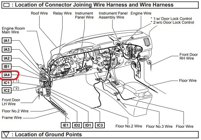

    Not sure, it could be anywhere but typically I look where harnesses are rubbing on things.
    You could unplug connector IA4 and see if the wire is still shorted, if it is then the short has to be between there and the fuse box under the hood, if it isn't then the short has to be under the dash between there and the blower motor.

    Do all Gen 2 Tacomas have the Floor Wire, and Floor Wire No.2 & No.3? One appears to be under the driver's seat, and the other in or under the center console.

    I'd have to look at other year diagrams but they probably do, the wiring routing and harness joining connectors didn't change a whole lot over the years.
    Why do you ask?

    Although it's a crude alternative to the ideal aftermarket heated seat kits - I have 2 of those inexpensive heated seat covers. They work ok, and the Honda CR-V I had provided a receptacle in the center console. I drilled a small diameter hole for a cable to exit which I connected to a dual 12v receptacle for the heated seat pads to plug into. I liked that the wiring was pretty much concealed. I don't think the Tacoma has a 12v receptacle in the center console (does it?) but if that 12v feed is accessible near it, or under it, or maybe Floor No. 2 Wire I could use that.

    There is no 12v feed under the seat or console that I know of that would support seat heaters other than maybe the one for the power inverter on equipped trucks and I think that's only powered up when the inverter is turned on.
    The floor No2 wire I'm pretty sure is just for the SRS System and the seat belt switch.
