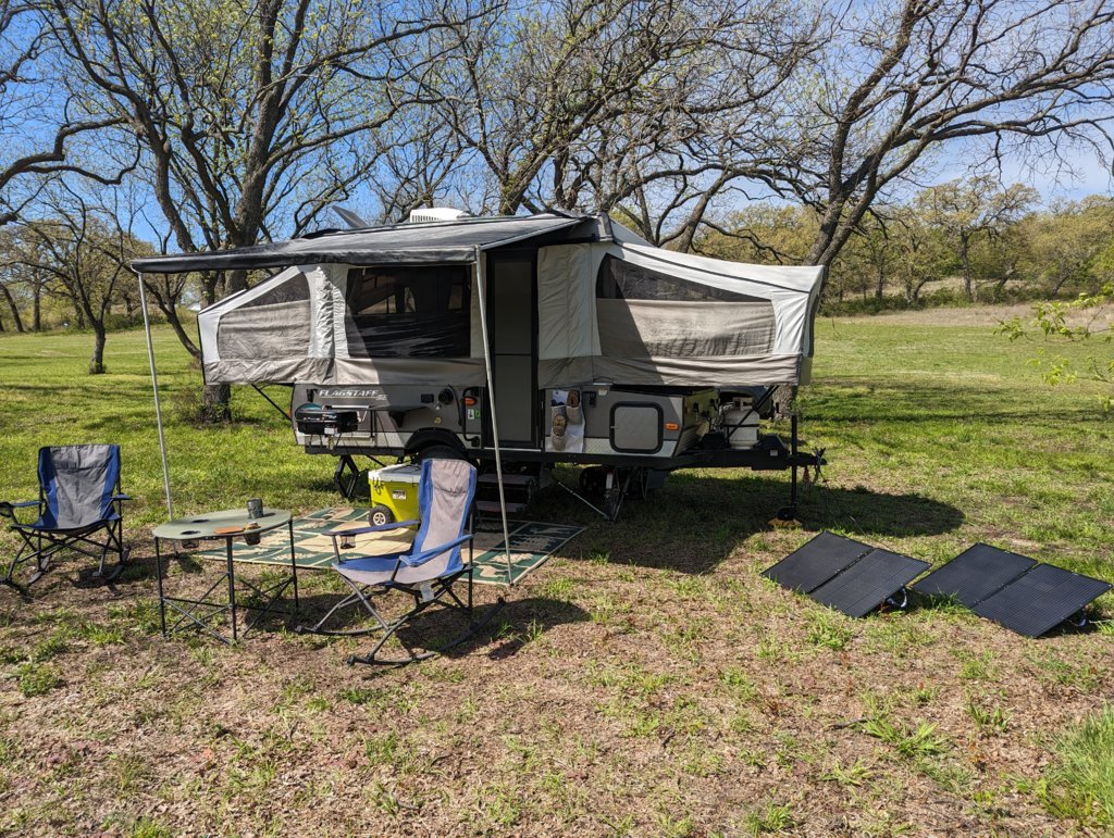

    Edit: folding panels in action.
    I can't say enough about em. I've taken several week-long sojourns, I've had to refill water nearly every trip, but I've never run short on electric.

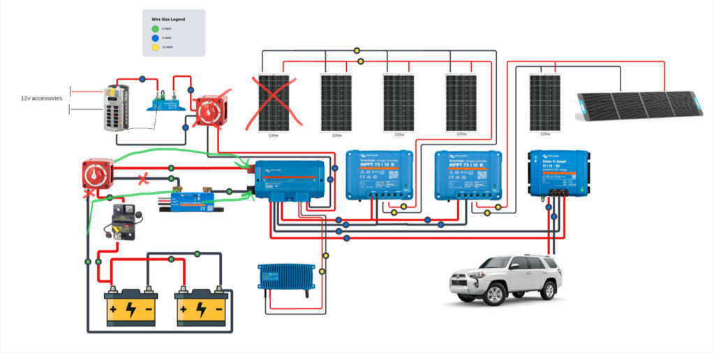

  18. Apr 23, 2025 at 6:22 PM
    #18
    Thunder chicken
    Thunder chicken Well-Known Member
    May 31, 2018
    #255035
    114
    NW Ontario
    ‘18 access cab manual
    I ran 4ga wire from truck battery, (through a solenoid for fun) to a large anderson plug at rear, connected to a dump trailer, that has an onboard 12v battery. On short trips the trailer battery would not charge enough off the 7pin alone.
    This allows me to dump all i want. The dump trailer draws ~200a while dumping. I leave the taco idling while using the hoist.
    Ive been doing this for 3-4 years with no problems.
    andrewtheadventurer and koditten like this.
  19. Apr 23, 2025 at 6:34 PM
    #19
    andrewtheadventurer
    andrewtheadventurer Well-Known Member
    Feb 7, 2017
    #209901
    2,645
    Andrew
    Somewhere probably
    Off-road Tenthouse
    an empty wallet
    Running cable from your truck battery to the rear with an anderson plug to the trailer with a dcdc charger to the battery bank is a great primary charging source. Victron makes a small dcdc now that is great. (I have this configuration on my t4r with my travel trailer)
    solar is more of a topoff/trickle charge power source unless you have 700+ watts.
    Example of my travel trailer power system. The markups are some changes i made. There is some redundancy with the breaker and switch. But i had the space and i wanted the kill switch to be clear as day.
    new victron dcdc for smart alts - https://www.victronenergy.com/dc-dc-converters/orion-xs-dc-dc-battery-chargers
    victron dcdc that i use - https://www.victronenergy.com/dc-dc-converters/orion-tr-smart#pd-nav-image
