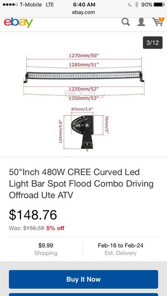

    Just chiming in so that others don't make the same mistake I did. Be careful to double check the sizes of the bar and the mounting screws if you choose to mix brackets and light bars. As an earlier post states, most of the these light bars are basically the same. However, as I found out, there are indeed different sizes. I was hoping to use the Cali Raised LED 50" curved brackets with a cheaper 50" curved Auxbeam light I found on Amazon. Unfortunately, they were not compatible. The mounting holes were different sizes and the bar was about an inch too short for the brackets. The brackets that Cali Raised LED sales are intended for their light bars. They are of excellent quality, but they apparently do not fit all 50" curved LED Bars. They may actually be for the 51.5" bars they sale. I would recommend these brackets, but only if used with the light bar combo they sale or if you are sure they will fit your bar. Hope this is helpful.
    Edit: I found more information on the bracket manufacturer's site that confirms that though the brackets have 50" in the name, they are actually intended for 51.5"-52" light bars.

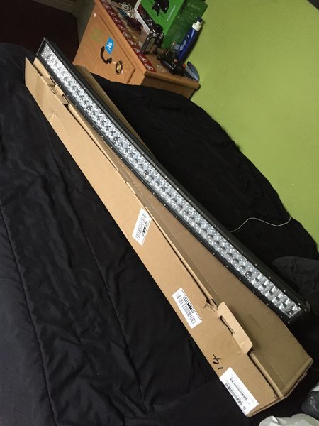

    That's what I had in mind if buying a "50 curved Auxbeam! This one exactly http://m.ebay.com/itm?itemId=182013440939

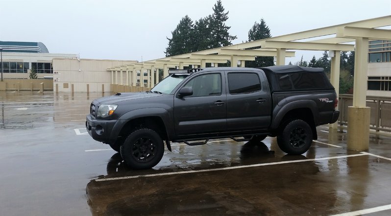

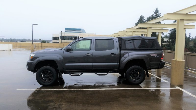

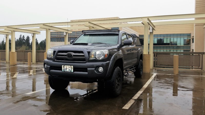

    I finally got some pictures of the installed Auxbeam 50" curved LED bar and the MCM Fab and Design roof mounts. These mounts were super easy to install and I think they look great.

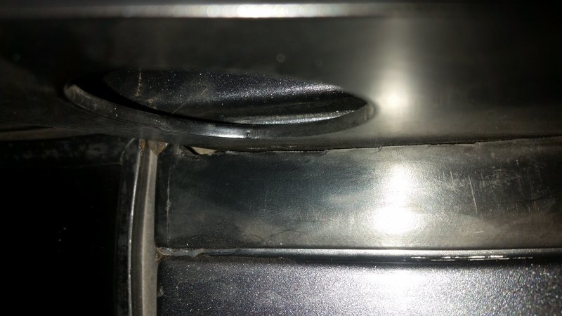

    @Mason Moose, I pulled the black strips off and cut them to fit around the brackets. Then put them back in over the brackets. Used some clear RVT Silicone to help glue the strips back down. I'd suggest using black Silicone instead of clear. I actually had the same question and asked the manufacturer. They said that is how they install them. I'll grab some pics when I get a chance.

    I have the MCM brackets on aswell and I did cut around the Black weather strip it's pretty easy. I just cut like a little rectangle to make it fit exactly where the bracket bolts go. I'll show you a pic in a bit :D

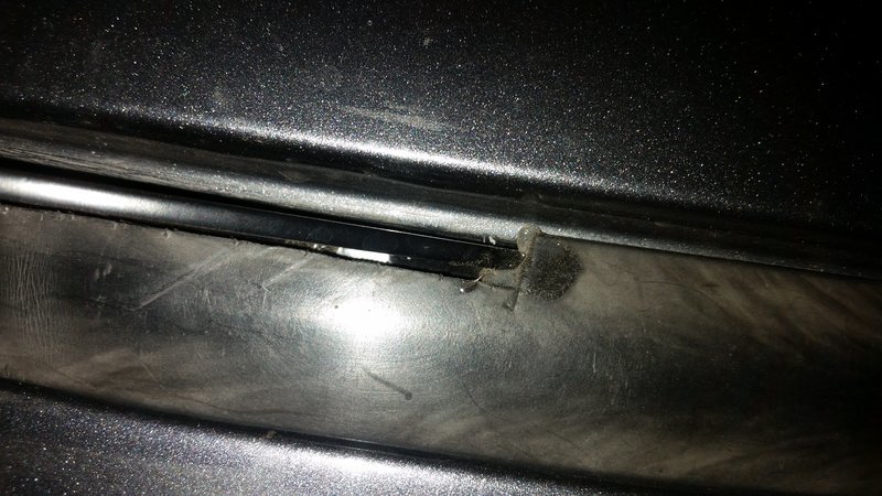

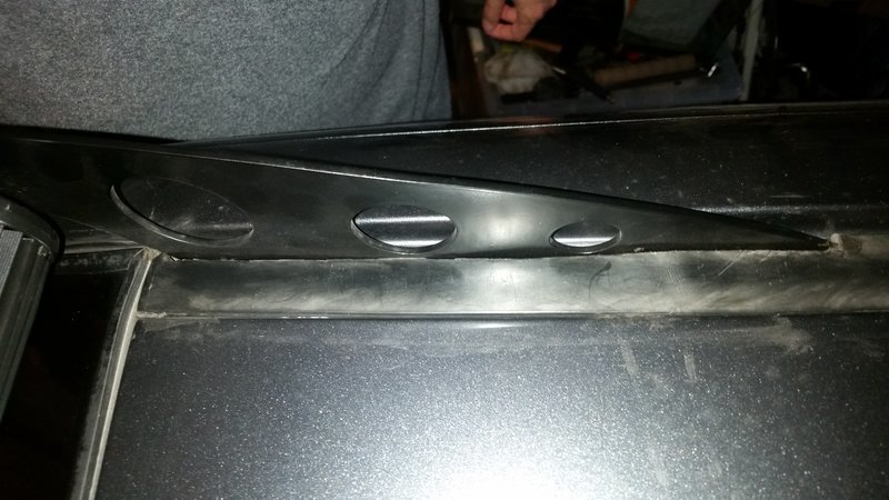

    @Mason Moose, here are some pics. Kinda rushed the cutting job due to a 1 year old and her mom screaming in the house.

    Looks like you cut a lot ? but I think mine looks the same I don't even remember how much I cut haha
