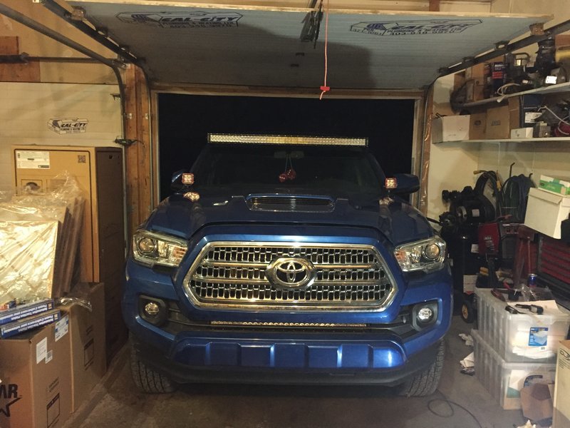

    Hey all, i just finished installing my 32" lower grille light bar and 52" light bar on roof. I noticed that the 52" light bar flickers and some portions seem to be brighter than others. This is with the truck in the off position.
    When the truck is on the flicker goes away but portions still seem to be dim! Any help or ideas are apreciated. Both installed with relays, fuses, power to the battery direct and ground is running to the bolt directly beside battery with the ground wire on it from the battery.

    if its doing it with truck off might not be getting enough power.
    I wouldn't recommend running a light bar like that off of your starting battery with the truck off.

    What brand are the bars? Have you tried bypassing the switch and relay and trying to just power the bar with the contacts directly on the battery?

    These bars are from the recent flash sale on tacomaworld. Freedom led bars.
    Once the truck is started shouldnt it have enough power to operate a couple light bars/and pods?
    Thx. I will try bypassing the switch.

    to run two large light bars and everything else? not sure. seems like it would be a bit much.

    you bought a cheap light bar, that's what you get. Your wires may be too small to supply the needed current to power the whole bar at full draw.
    Also, most chinese light bars are rated from 10 to 30 volts, which means full output is at 30 volts

    Defective bar
    Not the truck

    Some Bubble Gum and Duct-Tape IG** Midnighttaco03 Camburg uni-ball UCA w/ CO Rear Dakar with Fox 2.0 bottom overload removed GG G3D radius bar 50" roof mount GG G3 straight 32" front valence Rago fab bed clamp pod mounts 2 GG amber pod rear OTRATTW custom switch panel in sunglass holder K&N cold air Gibson exhaust Alpine INA-W900 head Mr. Marv box and amp rack IDQ-10 - Interfire Mono Focal fx45 component front Alpine type S Co-ax rear Homer taco TRD Grill GG LED low/high beam TRD seat covers OEM bed mat Weathertech floor mats with replacement TRD-OR decals Weathertech in-channel vents GG Flush mount pod replament fog light kit GG green ditch mount 3x2 pods Fog lights anytime Tailgate hoseclamp mod LED dome light LED map lights LED reverse lights LED license lights Rear window decals: Mall rated, Tacomaworld.com, U-Haul power tow, soundtech, mammoth.
    :facepalm:
    The truck has plenty of power for 2 light bars and a set of PODs...
    This is the point of new LED tech. Low draw with great output!
