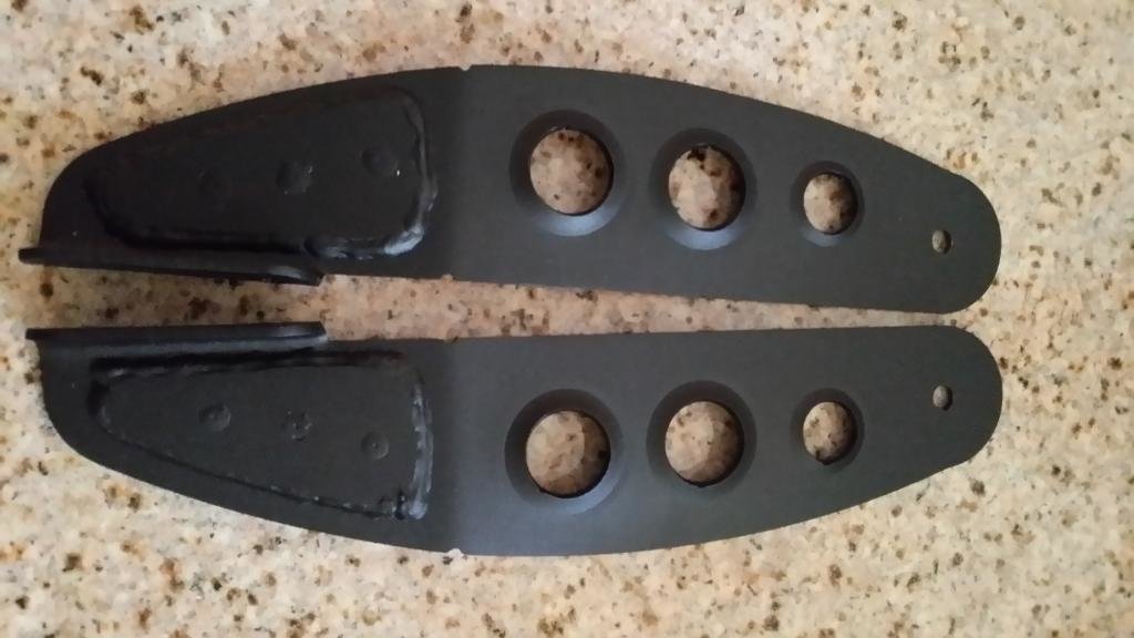

    Relentless new and improved 50" roof radius brackets

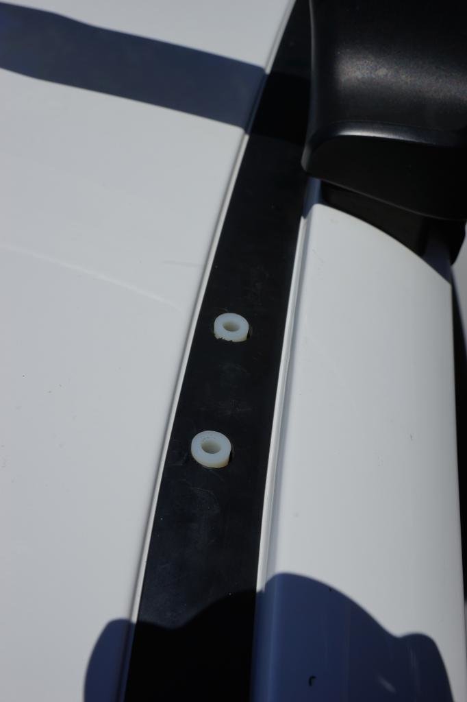

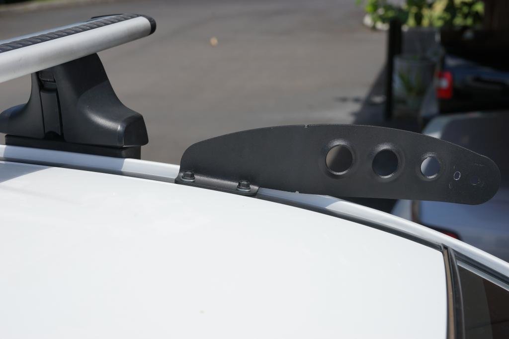

    Since this is an informative mounting page and may help others decide, I figured I'd slap a pic of how the Relentless brackets look and mount on the roof with the existing holes...very clean adaptation...
    Inserted Nylon spacers between roof holes and rubber trim for a clean look and no compression or metal to metal issues. Didn't want to mount a steel bracket against my cab as in time abrasion would cause rusting...:eek:

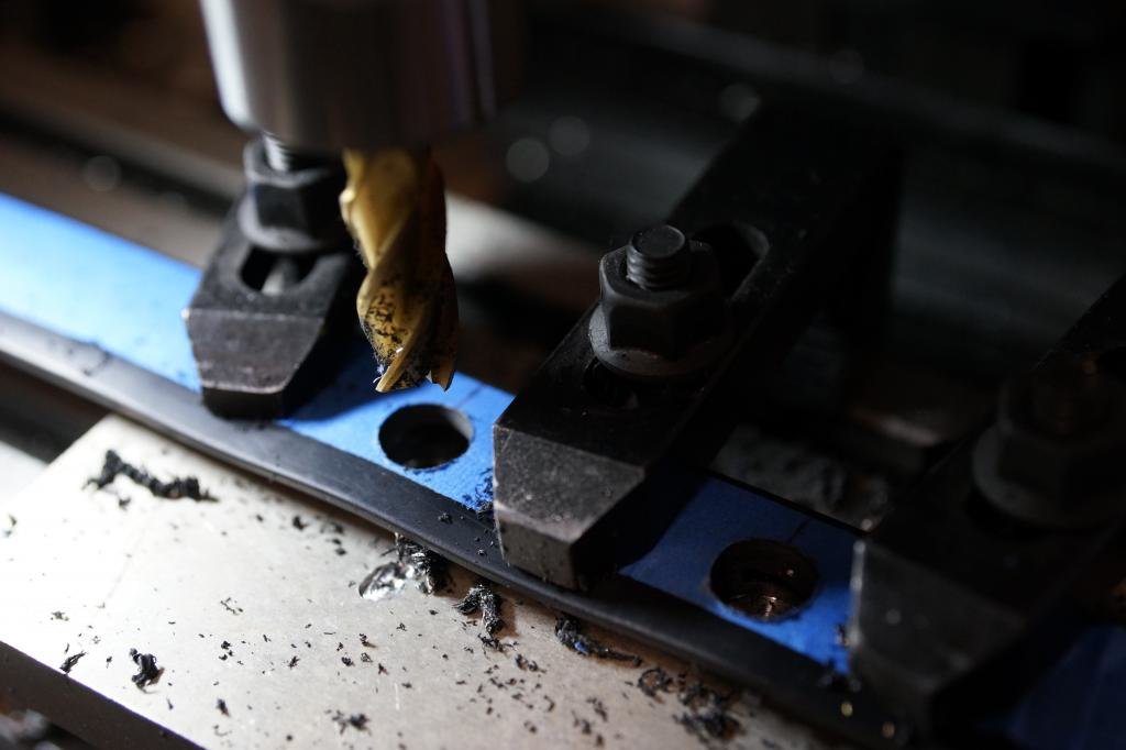

    I used the same type of nylon spacers on mine. Anyone trying this beware. There is a metal strip running through the weatherstripping that covers the factory holes. Drill carefully. I recommend a drill press for this operation.

    Wow!! The relentless looks way cleaner than the supertrucks! I may be returning the Socal one too! haha.
    Edit: I only see the mounts for a radial 50". Now Im wishing I would have got a radial 50"

    I'm guessing you could use the same bracket for a straight bar as well. The length is close to the radius and you can also bend the bracket ends using a vice to meet the connection points. I still have to bend mine to get a good fit...not a lot, but just a little...

    I butchered mine somewhat when trying to drill the holes for the nylon spacers with just a cordless and snips. Lol
    And this. Mine needed to bent in as well wet my Radius. Just started one, and pulled the brackets inward by tightening the bolts

    What size nylon spacers did you use?

    half inch or may 3/4...can't remember off hand. Long enough to reach from threads to top of rubber strip. Then you just need some bolts long enough to reach the threads through the nylon spacer. Simple stuff you can get through you local hardware store...

    Did you completely remove the rubber top drill the holes and if so did you have any trouble putting it back on?

    It's simple to remove and install it has clips like the one that holds down the hood prop rod
