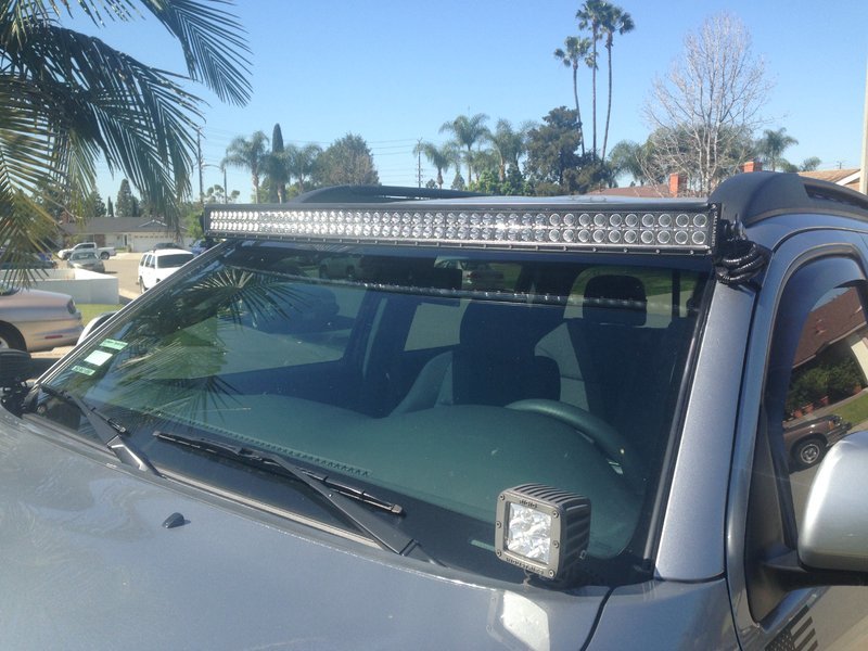

    I have a double cab with the factory rack, will the relentless work with those?

    no. you'll have to modify the rack, or use different mounts, as the Relentless mounts use the same factory roof rack holes.

    I just took off one side and no rubber in the grove, it looks like the mount was made to sit on top of the rubber so now after looking at it i don't think it will work because its to far down as well. Might just have to make my own i guess.

    exactly. I used nylon spacers to sit the mount on top of the rubber stripping.

    I Have the same question i need a mount for a 50" curved bar that will either work with my factory rack (that doesn't require heavy modification of the rack), or will mount in the door and come across the A pillar, wanting it to mount the light in a similar location as the relentless mount (top of windshield close with a clean look)

    Hello, our brackets fit into the door jam mounted to the A Pillar allowing a low profile look. With our brackets you will not have to touch the factory roof rack. If you have any questions please let us know.
