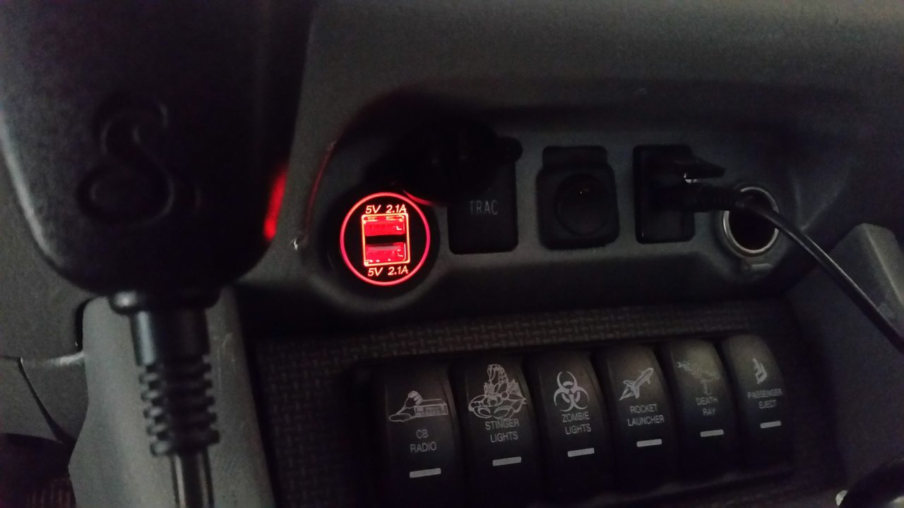

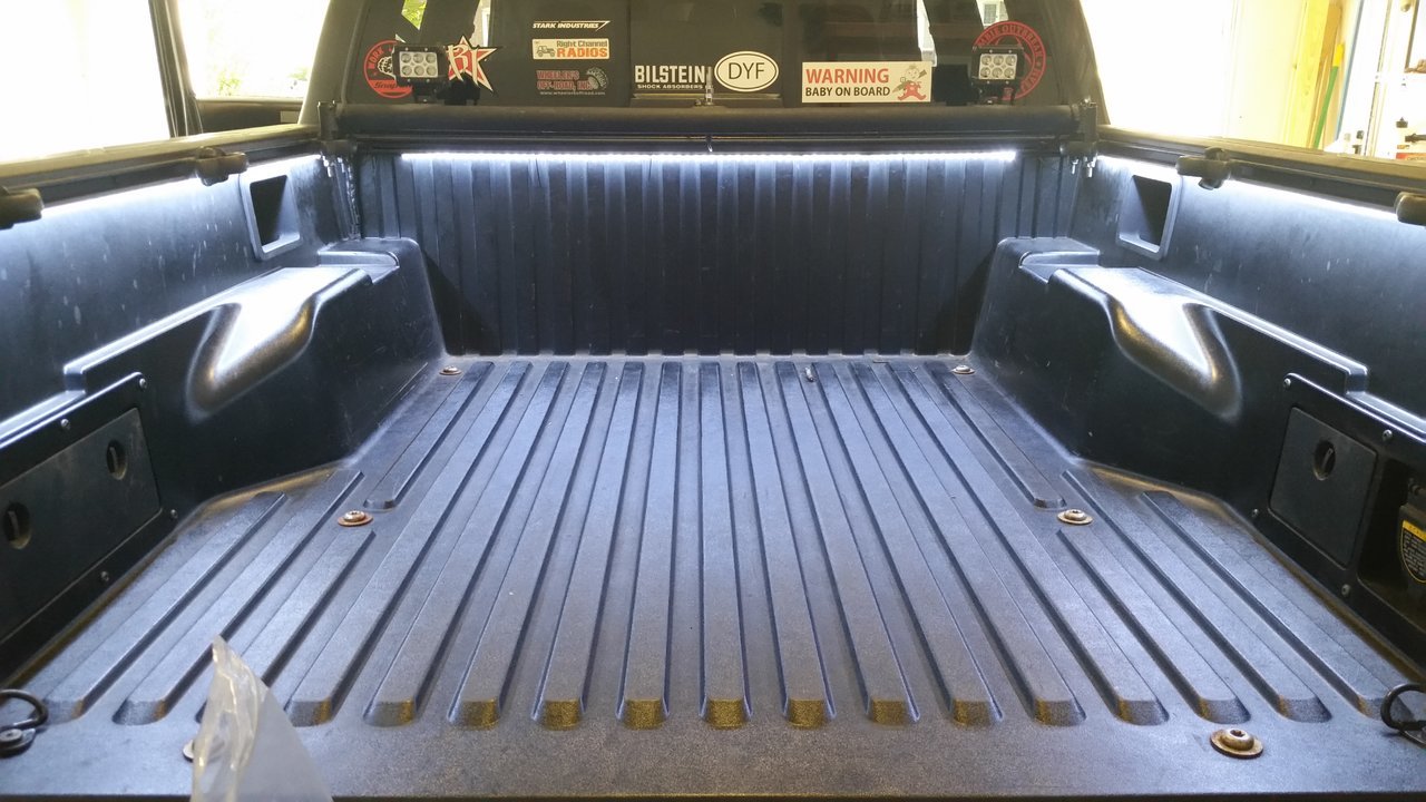

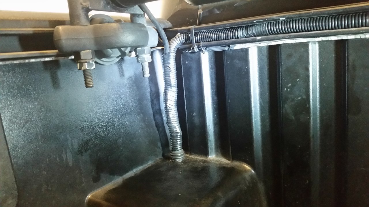

    Fixed/replaced LED's for the bed lights today. Routed the wires through the bed from having them run over the bed between the bed and the cab. Replace the cigarette lighter for a usb socket... this part was a little bit of a bitch. I had to take the lower part of the dash out to remove the cigarette lighter socket, then i had to shave the hole a bit bigger so the usb socket would fit.

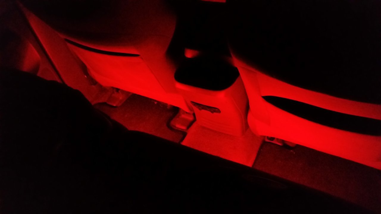

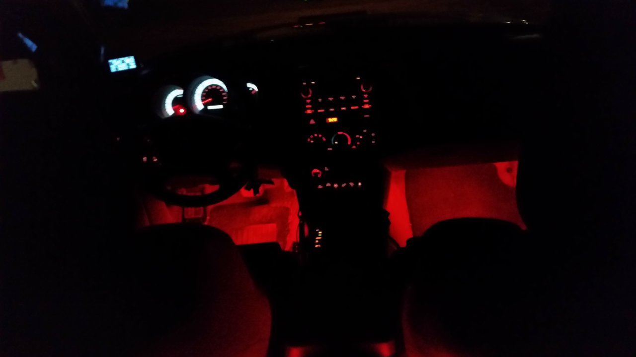

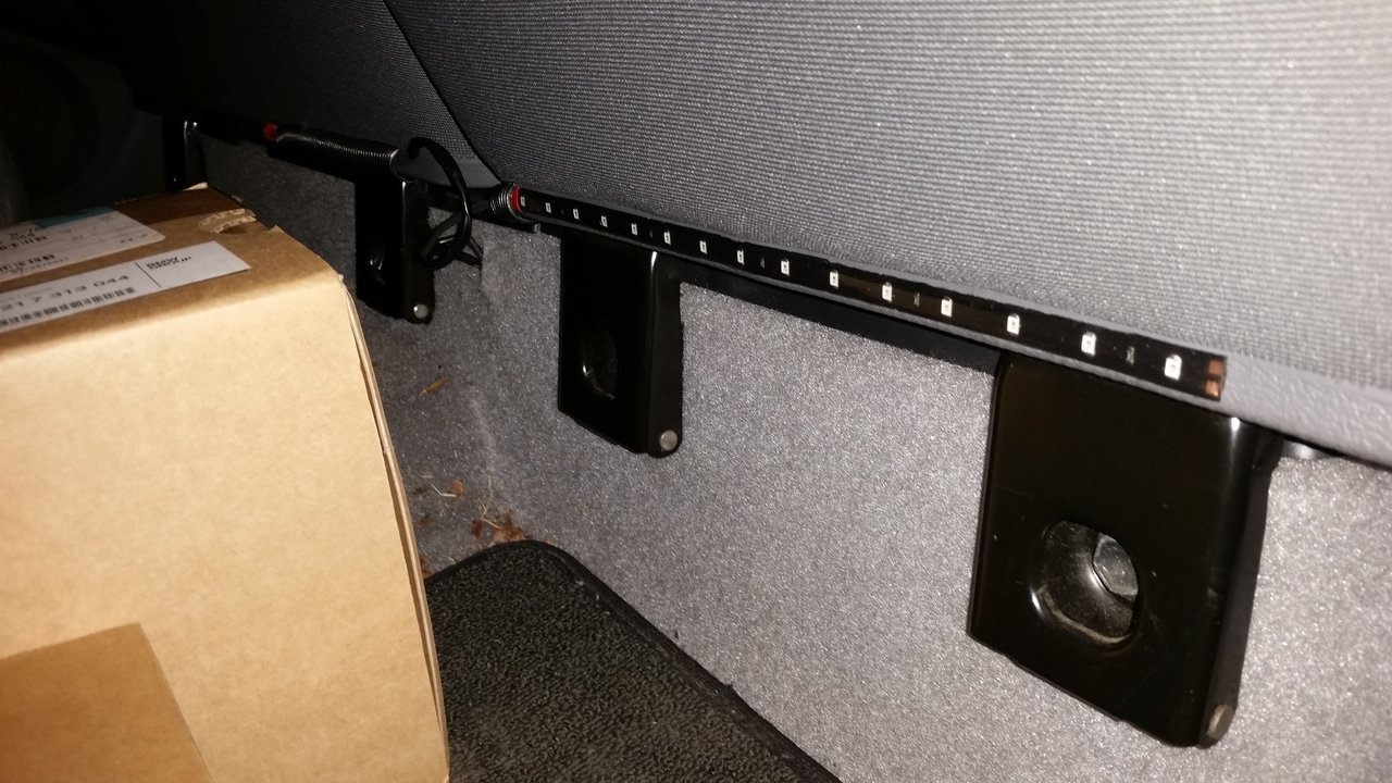

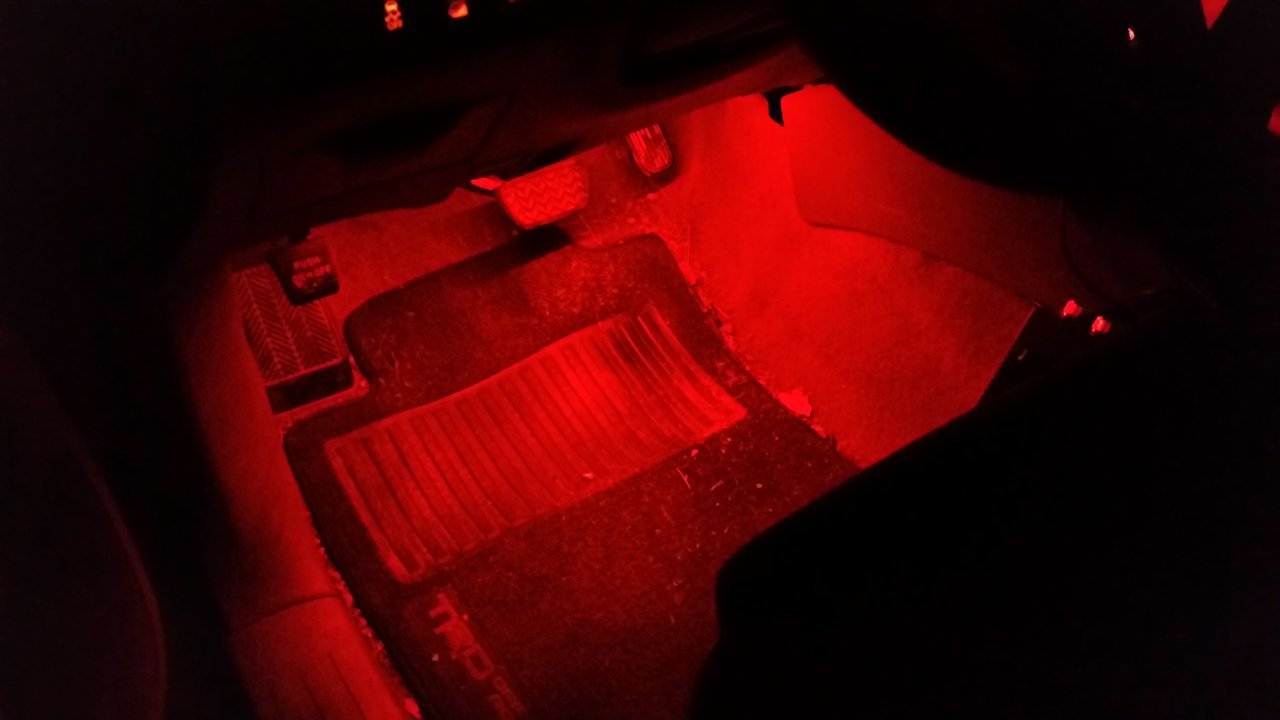

    Wired some red led strips for decorative interior lights. Wired them to come on with the dash lights.
    After several times of looking/analyzing, i have determined that this was the best (really the only) mounting option that makes sense and works for the rear strips. Ran the wires under the carpet to the center console.
