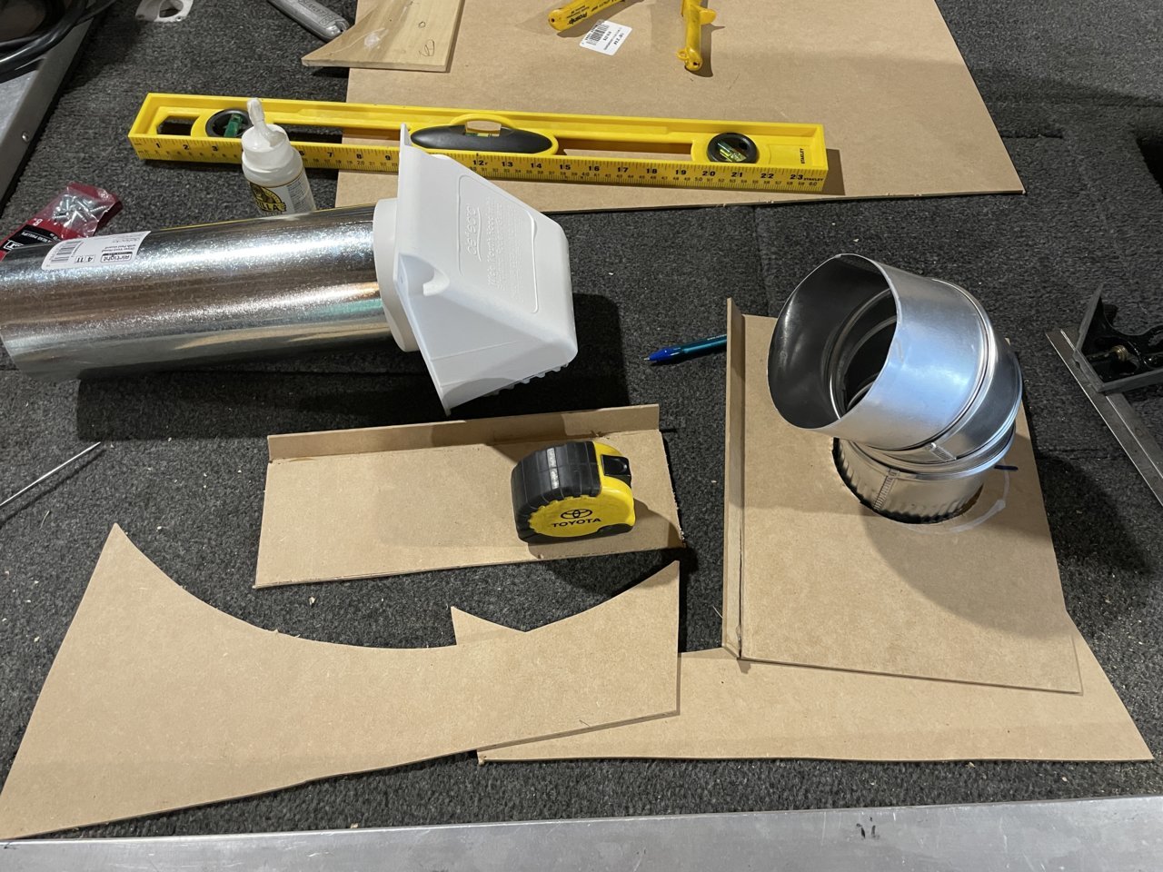

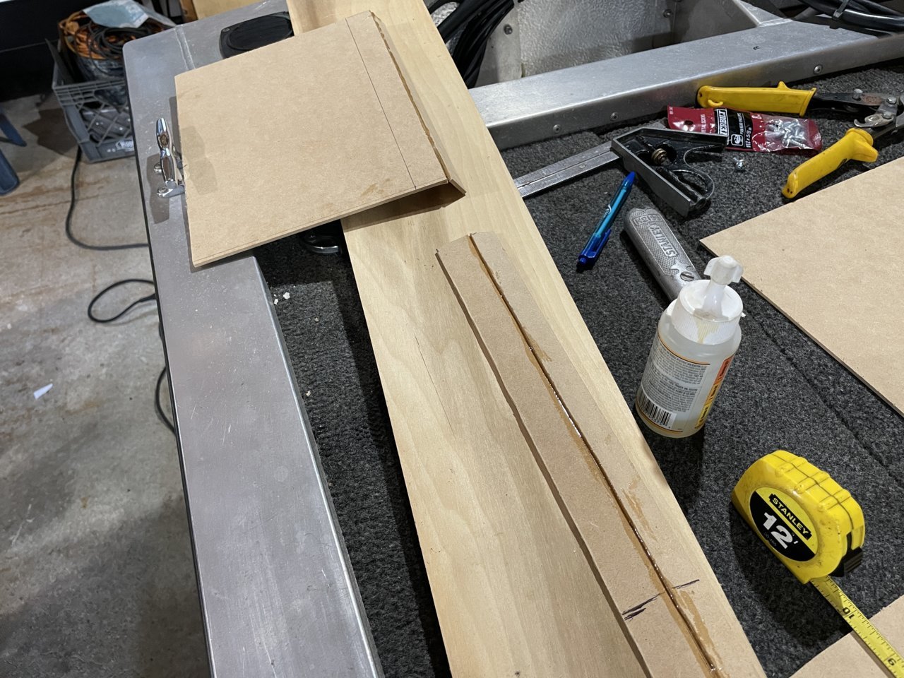

    So a gas water heater…..ok, but why to fancy cut and glue?..:confused:
    Or a fish scoop to pull’em in.

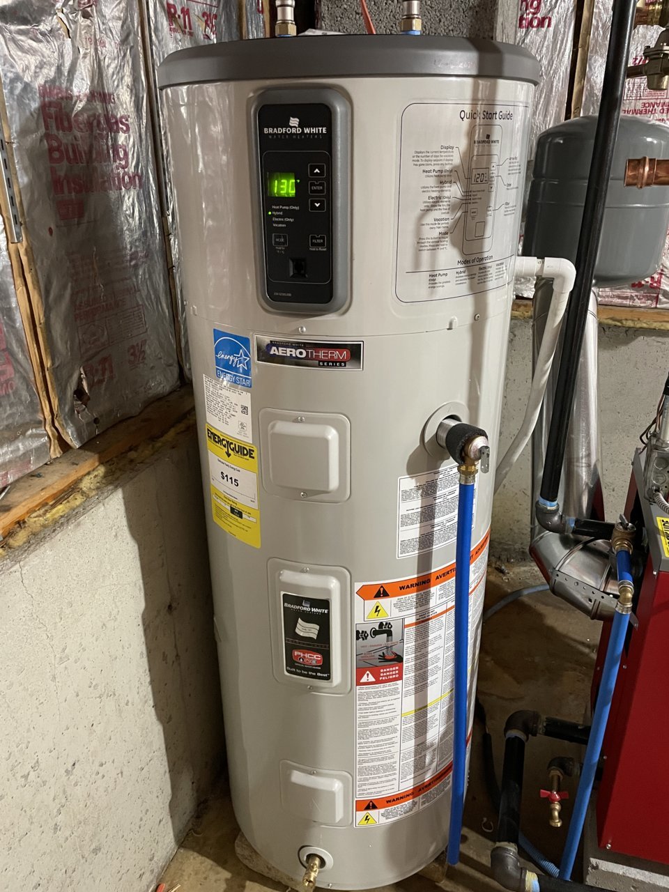

    Now that I look closer, it looks like an electric water heater…. Now I’m more confusedo_O

    Paint booth?

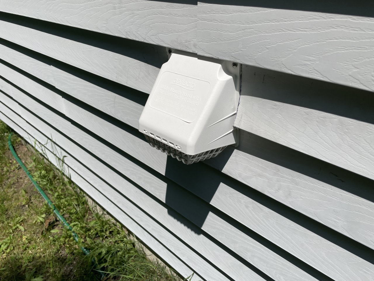

    Sander exhaust? Extra hood for dryer vent? New hood for dryer vent?

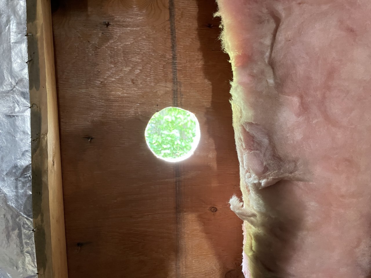

    It’s a hybrid hot water tank.
    The outlet discharge temp is about 40°.
    Cools off the downstairs so the furnace runs all the time in the winter.
    Brings the downstairs temp down about 5°.
    Last week it was 58° downstairs and 84° upstairs.
    I said enough of this.
    I’m making a housing to attach to the tank and duct it to the exhaust port.
    Not going to spend $325 for a kit..
