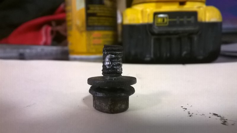

    The arc spots are easy to see not a friggin clue where that bolt could have been or should/shouldn't have been . Threads look gummed up and oily like it was not installed but laying some where in the battery cover maybe ?

    Fixed

    Bad ground Bolt.

    The oil was to get it out. You are there buddy nice job.
    Charging issue. 3 alternators. Car would not charge for 2 min. Battery going dead. Power steering goes out, radio misfires. Lights would pulsate.
    This bolt was loose for the neg. cable. The arcing destroyed the threads. Had to piggy back with another set of grounds. Could not see it or feel it. Went on a different path and found it... Voltage reading we're screwy.......
