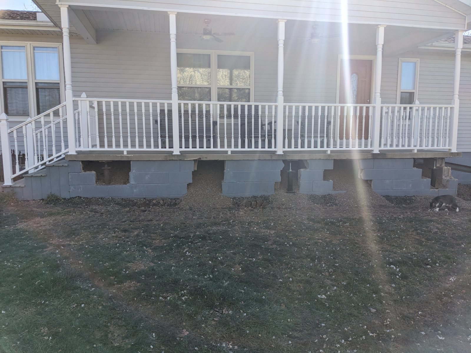

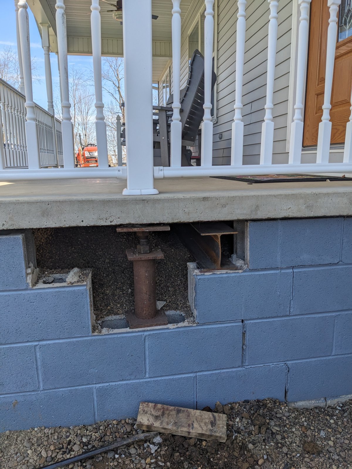

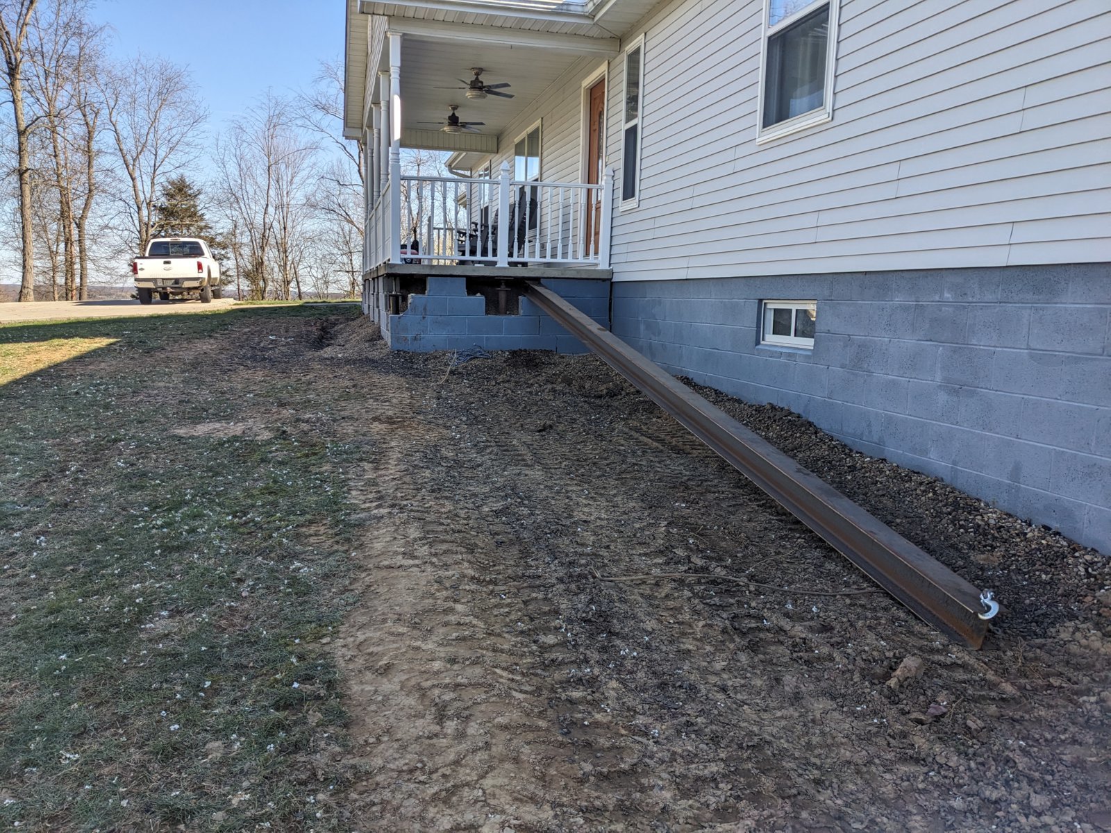

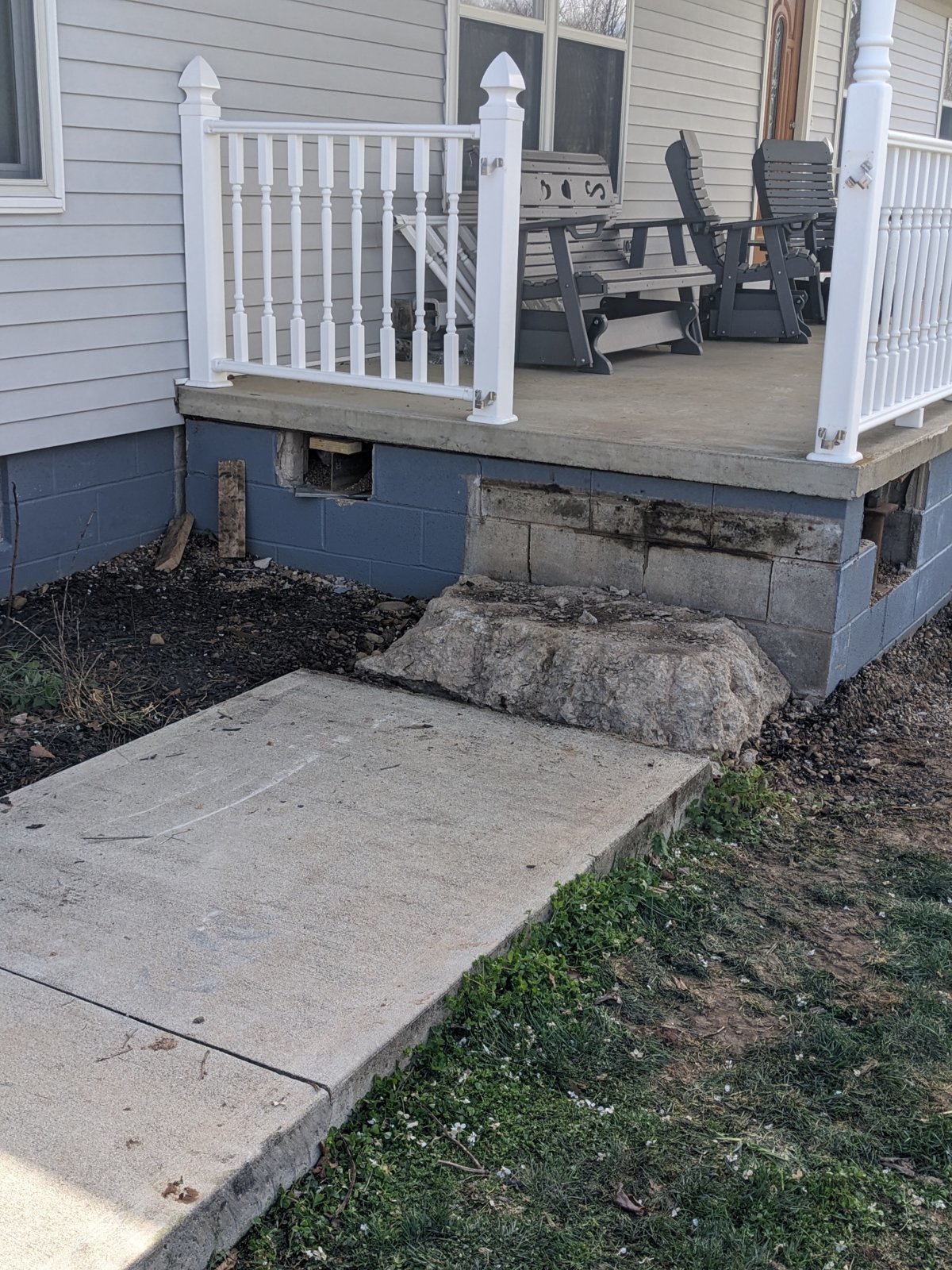

    Ok here's the running start of the porch project...
  10. Mar 22, 2024 at 4:32 PM
    sdk1968
    sdk1968 Well-Known Member
    Apr 15, 2023
    #422563
    300
    03 Taco TRD
    ok now heres the details of whats going on.....
    first my house has a full 9' tall basement & the basement is out of 12" blocks. there are NO lateral support walls. (i didnt build it).... house is 32x65 then 24x24 garage on it.
    then the porch is 4 blocks high above the ground & then they backfilled it with pea gravel & poured concrete on top of it.
    YEP all that weight pushing down & no lateral support meant that it buckled the basement wall on that side. Had a basement conctractor come & i beam it with springs a few years back. its not moved any more. but now my wife wants it fixed "back to factory".
    while all this was going on the porch continued to move/shift & the foundations for it busted as seen in pix.
    fast forward to now: she wants me to save the concrete porch. i poked some holes in the foundation for access & looked it over.
    had a structural engineer in the plant draw me up some load & beams. he went with 6" W15 beams with 5 supports under each. The supports are 4" pipe w/1" bolts as jacks.
    THat will give me adjustability if/when the clay shifts anymore on the porch... just 1 of these would lift the weight of the whole thing (about 12,000lbs was his figure).
    The plan is after ive got the "filling" out from under there & the jacks all in place, going to dig a relief space against the wall of the house the length of the porch & allow that wall to come back out. will then fill it with large D-rock.
    later the porch will get skirted with Vinyl fence panels. This will give easy access, adjustability if needed & drastically reduce the weight. Of course the wife gets all new flower beds out of this deal.
    now if this goes wack? & the concrete breaks? then will tear it all off, trench it & build a new porch deck, but it wont be concrete. i really wanna save this concrete porch.
    think thats the bulk of it. This will not be a quick thing. it took me 2 days to get this far & im toast today. If anyone is interested, will try to do more pix as it goes.
    Edit note: if you look at picture #3 you will see how much it had dropped. ive got it pretty level right now. was about 1.25" on that front corner.
