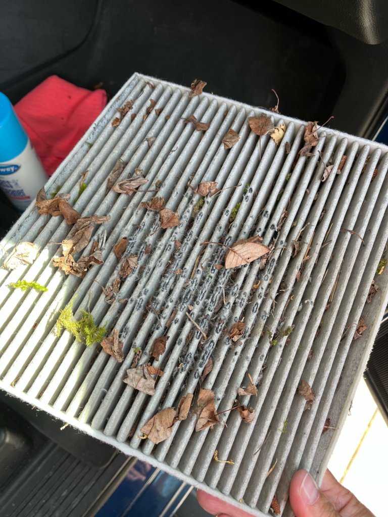

    2016 DC SB

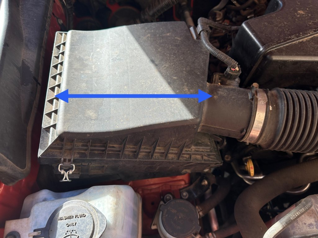

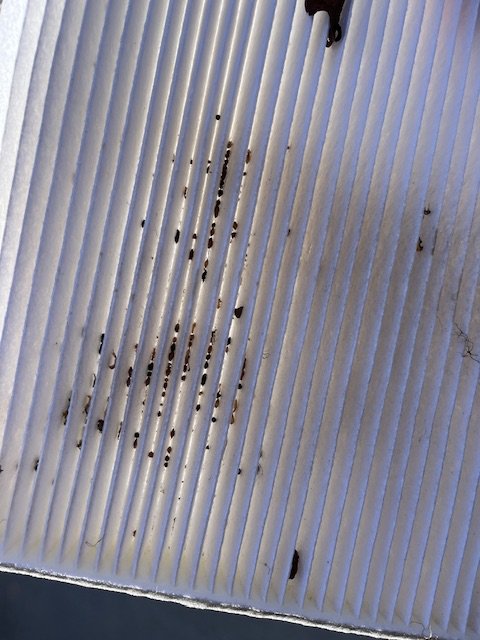

    main (engine?) air filter. (As opposed to the cabin air filter behind the glove box. -well revisit this one in a moment…)
    there’s in and out holes. Which is which? Which way is the air flowing? (Left side is side panel, right is towards the engine)
    where is the intake for this filter? Is there any way to cover it with some type of hardware cloth? You know… to maybe prevent rodent intrusion? o_O
    why? You ask… oooohhh maybe this is the cabin air filter… and the engine filter is the source of the bedding fluff :angrygirl:
  5. Jan 13, 2025 at 1:41 PM
    2ndhandTacoman
    2ndhandTacoman Well-Known Member
    Sep 29, 2020
    #342331
    2,078
    Walter
    Maryland
    '15 Base AC 4x4, 2.7 powerhouse
    3rd gen TRD OR suspension
    Hi Cuffs.
    The air for the intake box would flow left (intake duct at the inner fender area) on the bottom side of the filter to right ( Towards the MAF then throttle body)
    The rodent "fluff" looks like it might be from the hood insulation or interior carpet insulation?
  6. Jan 13, 2025 at 1:54 PM
    Cuffs
    Cuffs Well-Known Member
    Feb 23, 2016
    #179153
    6,225
    Lummi Island & Grand Canyon NP.
    2016 Inferno TRD OR 4x4 DCSB/2021 4R MGM Nightshade

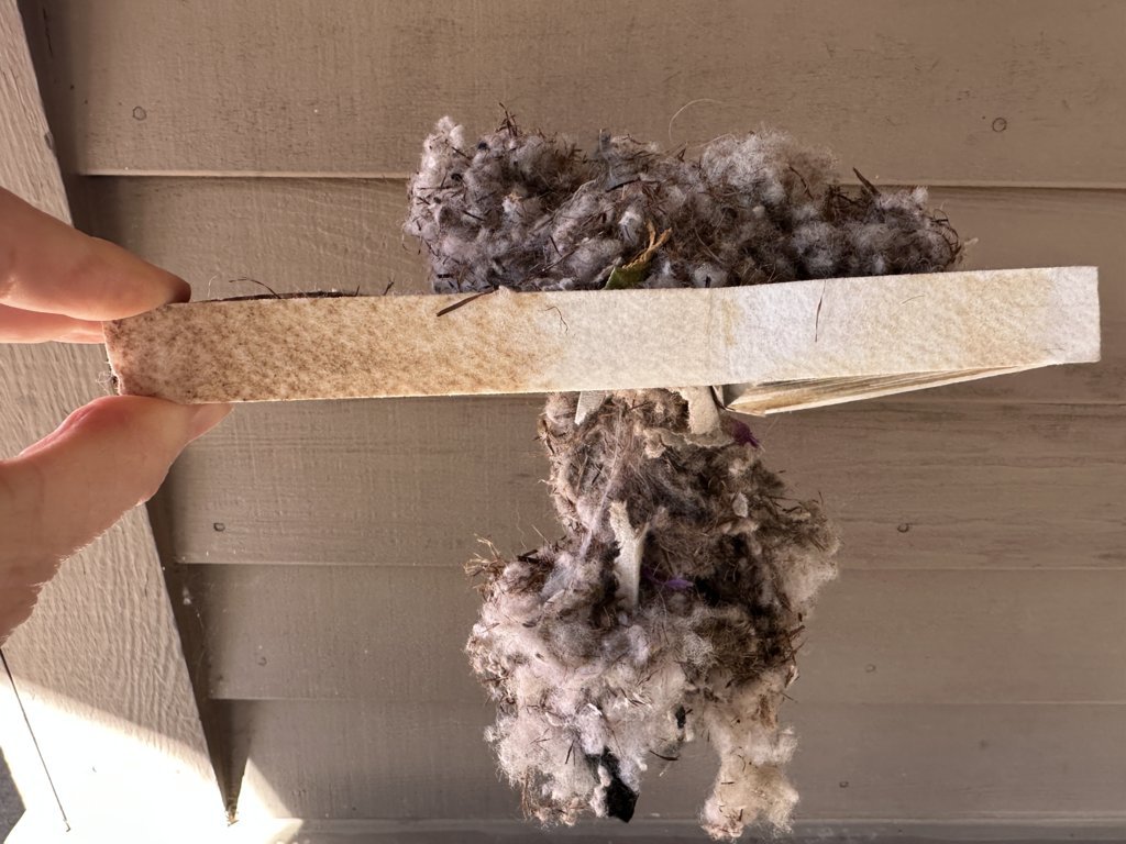

    thank you! Very helpful. I need to try to locate the main place the air comes in?
    The fluff def came from the big air filter (I’ll get a pic of it later) the little fkrs left evidence of their presence in that big air filter box :annoyed:
    hoping to maybe put some sort of hardware cloth over it? I dunno. any ideas?

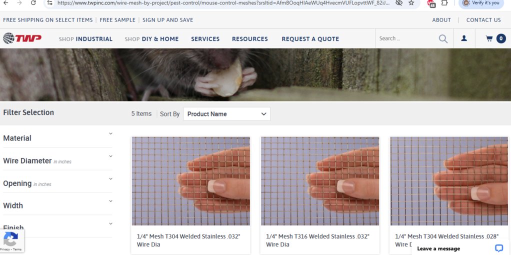

    Maybe sumthin' like this? You could remove the air box housing and see a hole in the side of the fender or wheel well where the intake tube is located, but if you gets some of the critter screen you could just cut out a piece and lay it on the bottom of the airbox then put the filter on top, that way it's removable and you will get some pleasure in knowing that f-n rodent wasted its time and energy climbing up through the air intake tube, only to get blocked by the screen.

  12. Jan 13, 2025 at 2:28 PM
    Cuffs
    Feb 23, 2016
    #179153
    6,225

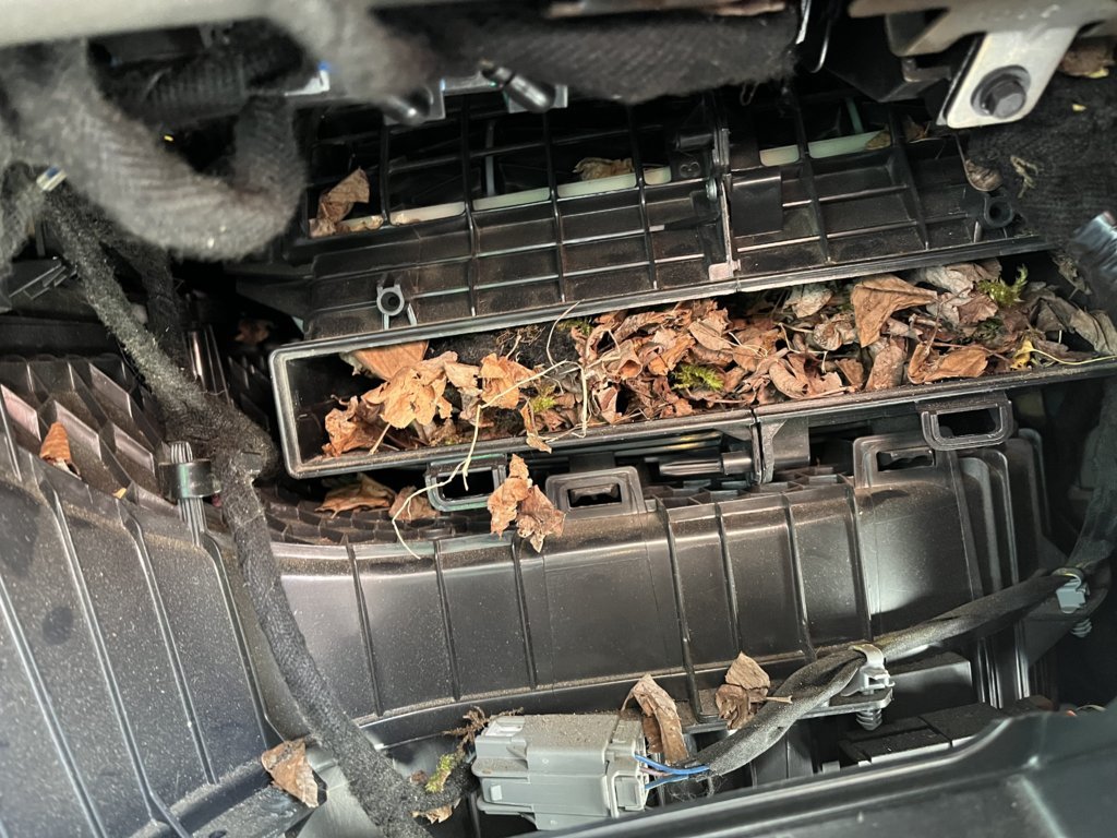

    Ginger (taco) has been taking a rest while we drive the shit out of the cooper (since we’re going to sell it and I don’t like that car anyways…)
    took Ginger to store just to stretch her legs the other day. Turned on heat/fan and heard the rush of detritus blowing around. Shut it off. Drove home cold. Discovered the shit mess today ‍♀️
    sdk1968 and 2ndhandTacoman like this.

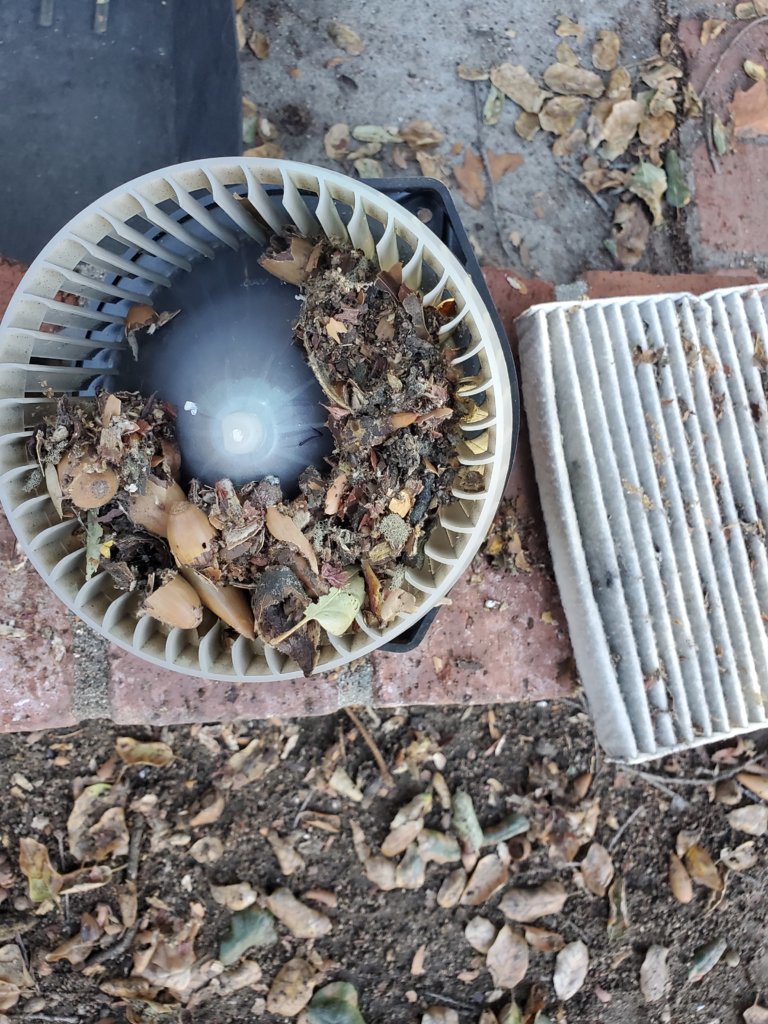

  13. Jan 13, 2025 at 3:19 PM
    CVYota
    CVYota [OP] Damaged Goods
    Sep 13, 2009
    #22686
    9,332
    Andy
    Crescenta Valley
    2011 DCLB V6 4WD
    @Cuffs
    Engine intake won't be the source for the cabin filter, it's under the cowl in the engine bay almost directly above the cabin filter. Ask me how I know.
