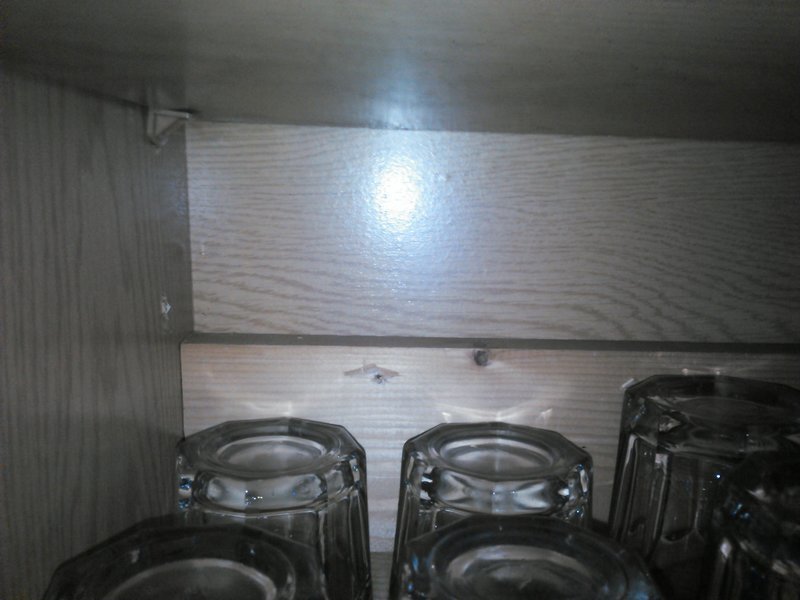

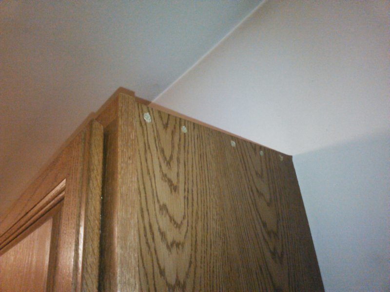

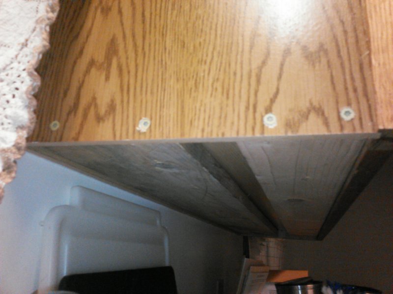

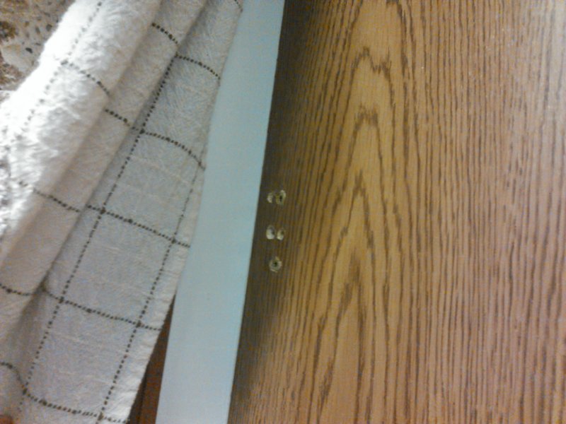

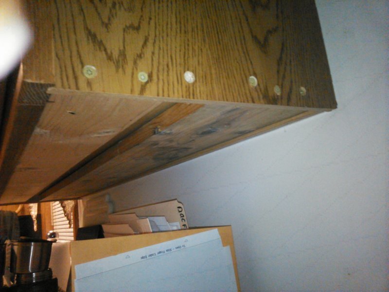

    BottomLeftSupports.jpg BottomRightSupport.jpg InsideMiddleSupport.jpg MiddleSupport.jpg TopRightSupport.jpg Here you go kol,
    I had to do the middle back support the first time when they were about 12 years old the current fixes were a year ago. The top is done same as the bottom basically there is no way to repair the case if the back fails just so you know. The back is only a 1/4 inch and glued and stapled . My opinion on the first failure was after power was out for 2 days in deep cold when the house heated back up I heard a strange thump from the kitchen. For about two days I tried to figure out what it was till I went to put some little used stuff away on the upper shelf found the side had pulled away and the shelf had dropped. The last repair I do not know what happened just found the lower shelf sitting on the glass where one morning the rest of the back had failed.
