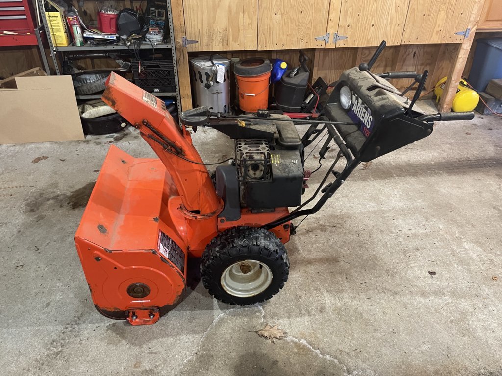

    This was in front of my garage yesterday when I got home.
    I’m sure I’ll get a phone call later …
    They just show up…

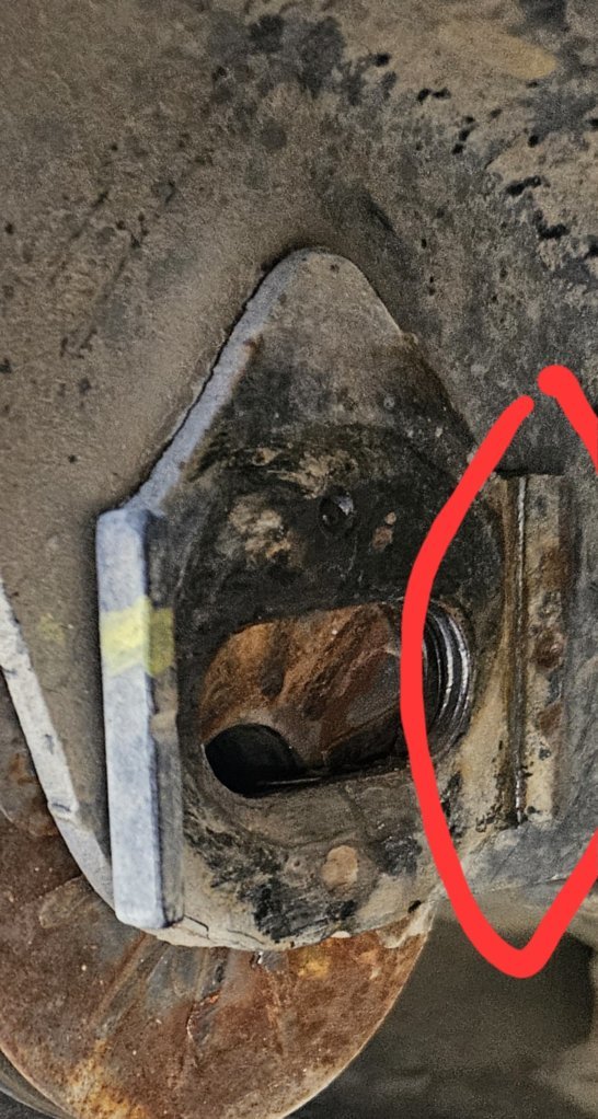

    Best of luck with the repairs, hopefully none of the control arm mounting tabs got bent. Toyota didn't exactly make those areas very stout.

    There’s a snowblower fairy that just leaves snowblowers in your garage?!?!?! How do I get on her good side?

    They did, I am going to try and bend them back and put a tack behind them. Otherwise I have to chisel them off and weld a better one on.

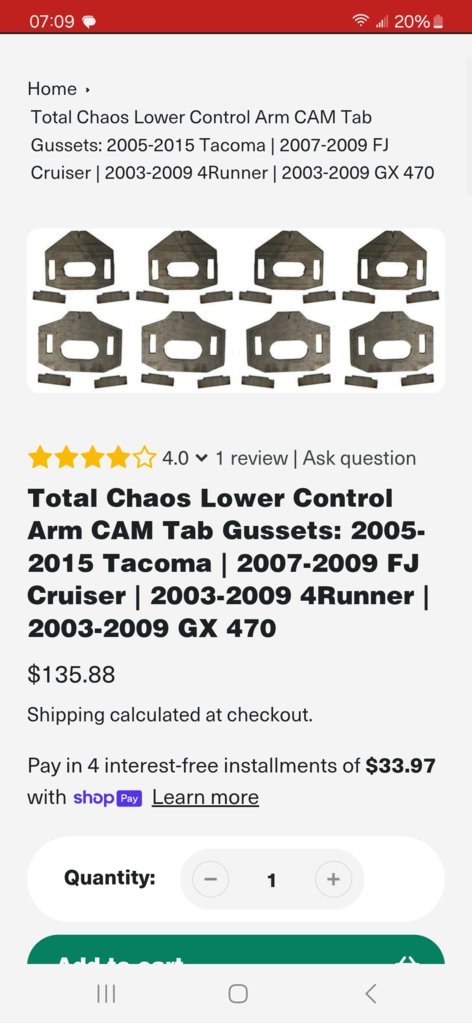

    Not the cheapest option, and lots of welding

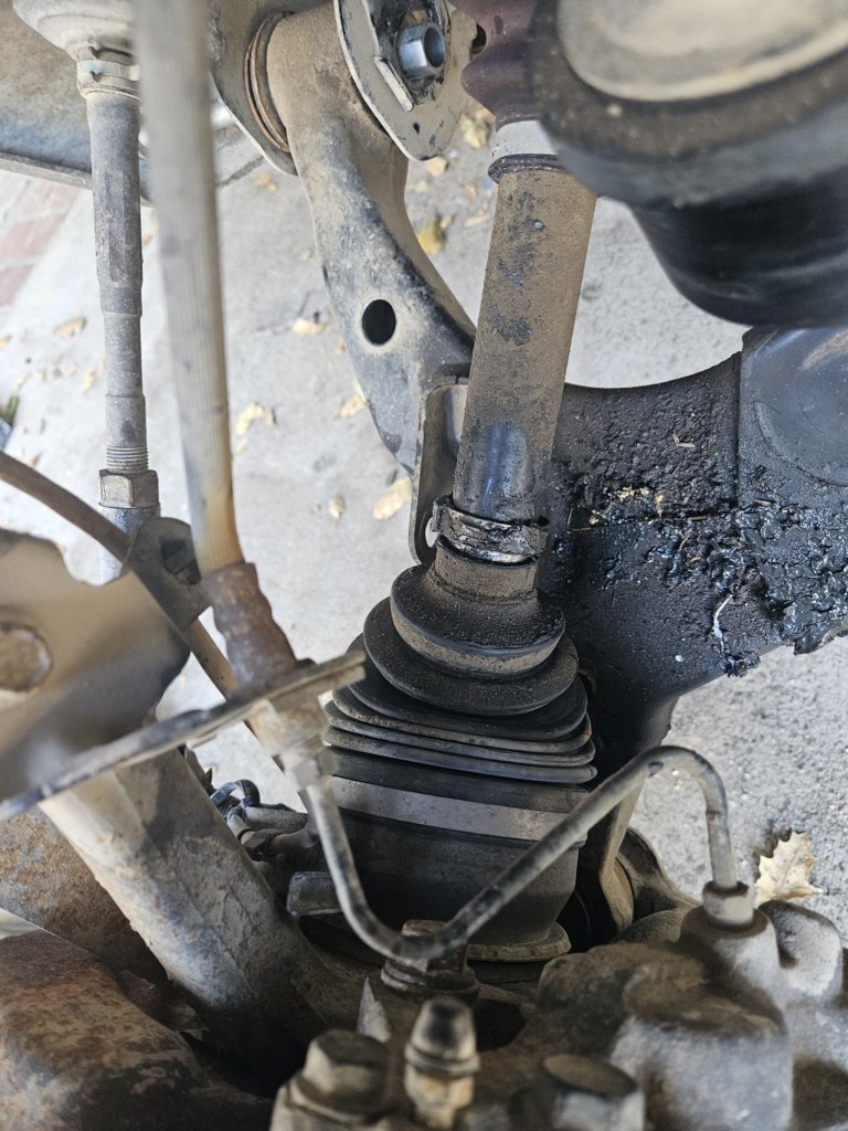

    What kind of UCA do you have?

    A broken one.

    Spc and it's not broken

    Then you should consider the cam tab delete. There's no welding, you just need a large socket and wrench. I think they were 28mm or 1 1/8" and torqued to about 250#. I never had anther issue with my LCAs moving after I put that kit on.

    That, of course, is probably the way I will go.
    I also have a hexagonal cam that will not move, if the front tab stays

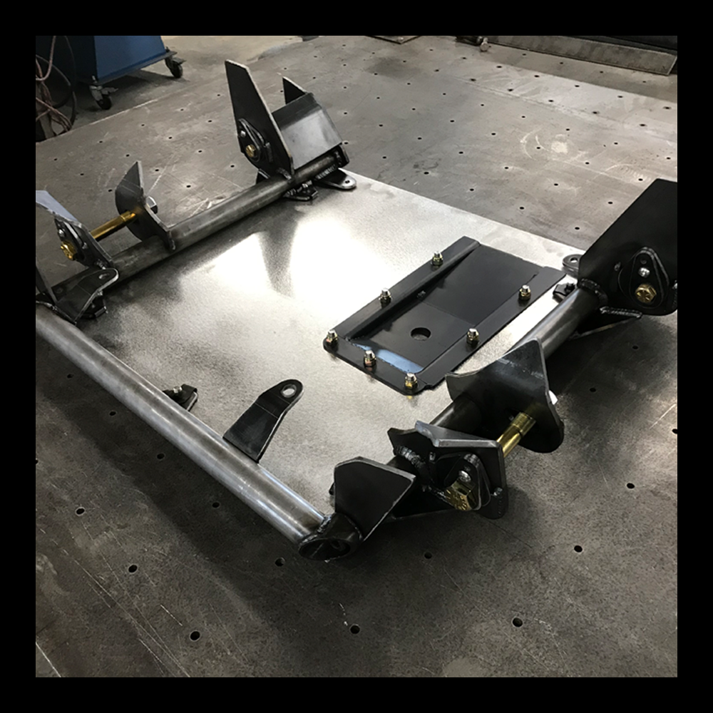

    I've seen a similar product that requires you to remove the stock alignment tab then weld in the 1/4" plate in it's place. The thickness of the plate becomes the new surface that the adjustment cam rides on. Very labor intensive, but it now becomes stronger than the tabs from the frame that they attach to.
    I found it.. Marlin Crawler design.
    Or just go all-in and buy once/cry once.
