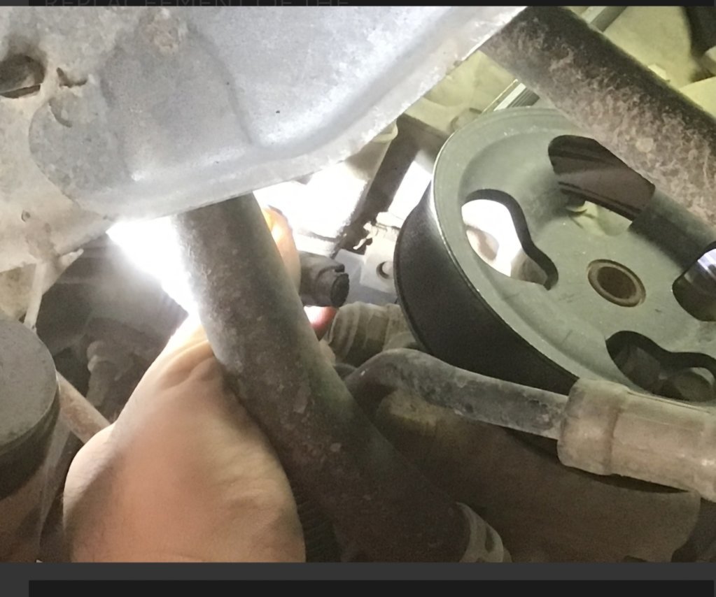

    That's why I removed the skid plate and had them replace the hard lines, that way they get paid for moving the ac compressor since the engineers put it in the way of bolt removal.
    But here , even independent shops have to follow the same rulebook that state how much time a job should take so a s job that should take 2 hours and takes 3, well, you don't get paid for an hour of your work. Nice.
    I am hoping the Toyota shops have a slight bit of integrity left

    Just got a call, the steering pump pressure sensor is broken, so no fluid is being circulated, but they have to replace the whole pump, switch is built in.

    So i have looked up the part and i don't see any connected sensor. I will ask for the old parts

    He sent me this

    This pressure sensor DOES NOT STOP ANY FLUID FROM CIRCULATING.
    It monitors the pressure and increases idle speed when turning the steering wheel.
    Not sure of your symptoms….
