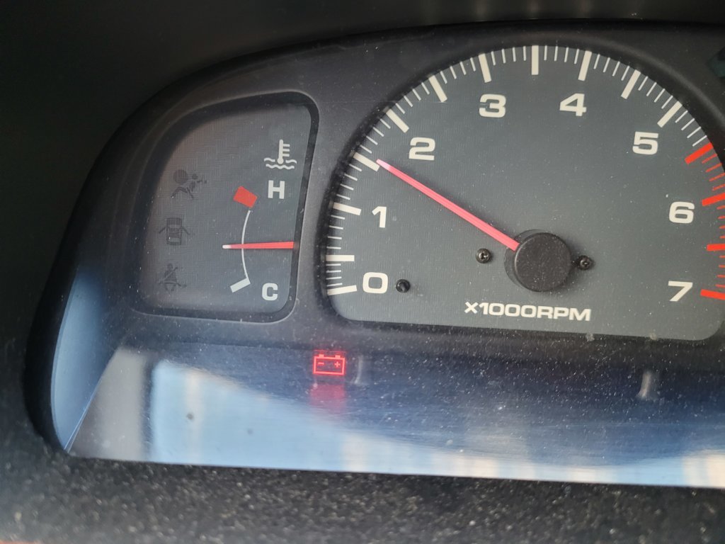

    The old crusty T4R gave me a hard time on Friday night while driving to meet some friends for some free outdoor music.
    The trusty T4R has never left me stranded and at least this happened while the sun was still up but I had to hightail it home (30 miles) with just drawing power from the battery, so no AC. After Vatozone tested the alternator and claimed it to be good, I wasn't believing them as I only got 12V at the battery with the engine running. The ALT fuses were fine and the harness connections didn't show any voltage drop when tested, so I took my chances on a new ALT. 1 hr later this morning after picking up the new one from the parts store, the light went off immediately after strating the engine. So much for the parts stores being able to diagnose an issue.
