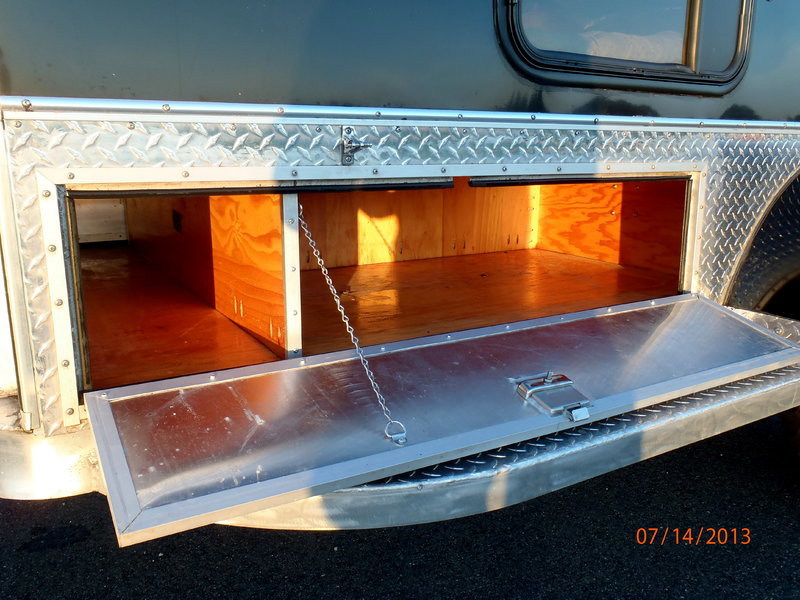

    Ours was designed to fit the tow rig.......then we got a different tow rig....
    On the plus size it's not much wider than the Taco.
    Here is the basement layout. It's basically a plywood H rib to give the support needed for the bed above. The full width section toward the front holds the EZ UP. It's accessible from either side. The center section is divided by side. One side holds tables, chairs and other accessories; the other side holds awnings, dishwash bins, etc. The back wall is the divider for the water tank.
    The basement adds and extra foot to the total height of the trailer. That's important when you have a normal size garage door....

    I'm thinking about the COG but my basement is going to be a pre built truckbed storage box probably just accessible from the passenger side, but it has 2 drawers. And it's pretty heavy so that lowers COG alot.

    That's why the water tank is exactly between the wheels. It's as low as it can get and over the axle so it has as little effect on the COG and tongue weight as possible.
    As far as the COG goes almost everything above the basement is air, everything heavy is floor level of the trailer or only slightly above. It's not tippy in the least off camber.
